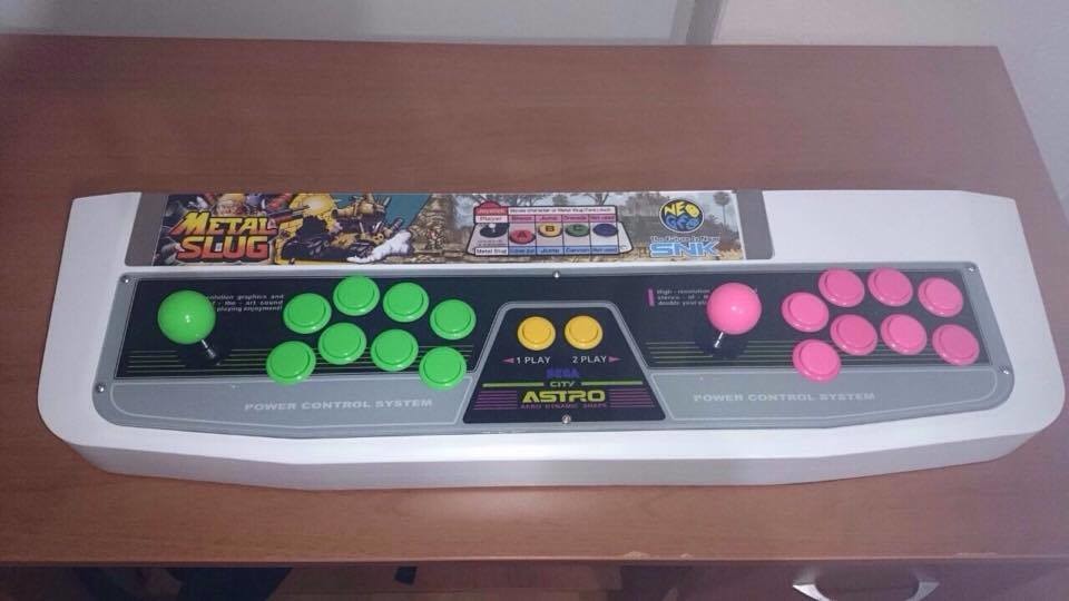

Hello Guys.
Firstly, if the topic is not right place ,sorry for that. Admins can fix that.

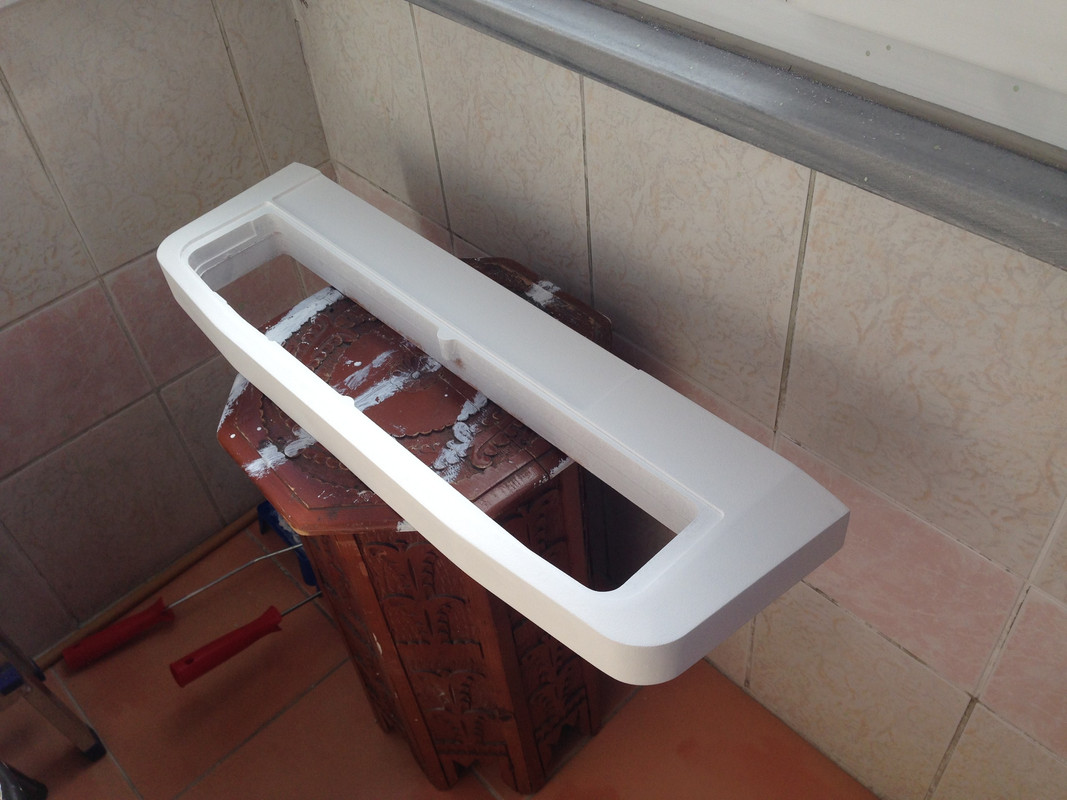

I decided to make Sega Astro City control Panel. Actually it is Sega Virtua Stick HSS-0130.
You can see the pictures that how i can make it step by step.
I have 5 more Arcade Stick. If someone wanna buy it please inform me by PM.

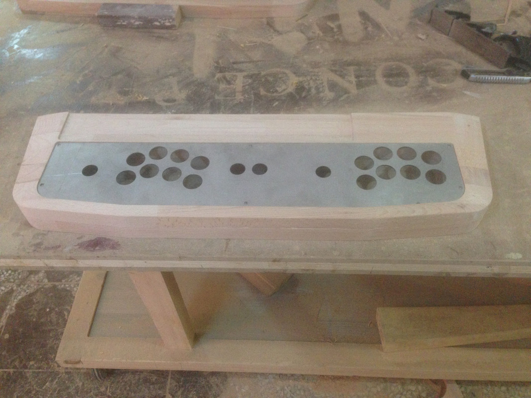

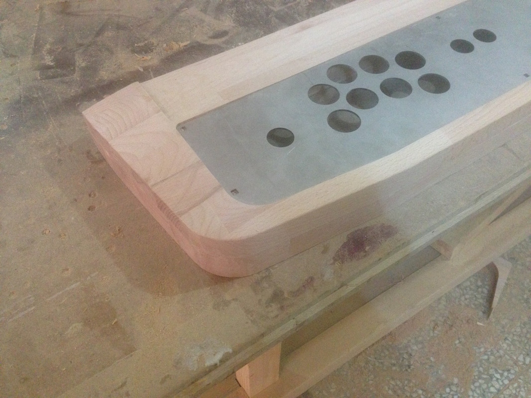

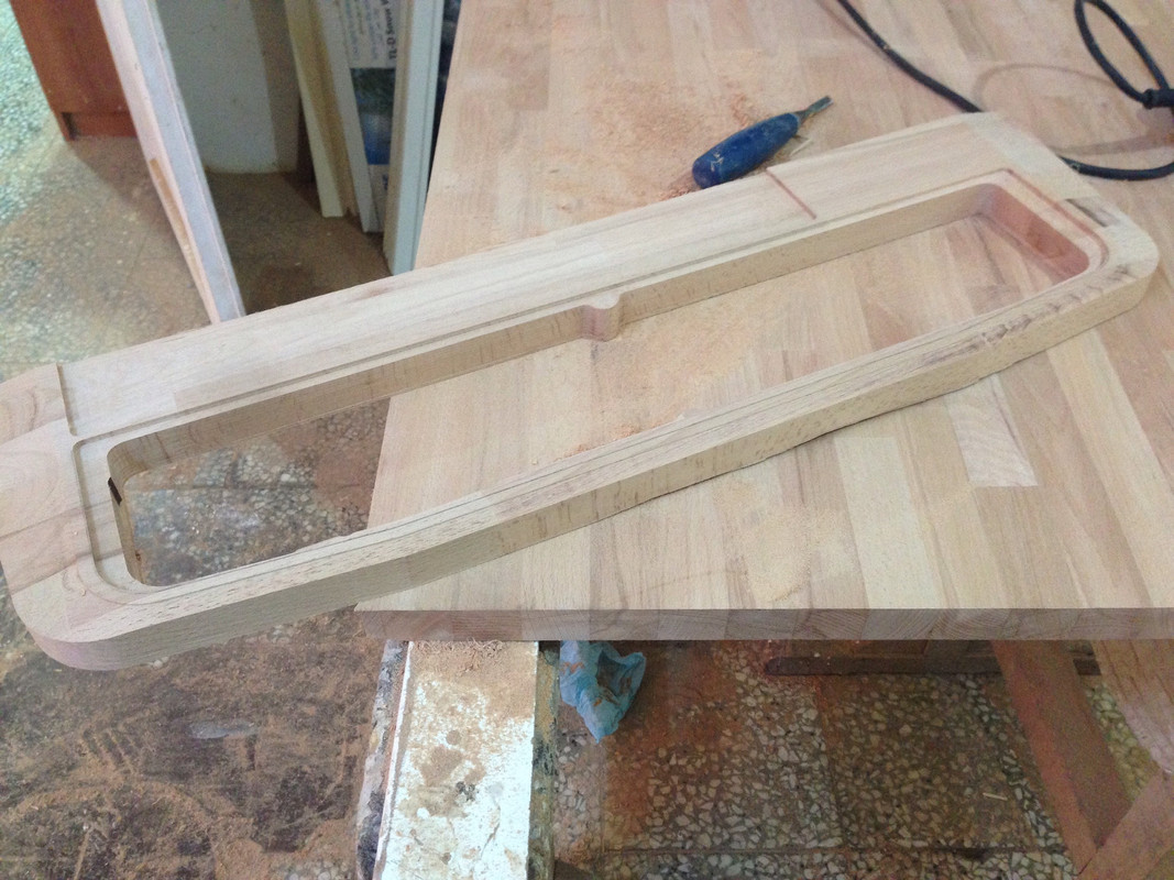

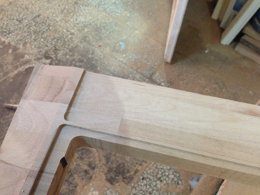

1- Wooden parts.
I made it by Massif Panel Wood

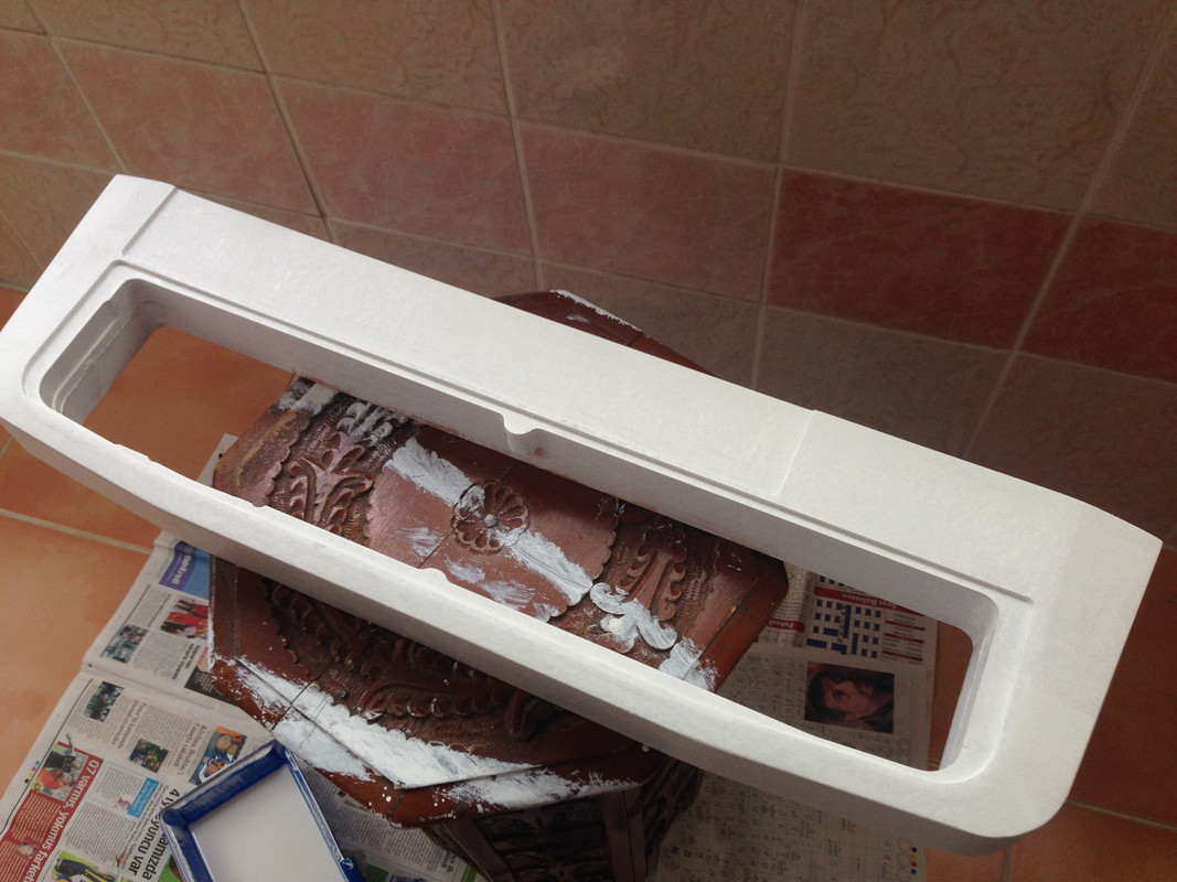

2- Prepare for painting.

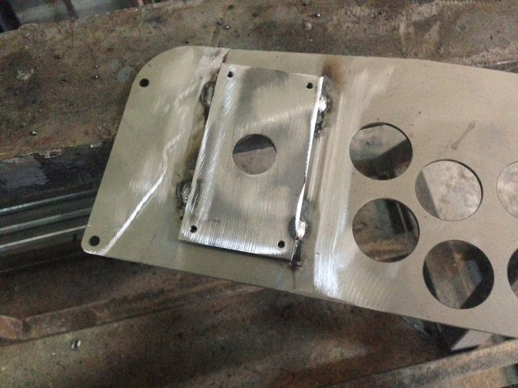

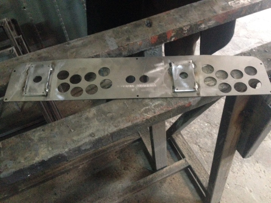

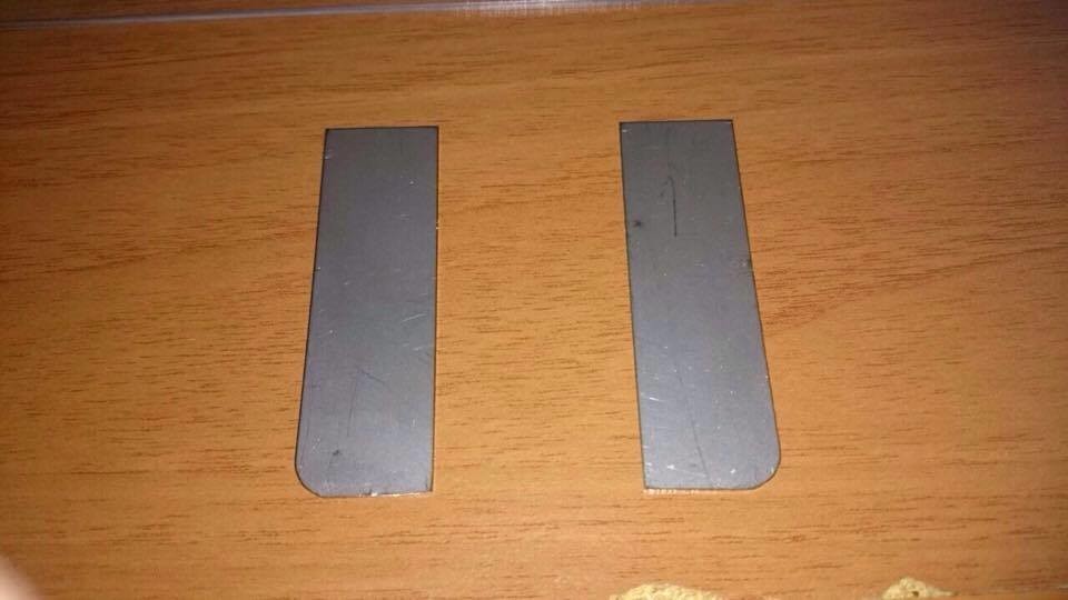

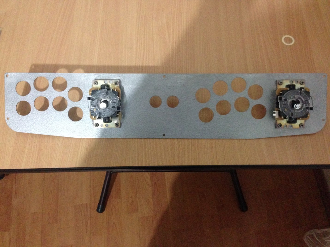

3- Metal parts.

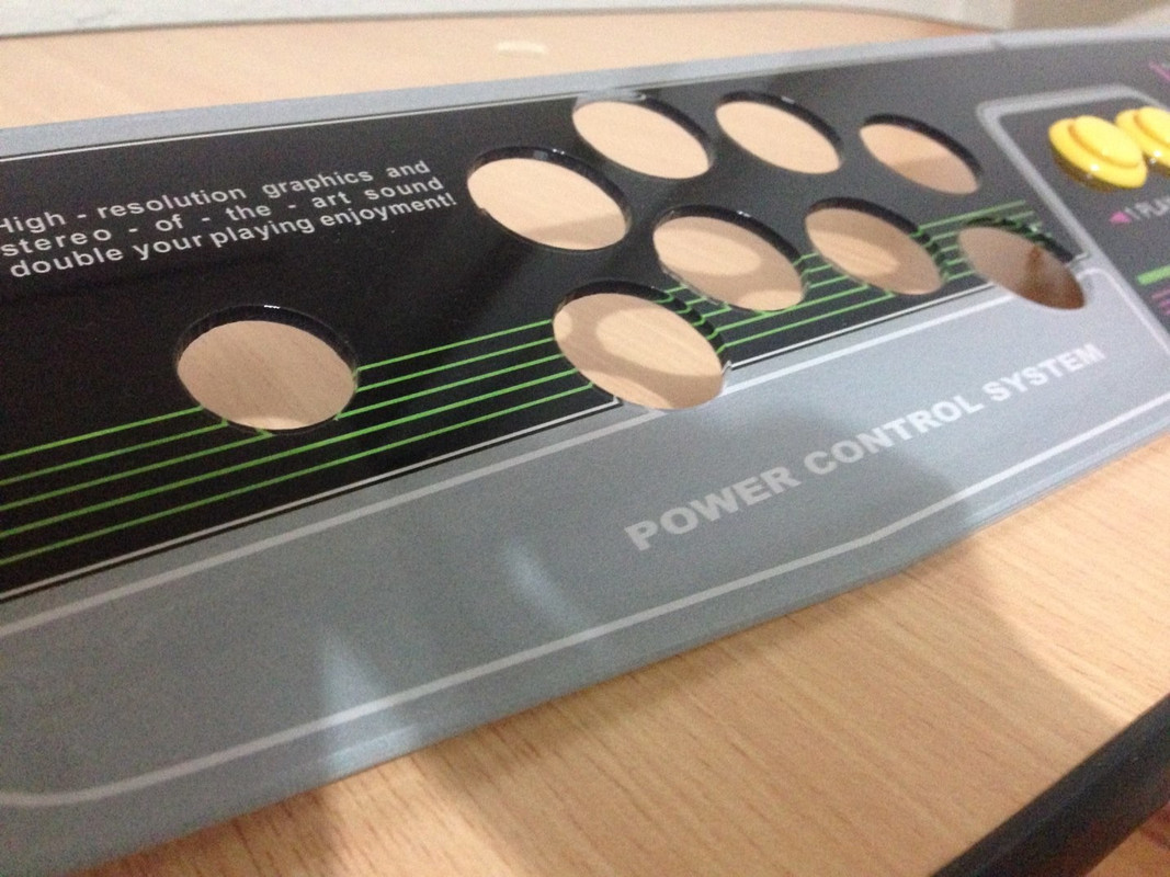

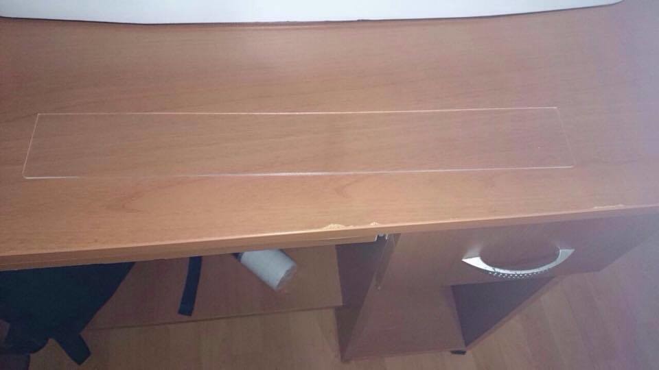

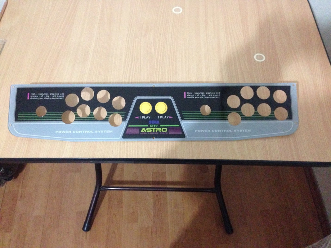

4- Plexi Glass with UV print.

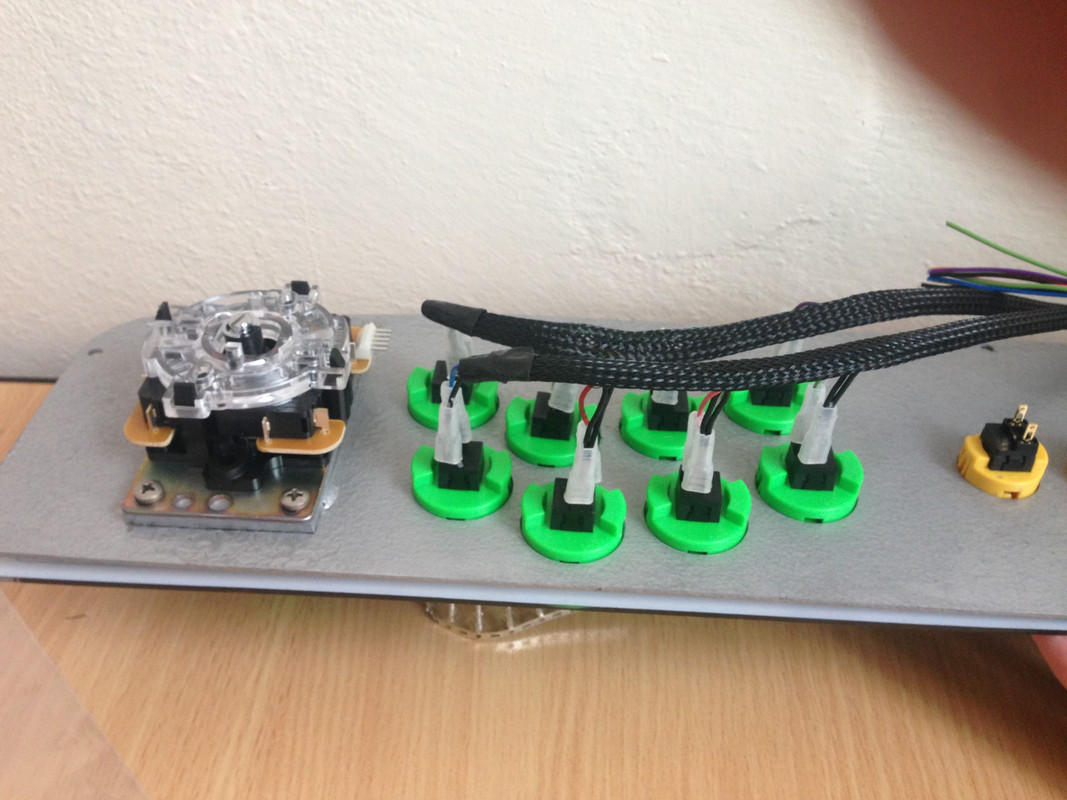

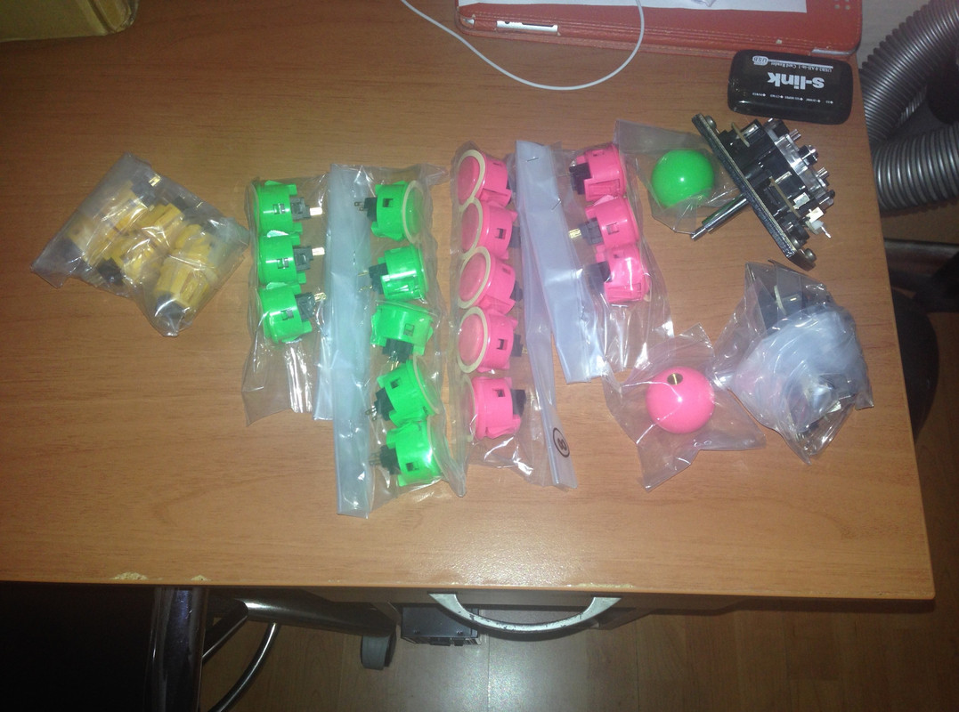

5- Buttons From Japan ( Sanwa Denshi )

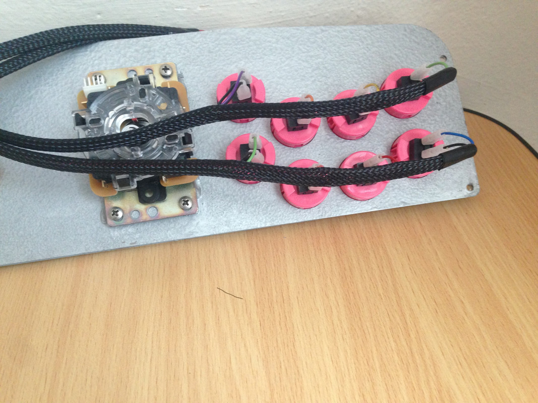

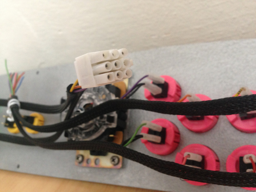

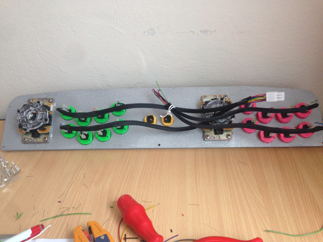

6- Wiring.

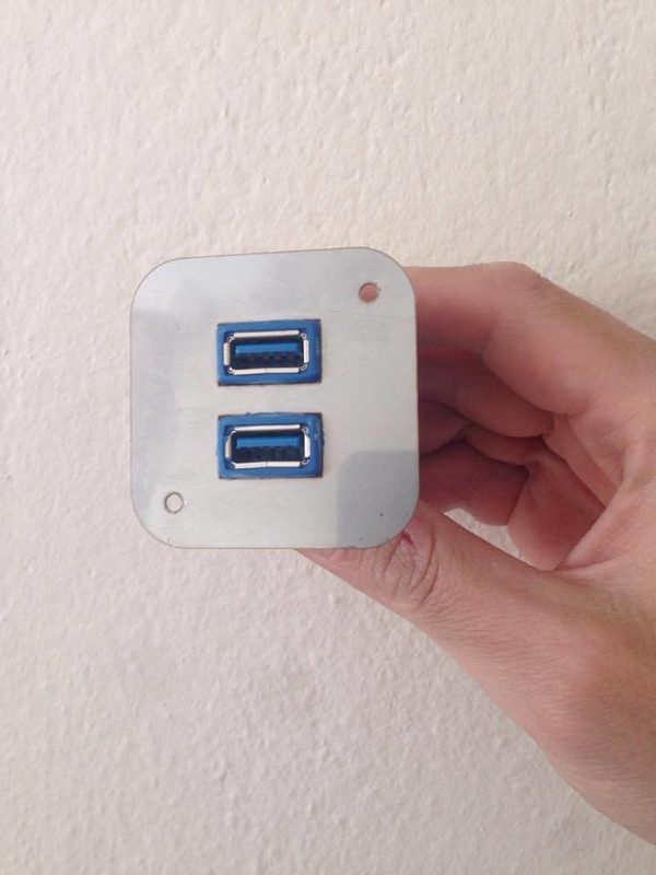

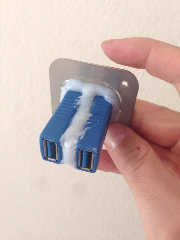

7- USB output.
8- Last Touches :)

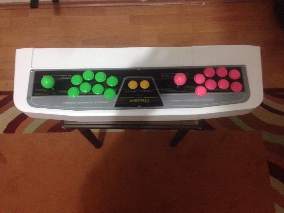

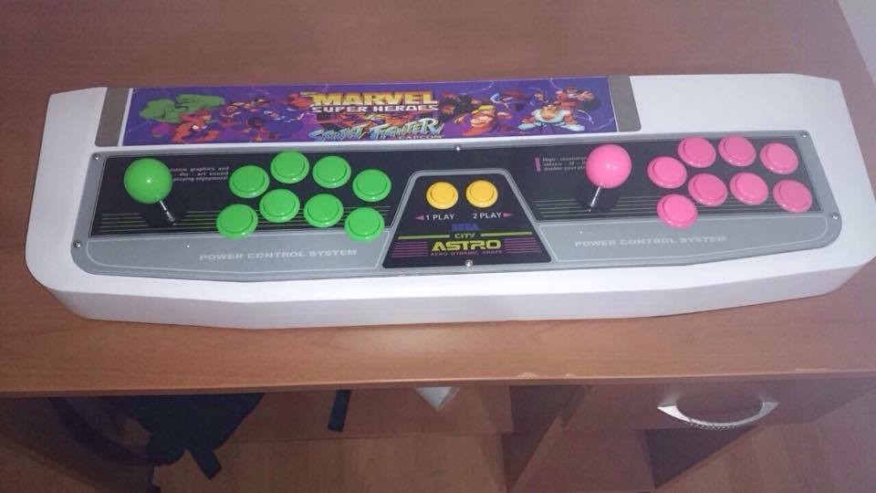

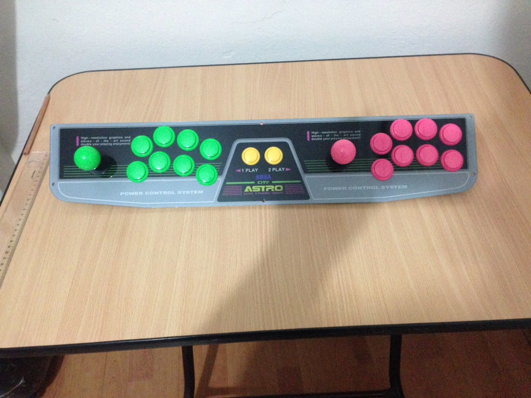

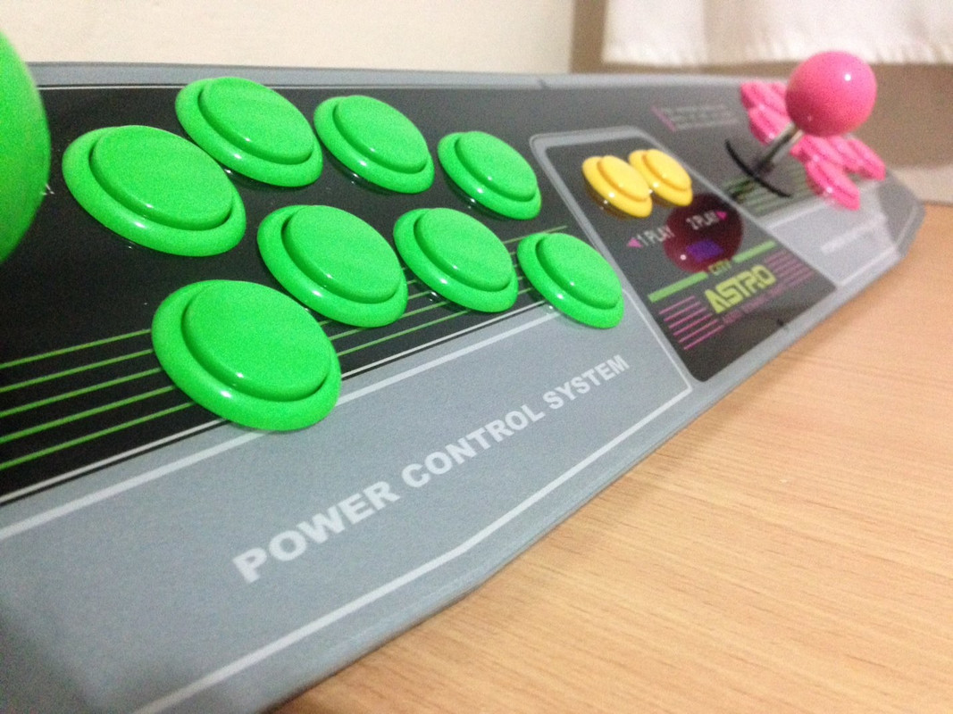

And Final
Just gorgeous. I'm envious of anyone that buys one off of you.

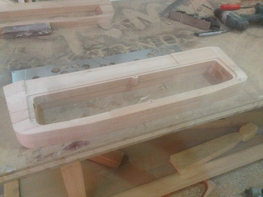

Did you create a template for the metal panel? Or did you take your time cutting the area for the panel to lay flush with the wood? Please advise.
I create the template for the metal and plexi glass.
Actually, ı made it First before i started the project.

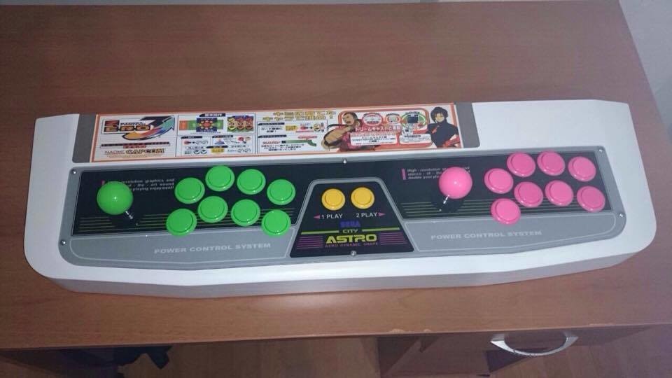

Where did you get the art? I have a HSS-0130 modded for Supergun use and could use a replacement for the AM2 art it came with. I'd like to put in SSF2X.
Hello.
I just google it and find it.
you can search it like this.
" sega naomi instruction cards" or metal slug instruction cards etc.
Here you go. Its for Sf3 Naomi Edition
The New Challengers one is pretty cool! I may use that one.
