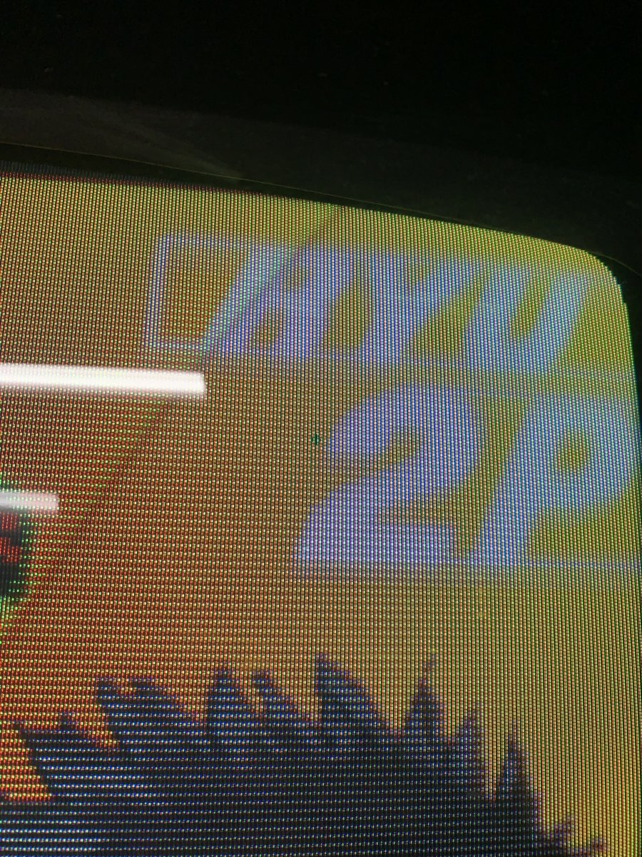

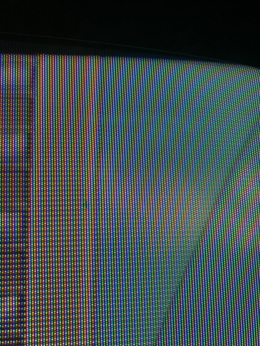

I never noticed it until today but I have a dead pixel/phosphor on my CRT. Is this the Cps3 or my monitor or some magnetic interference(I moved it to another room)?
did you follow up my 2nd suggestion?It’s the monitor. I connected another game to it and it still shows. What are my options? Cap kit? New tube? New chassis?
That will narrow down the answer to your question.also try adjusting the V or H position and see if the dot moves. that will rule out the tube.
Ok I changed the vertical position and the dead spot stayed there. I removed the glass and unfortunately it was not just a piece of dust. Any ideas? Just have to live with it?did you follow up my 2nd suggestion?
based on this, it's your tube, most likely what nem was stating above. AFAIK nothing you can really do about it.Ok I changed the vertical position and the dead spot stayed there. I removed the glass and unfortunately it was not just a piece of dust. Any ideas? Just have to live with it?
