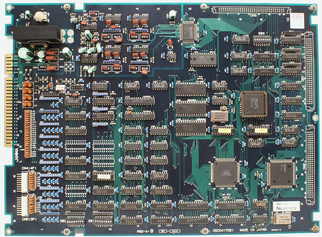

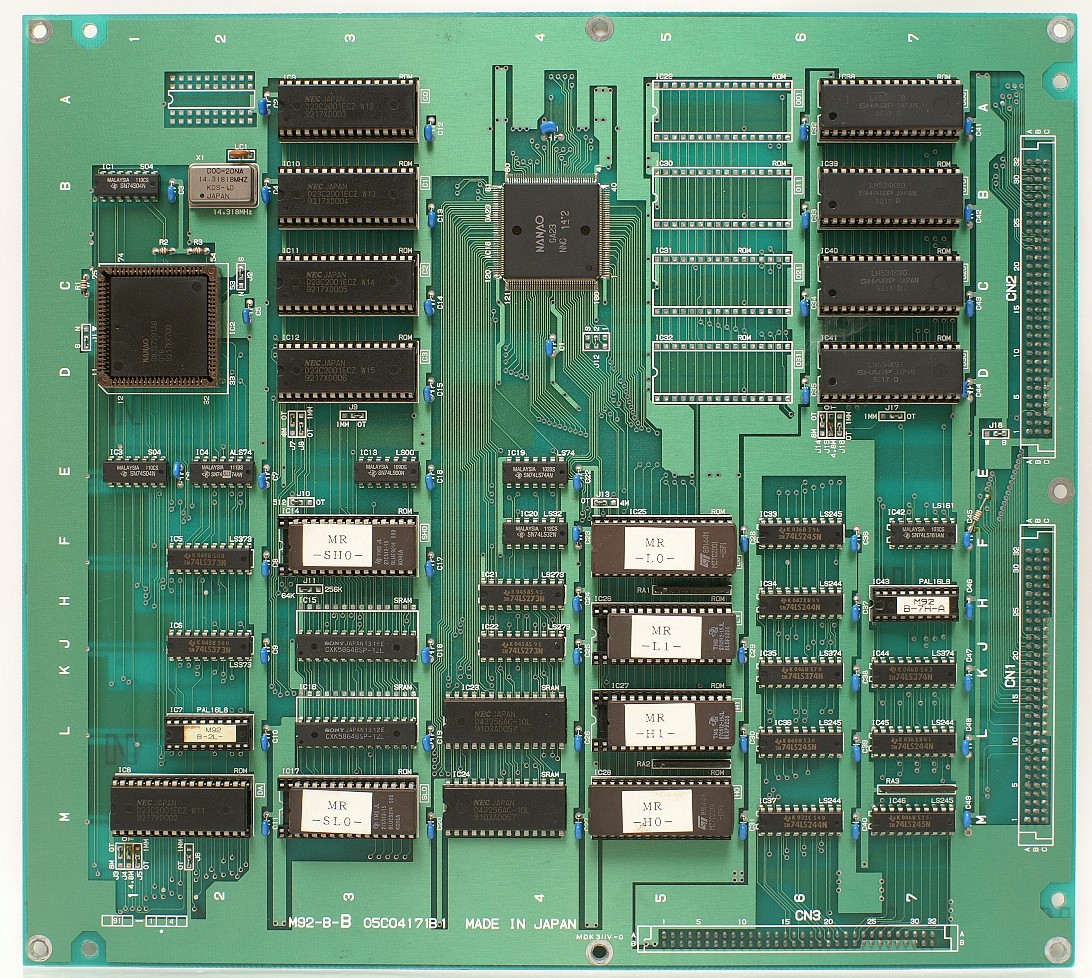

Hey, nah i just wanted to trade this PCB and got immediately attacked by people saying its a bootleg and i have to state that
PCB was bought @MAK Japan around 2004Korean, and the sound section doesn't have leaky caps.
Then there's a whole discussion about the korea vs japan import things and 'korean brands first' that i don't wanna get into.
Do you want to play the game, or do you want to collect pcb's from Japan with labels and no duct tape?
It is a licenced Korean M92. They are not boot but manufactured cheaply for the Asian market. This is mostly seen on Ninja baseball batman. The sound section on Korean versions has cheaper components than the Japanese counterparts. Its possible to repopulate the components to match that off the Japanese version. But I wouldn't call it a boot. It's an official licenced product. You will find that with the missing components in the sound section, there will be slight difference in sound quality with some sound missing altogether. The mixing is off too. Also rather than using decoupling capacitors for each ic, they used one for a group of them.. works but a bit cheap. After repopulating and changing for the better components, its functionally equivalent to the japanese counterpart.

Also lack of jamma key is not an abosulute indicator that it is a bootleg. Look at Rabio Lebus by Video system. That doesnt have a Jamma key.
It's an exception to the rule, I didn't know Rabio Lepus didn't have a JAMMA key.Also lack of jamma key is not an abosulute indicator that it is a bootleg. Look at Rabio Lebus by Video system. That doesnt have a Jamma key.
