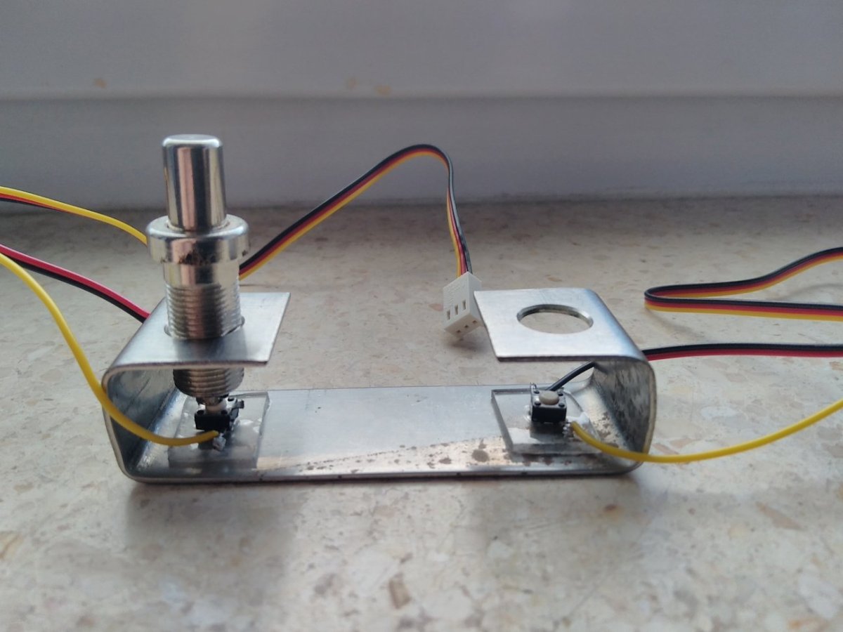

The result can be seen below, with the 2 switches already glued in via double sided tape:
Unfortunately due to the double sided tape being so thick, the switches ended up being too close to the screw tips and were constantly pressed down.
So better use less thick tape and it should fit perfectly! But as I didnt want to redo the finnicky work of getting the switches to the correct positions again, I just used the eject screw washers on top:
Now there was enough space between the tip and the switch.
All that was left to do is connect the Switches to the GP2040s, as can be seen here:
And thats it - feel free to copy this solution for your own Naomi cab
