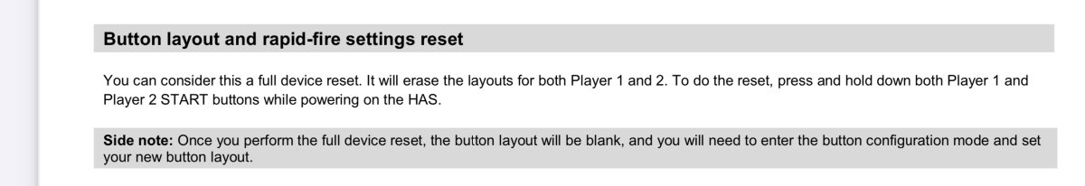

Super weird. I have tried doing a full reset by holding down player 1 and player 2 start buttons while powering on the HAS. No luck. I'm thinking something must be wrong with this HAS. It's a v4.1

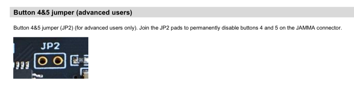

Is JP2 on your HAS connected? If so, disconnect it.

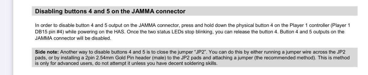

The HAS manual also says that Buttons 4 & 5 will be disabled in software if you hold down Button 4 while turning the HAS on. The manual doesn’t say how to re-enable the button if they’ve been disabled this way, so you could try repeating that step or you could try a Full Reset by holding down Start on both P1 and P2 while powering on the HAS.

So....I did the full reset last night. No luck. I tried to repeat the disable D button process. No luck. Never messed with JP2...but that got me to really start looking around the HAS...and on the underside of this HAS v4.1 there's a series of dip switches....for buttons 4-6...and they were all off....so I flipped button 4 on and now I have D on my MVS board. I probably missed that in the manual somewhere.
