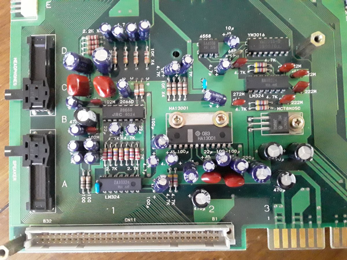

My 6 slot has scratchy audio and it seems like the right speaker has no audio on at least one game. I want to say I plugged in a JAMMA harness backwards once or twice and powered it on and that damaged the audio circuit or YAMAHA sound chip. Does anyone know if these should be the audio capacitors or if I should replace a couple of them?
