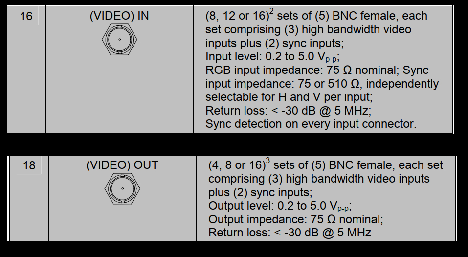

It is a Crestron CEN-RGBHV12X8, but I was about to say I assume the principle is the same, as I had indeed assumed, but then I found this:
Does this mean it outputs 75 ohm and not TTL?

However, this is all irrelevant if the matrix switch outputs 75 ohm as per above, which leads to the second question:

The second culprit, I thought, is not having the resistor on the sync line as you noted to me, but as of now, that depends on whether it already outputs 75 ohm or not as per the manual.
tl;dr and point: Assuming all I've said is correct, if the switch outputs 75 ohm I would need only a new bnc-to-scart cable, and if it doesn't I would need the same but with a 470 ohm resistor on the sync line and a bnc-to-bnc with such resistor for switch-to-pvm as you noted.
