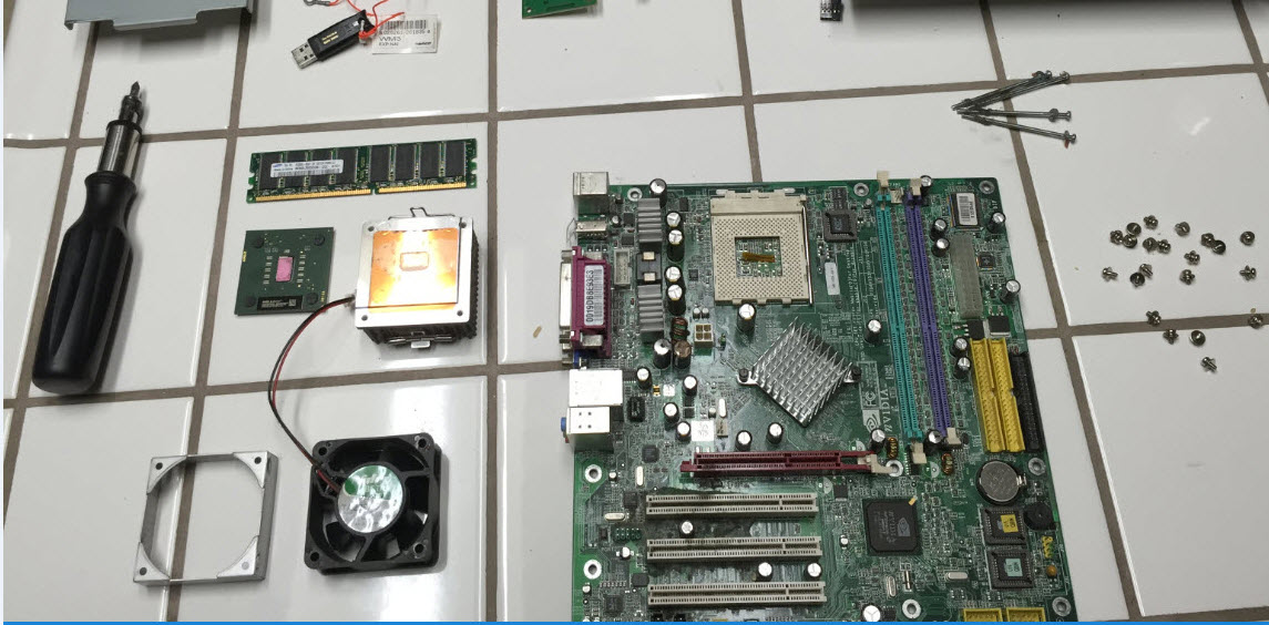

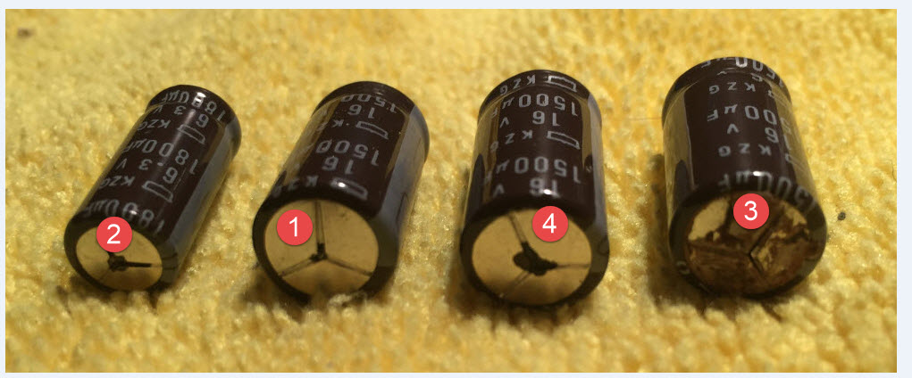

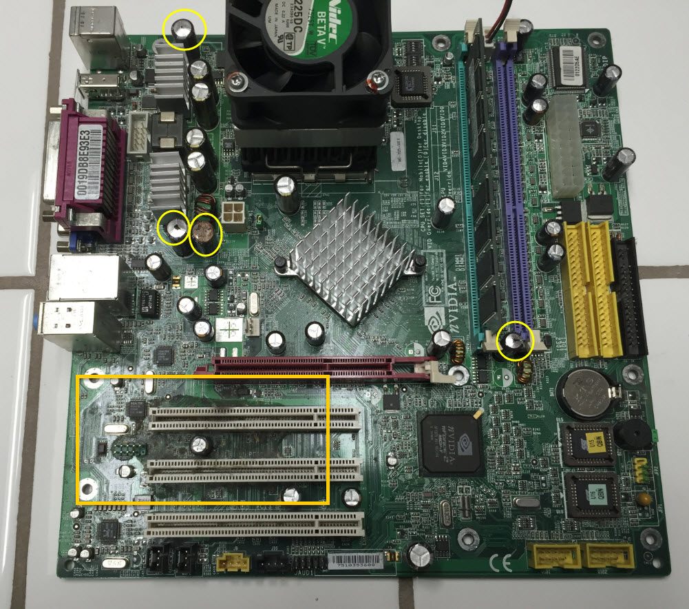

Did a complete teardown of the motherboard to assess the PC:

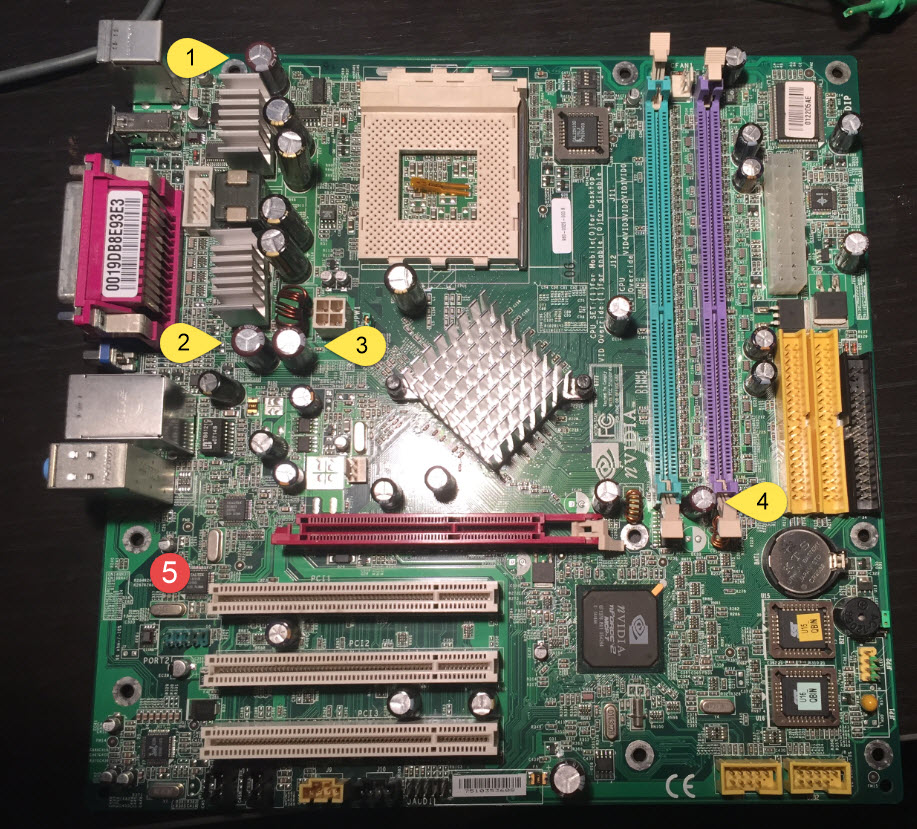

The only obvious damage was #3 and #5 on the motherboard.
#3 - Popped capacitor

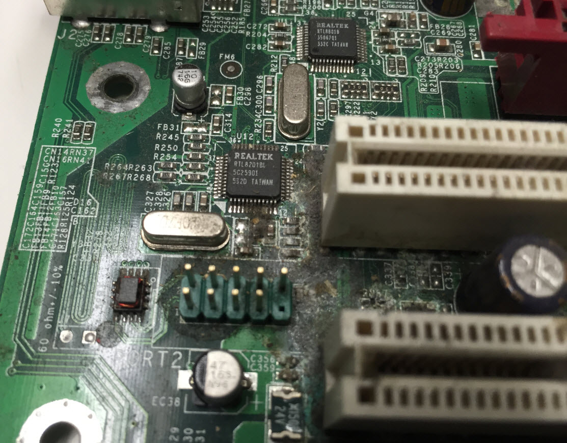

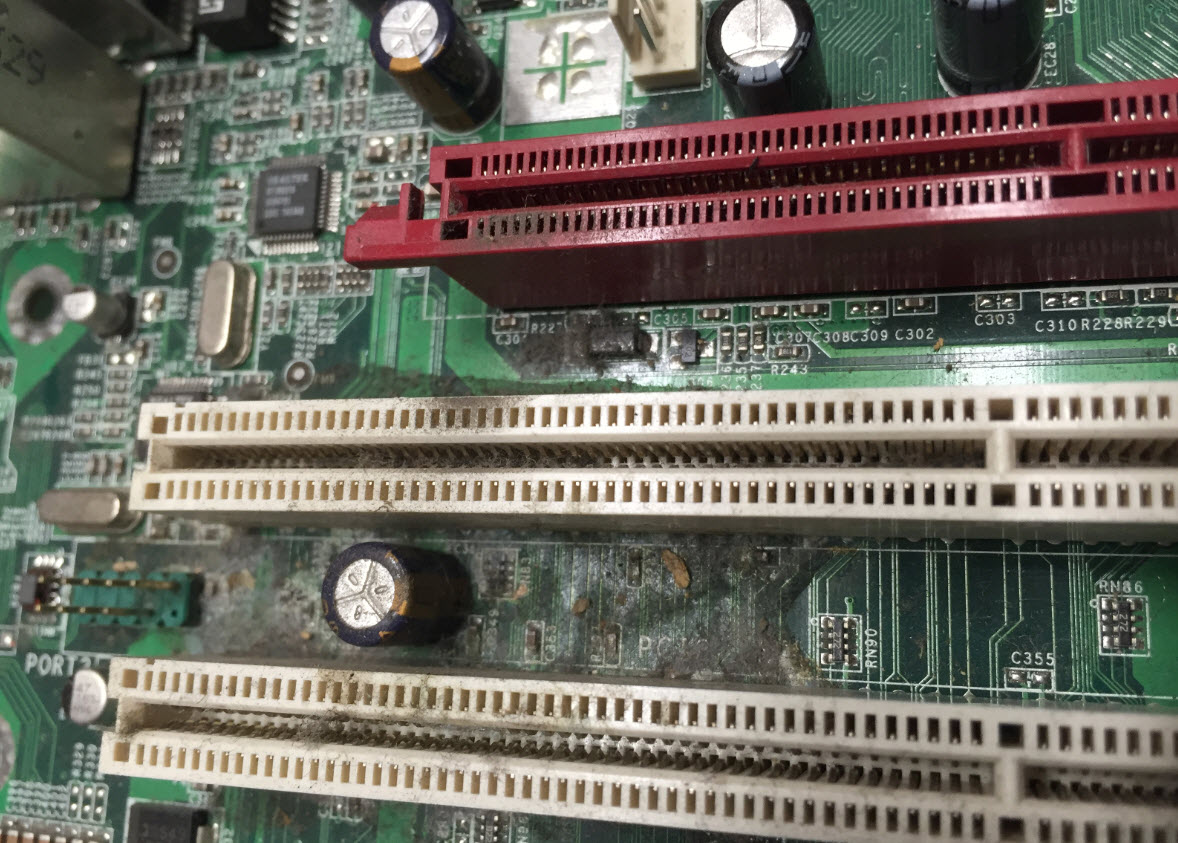

#5 - Some sort of dried up spill
#1, #2, #4 - Caps with a black mark on them. Not sure if these were marked by someone or if the cap produced these, i don't know of any caps that produce these so I'm just assuming.

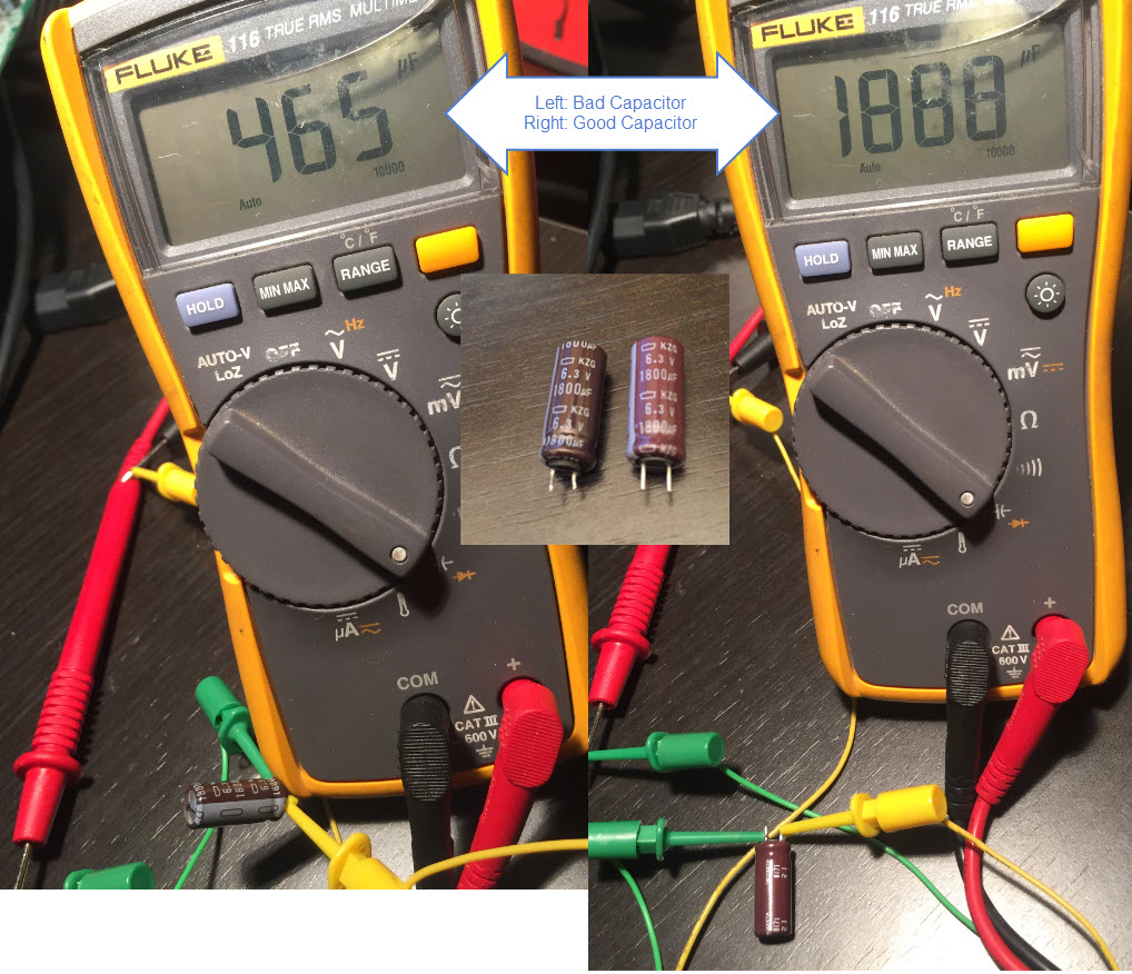

Bad Capacitor Reading #4 / Good Capacitor Reading #4 Replacement (I didn't take pics of #1, #2, #3 so you get the idea):

All the parts:
All cleaned up:

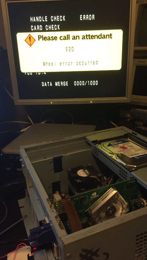

Plugged in without Hard Drive/Dongle Combo:

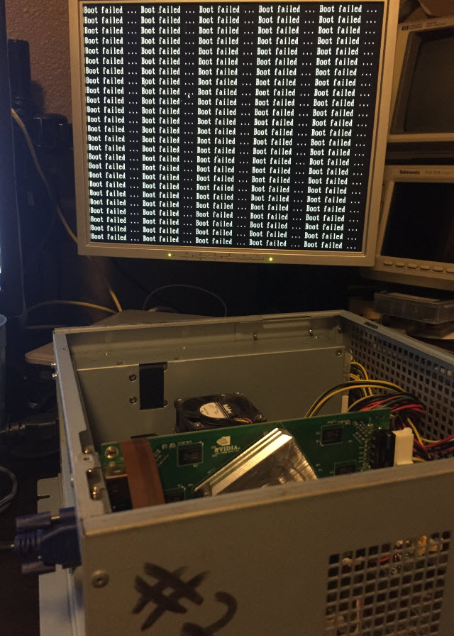

Plugged in with Hard Drive/Dongle Combo:
It works, I'm happy.
