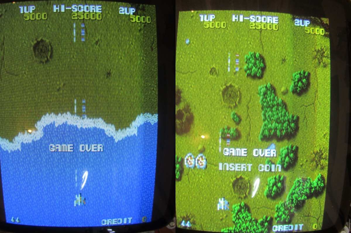

Terra Cresta pcb shows blocky sprites with the normal pixel size doubled up, but the sprites remain the same size, see player's ship sprite in the following screenshot.

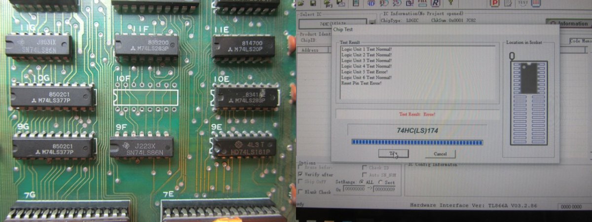

Checking several ICs with a logic probe.
First suspect IC found is a 74LS174 at 10F(b). (note: (b) stands for bottom board)
Pin 13(in) has activity, but pin 12(out) is permamently low.
Desoldering the ic and testing shows a fault.

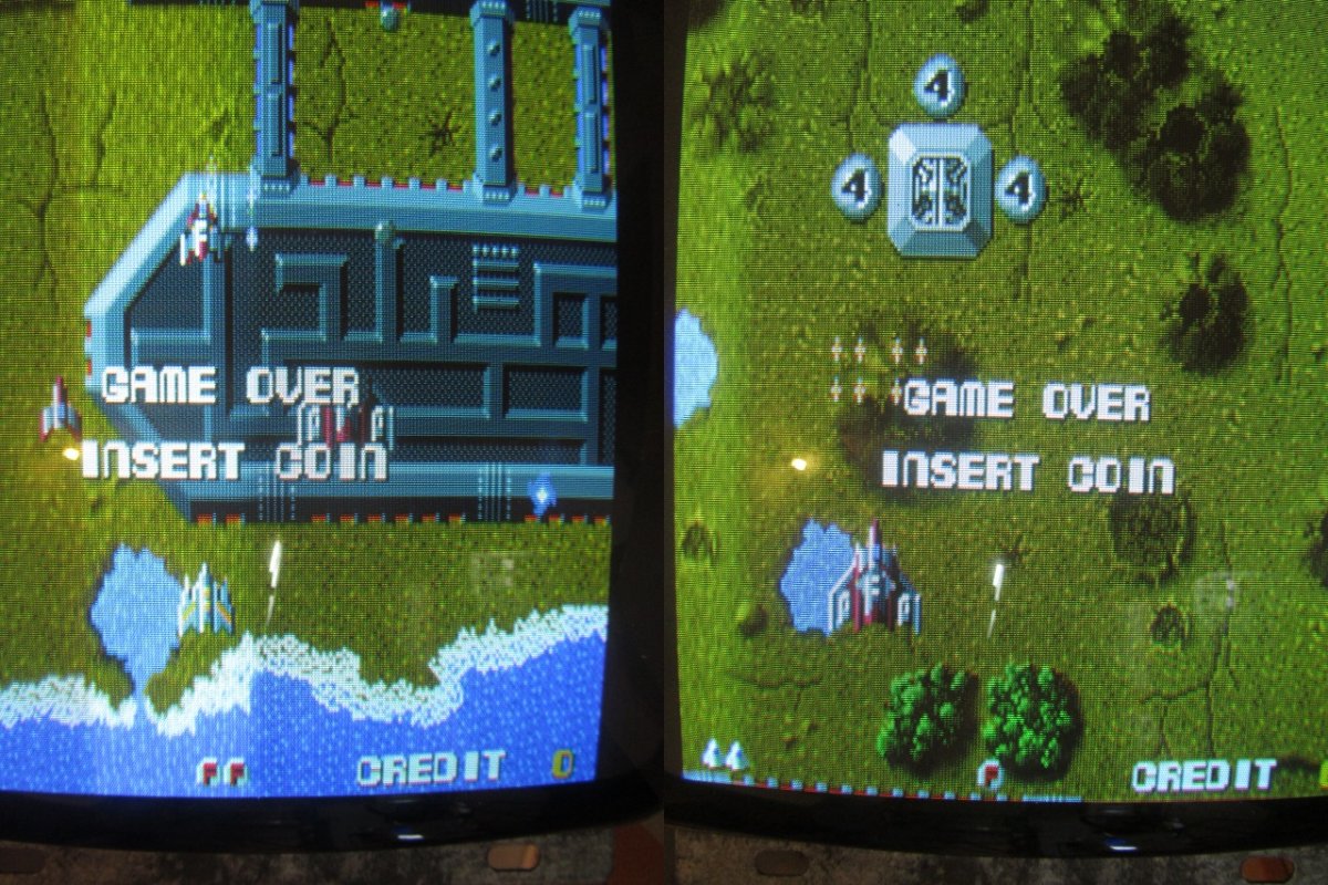

Here a comparison of the title screen, left side blocky sprites, right side correct sprites.
This is btw showing that the animated phoenix is sprites based.
