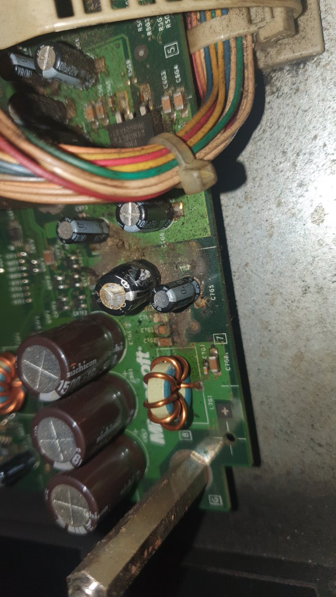

This happend to have a single row powersupply connector motherboard with an exploded capacitor and seized fan.
it will most likely be stripped for parts and swapped over to a retail board to get it working again.

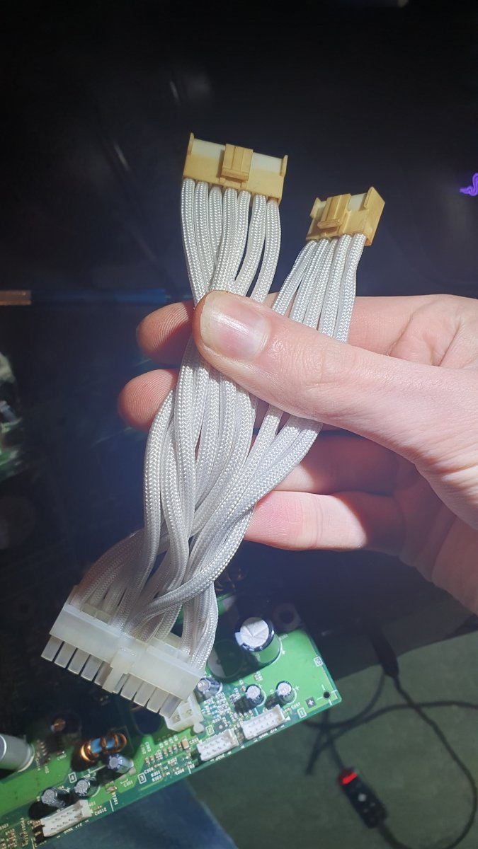

the problem with this is that I dont have the correct wiring harness to swap my double row powersupply motherboard in here.
so I did this:
Looks pretty good.
I have connectors and terminals on the way to create an adapter for a regular ATX powersupply, then I can test what works and what doesnt.

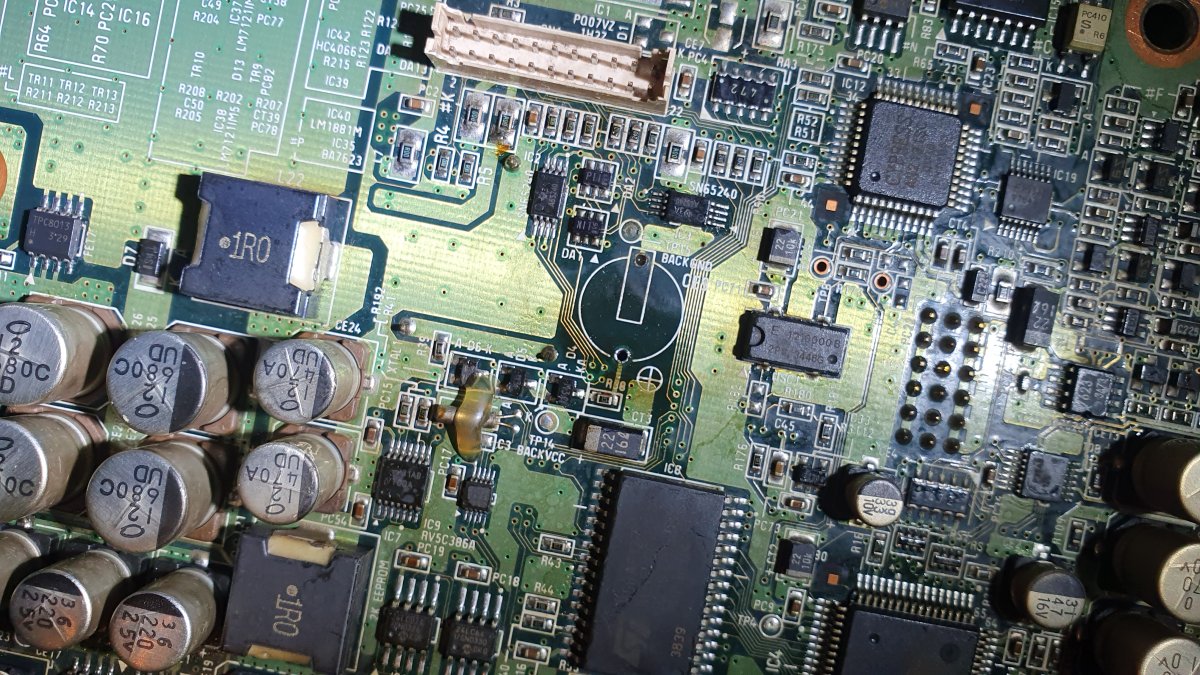

Interesting. Maybe the sega mainboard that plugs directly into the xbox motherboard needs recapping
Recapped those two, didnt help the issue but that was expected.
Is there a cap order list available for the video board?
If not I will research what caps it needs.

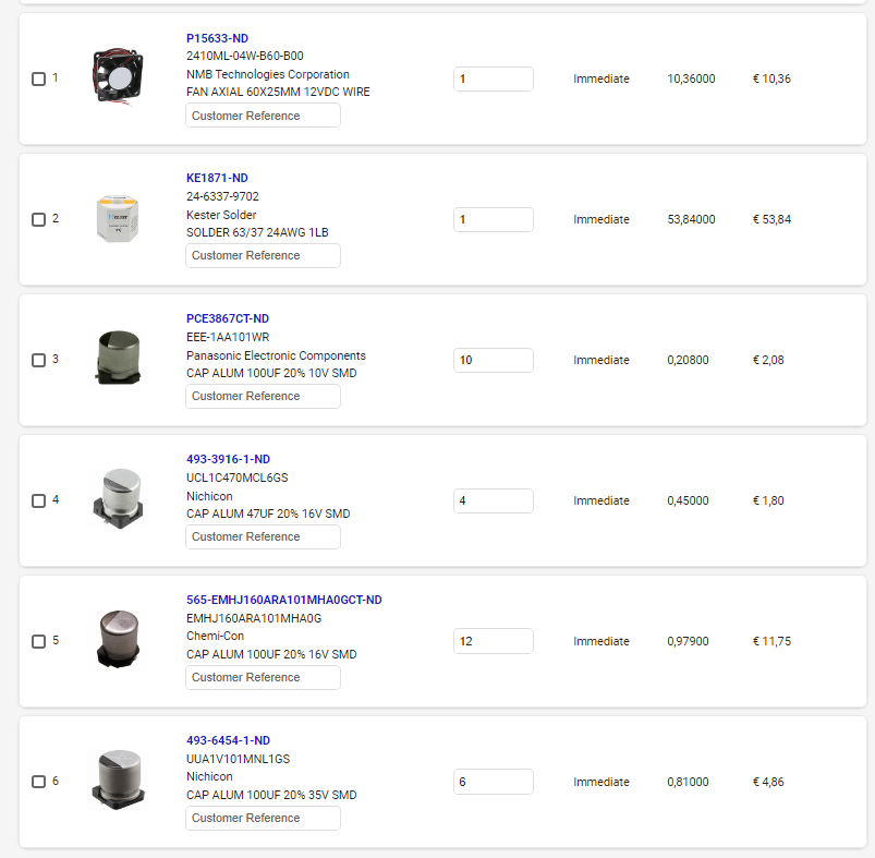

So I got a recap list together for the 'video board' which should hopefully clear my errors and my pink image.
Just not 100% sure if the caps are the correct voltage rating but I will find out soon, once I do I will post the list here.

So I added new cells, and I change the video dip-switches so now my output is like its supposed to be.
I also recapped the xbox motherboard completely.
Now onto solving error 02 Main board malfunctioning.
Is there really that little known about this error?
The only leads I have is recapping (which I will do soon)
And that the cyprus IC's might be faulty because I also cannot get to the test screen or in service mode.
