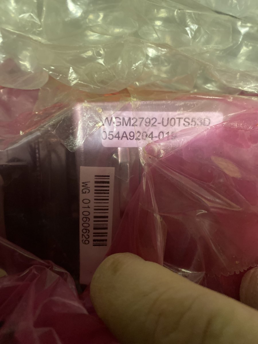

I have NOS
D9200. Aka 2792. Tri sync
Chassis wells Gardner
£240 each
£70 5 days air mail to any where USA insured 👍
