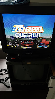

      I probed the sync signal on connector H (bottom board) but it was missing. It's coming from a LS125 (IC91) and sure enough input was pulsing but output was dead. I replaced it and could finally play a psychedelic version of Turbo OutRun:

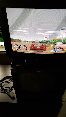

      Turned out both road ROMs (IC11 & IC47) had been replaced by 27C512 chips (64kB) when they should be 27C256 (32kB).
      Of course that shouldn't be a problem if you double the file before burning it but here I didn't even check the content of the ROMs and installed fresh 27C256s instead, which restored the road:
