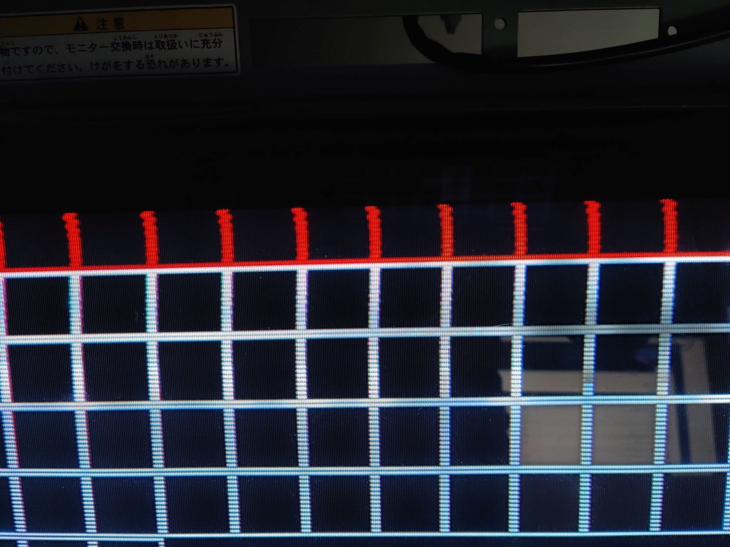

Hello
I have an issue with display very visible on the cross match. Note that, it's the only system with which I have it. I remove the foam below the PCB. Do you have any idea, a component or a capkit to change, if so which one?
THX
After some of search it's seems recurrent issue with new net city and all model slot.
Yeah, it's an issue with sync. If you alter the sync you could get rid of it. Not worth it IMO.
thx how to change the sync? on pcb or on monitor? Sorry what's IMO?
THX
I did not know we could change sync in the pcb. how to please?
It's just the way Neo Geo's are. There's a sync mod involving changing the crystal. It's not worth the trouble.
