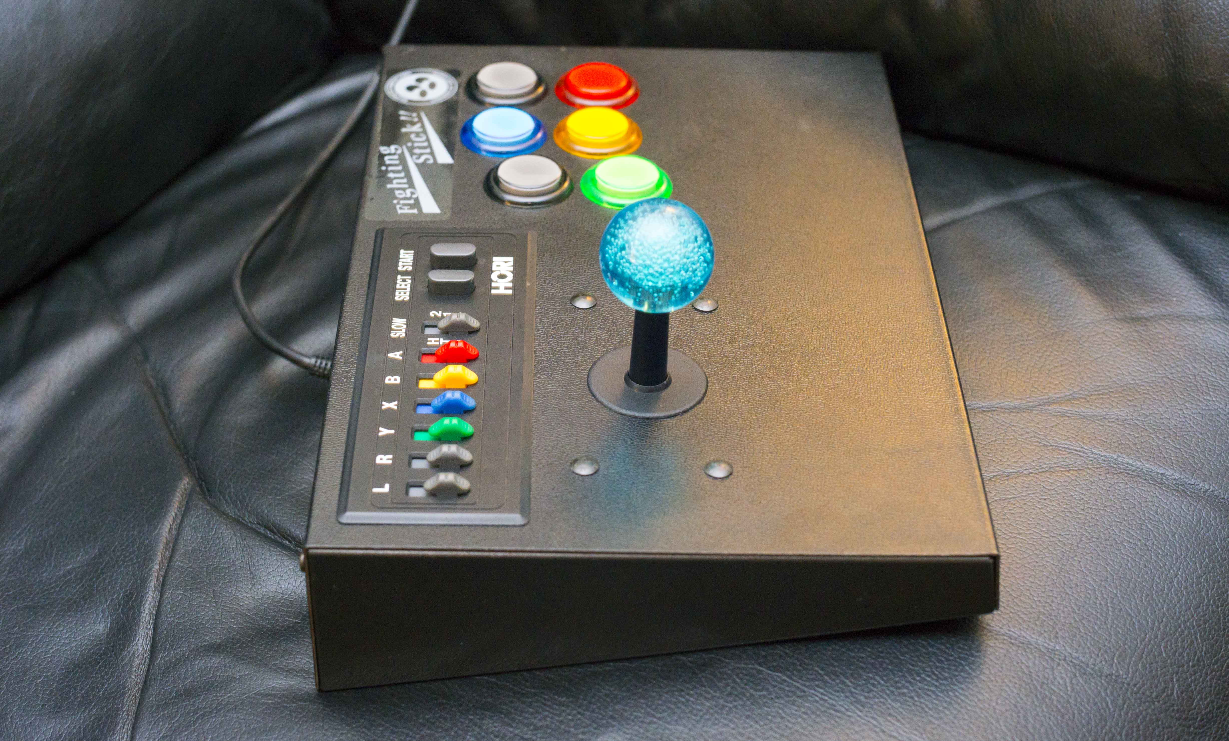

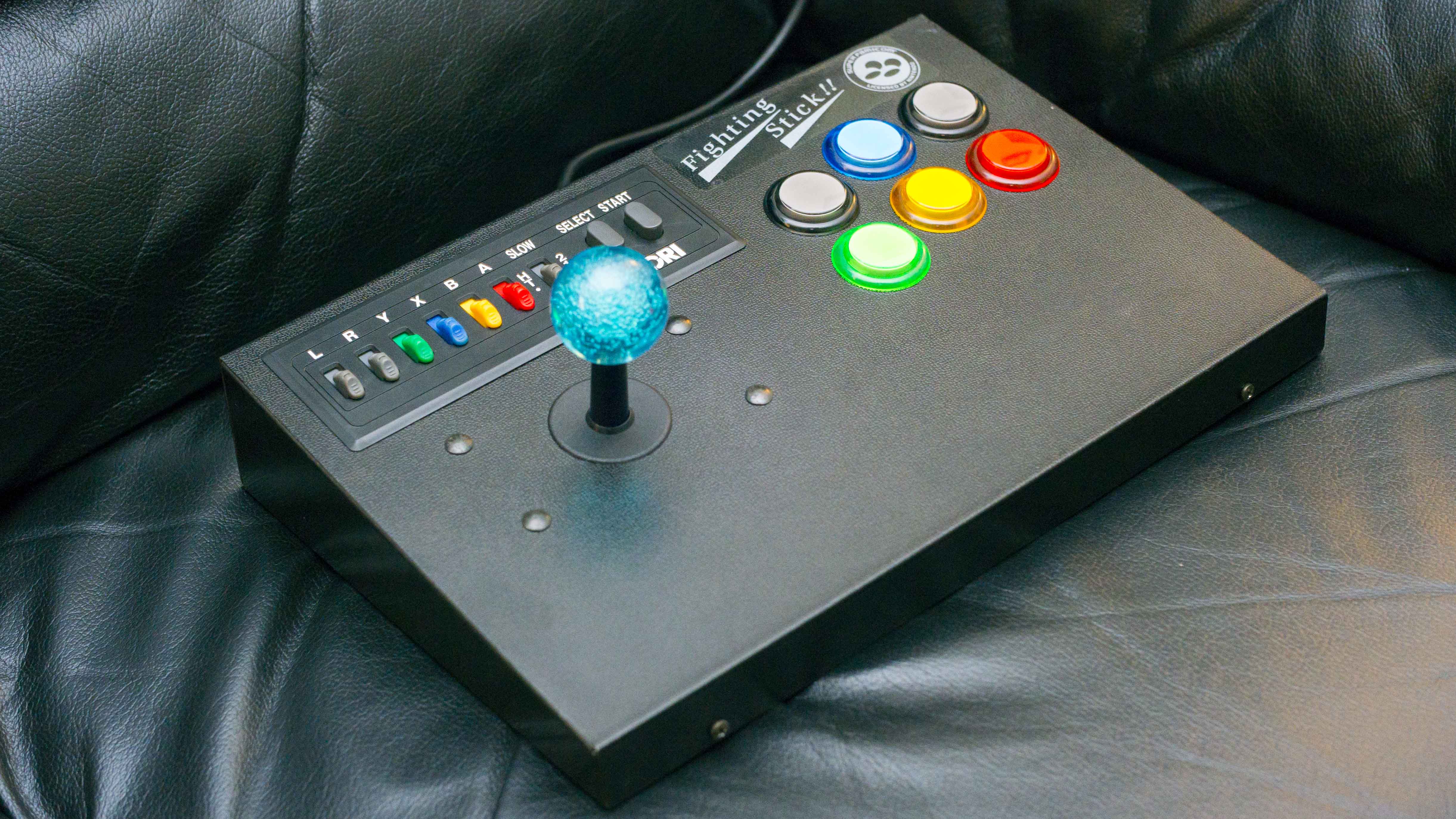

      This is the second Hori Fighting Stick HSJ-12 that I've restored. I wrote up the other here. These HSJ-12s have heavy steel cases and take LS-32 sticks and 30mm buttons with minimal effort.
      Like the other HSJ-12, I cleaned it, stripped the case, painted it Rustoleum Hammered Black, and replaced the buttons and stick. This time the label/sticker survived. It has Sanwa 30mm buttons, a blue bubble ball, and a Seimitsu LS-32 stick.

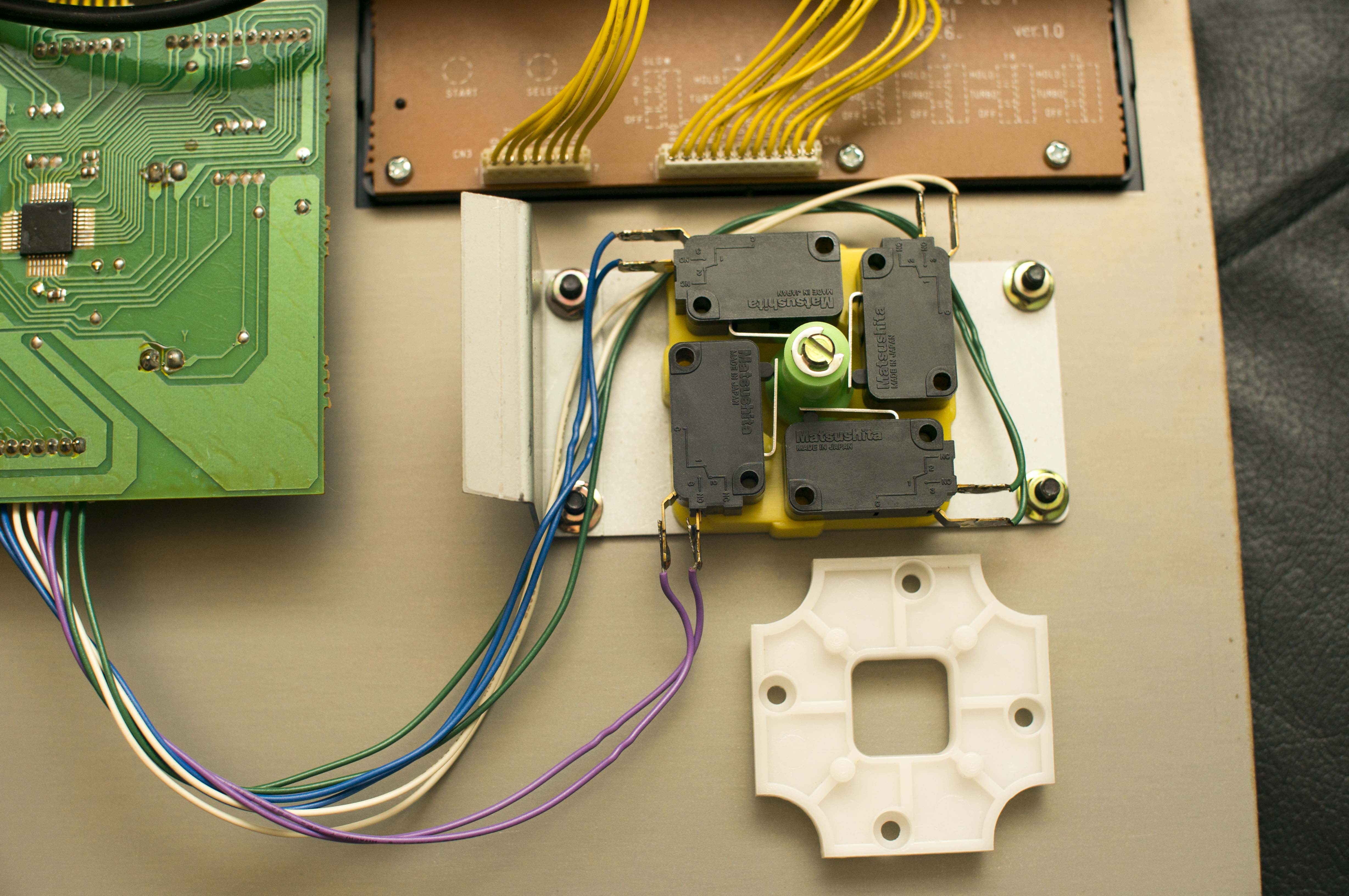

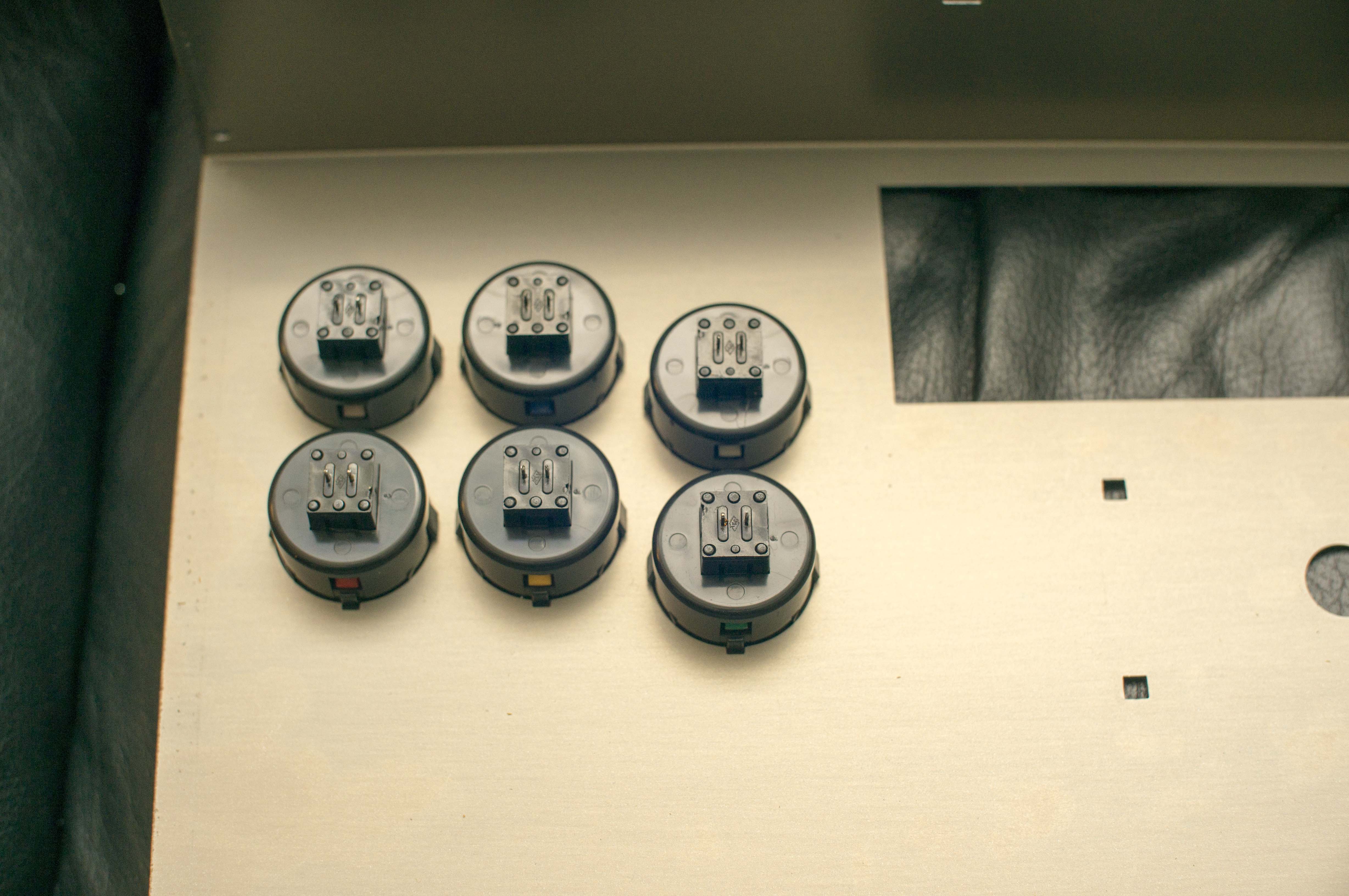

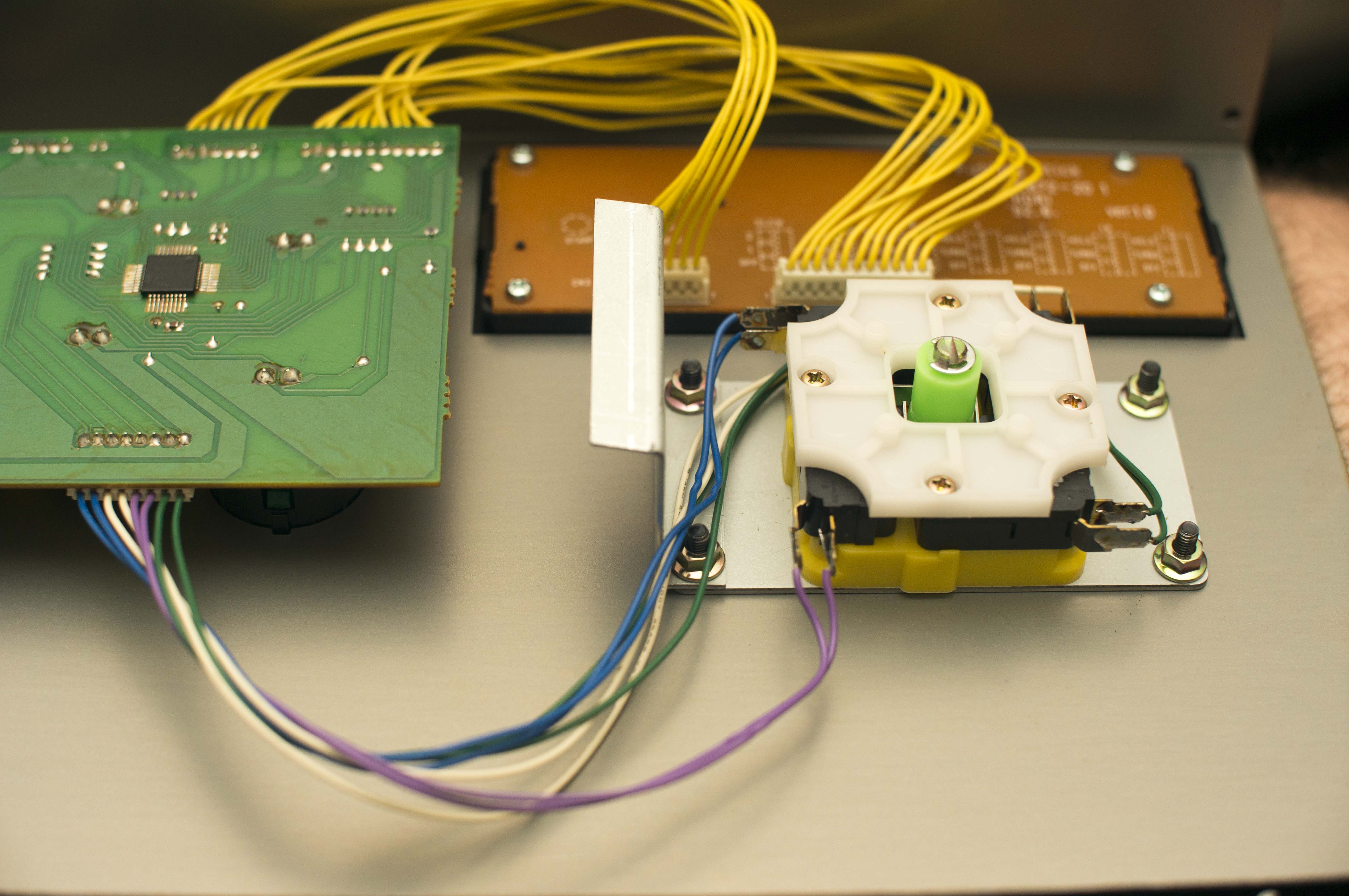

      inside (before)
