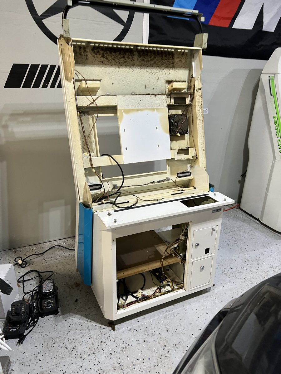

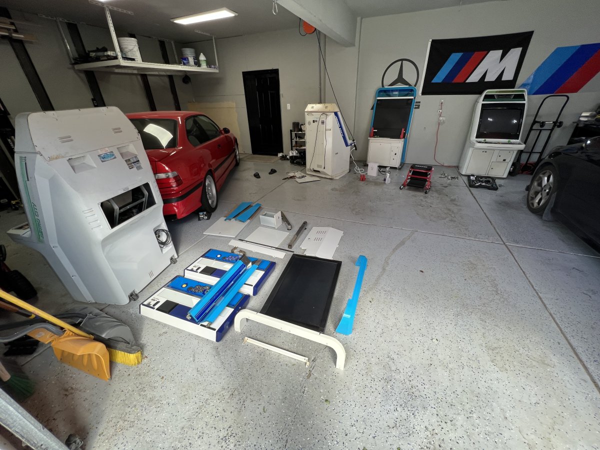

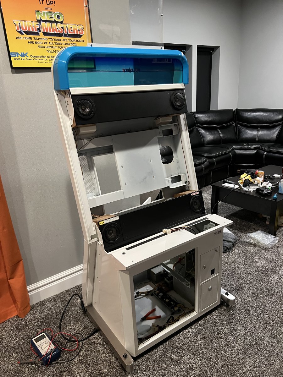

I started with the vewlixes because they’re pretty dang easy to take apart and clean.
Last time I did this it was winter so I did everything in my covered patio. It sucked. I’m grateful for good weather so I could clean these outside.
Like I did with the last ones I used a mild degreaser (method from target. Probably spent $70 total on that cleaner during all this 🫠). Let it soak for a bit, then hose down.
I made sure to really clean the bottom of the cabs with the degreaser and then alcohol so I knew they’d be clean while sitting on the carpet.
During this process I found 350 yen in coins. So it’s already paying me back.
The process of cleaning these is pretty standard. Take prices apart, soak them in degreaser and cleaner, rinse off, reassemble. The worst parts are the plastics. They’re so brittle after years of sitting and likely being somewhat in the sun. It’s best to tread carefully with them.
I also cleaned all the harnesses. I usually do simple green, then a quick alcohol bath, then blow out all the connectors with air and hang dry for a couple of days.

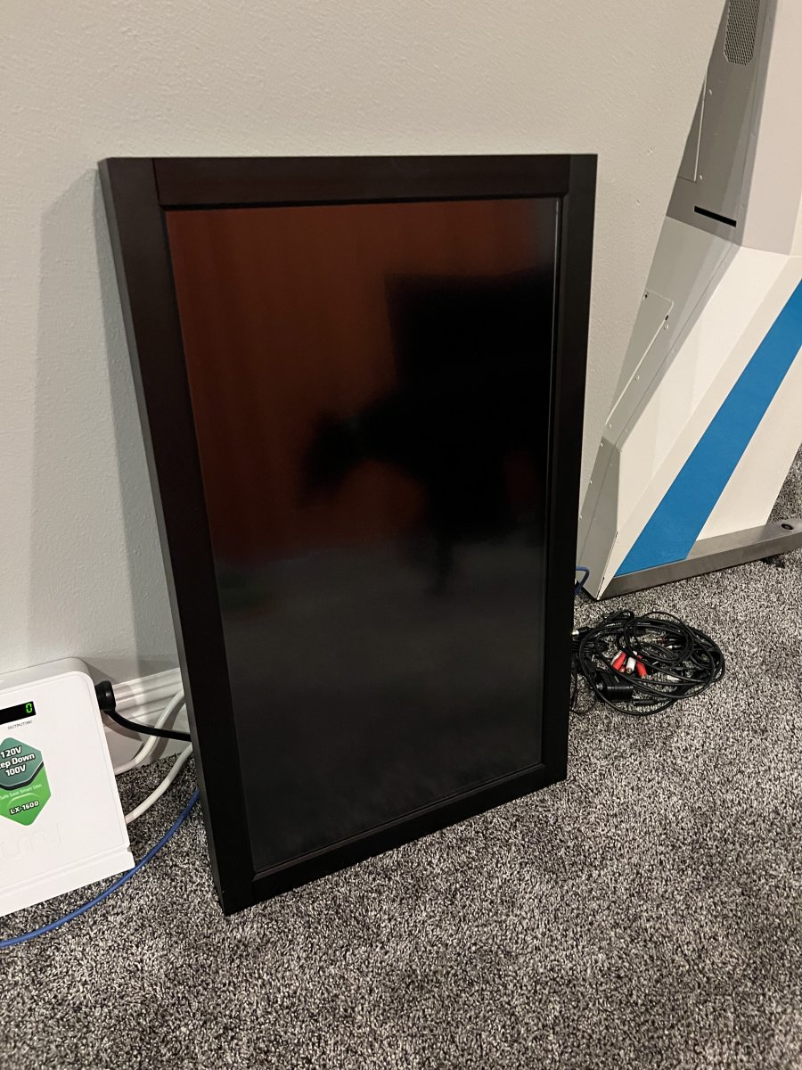

The monitors were in really good condition once I got the glass off and cleaned the dust out. These will be great until I swap them with 1440 monitors using @FrancoB’s mounts.
I made sure to clean the monitor PCBs and fans, too.

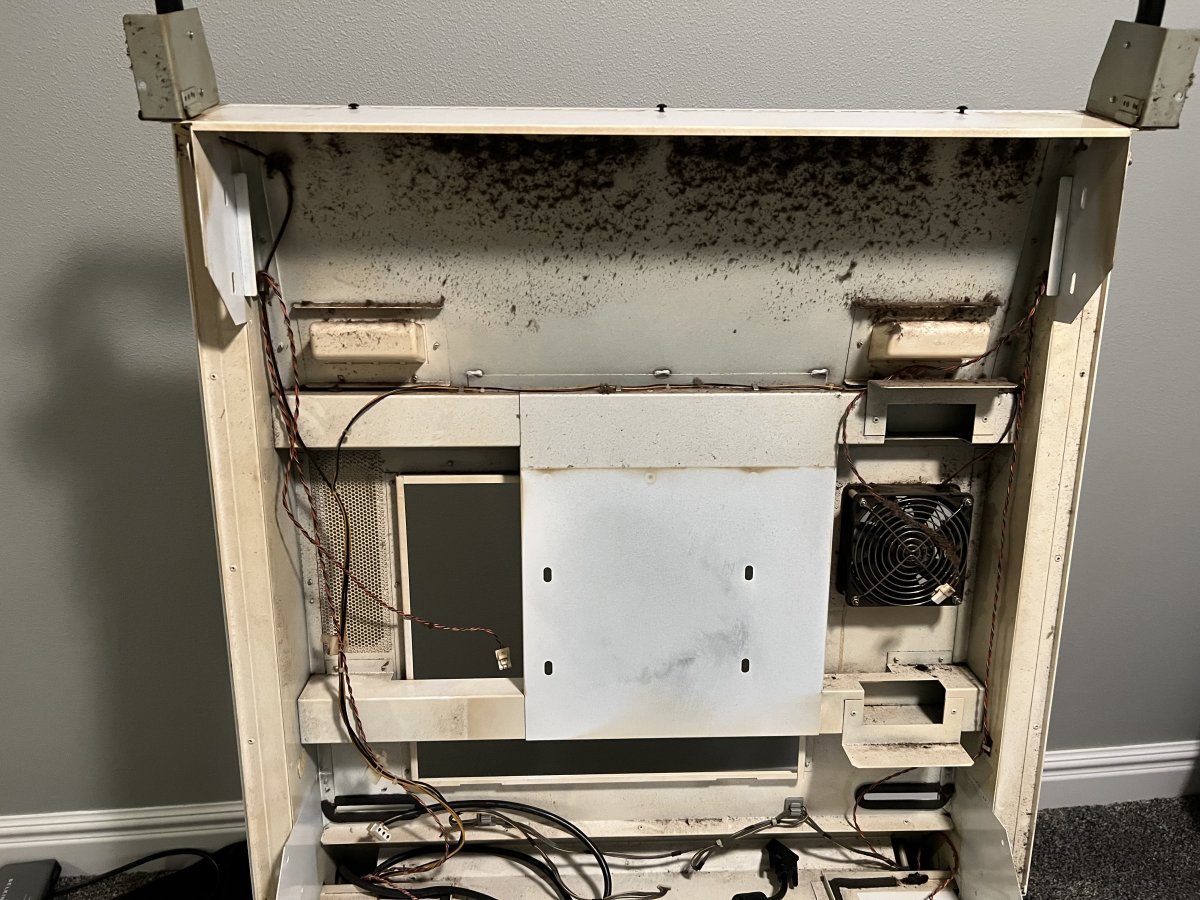

This one was a bit more dusty than the last one… that fan wasn’t doing much as you can see.

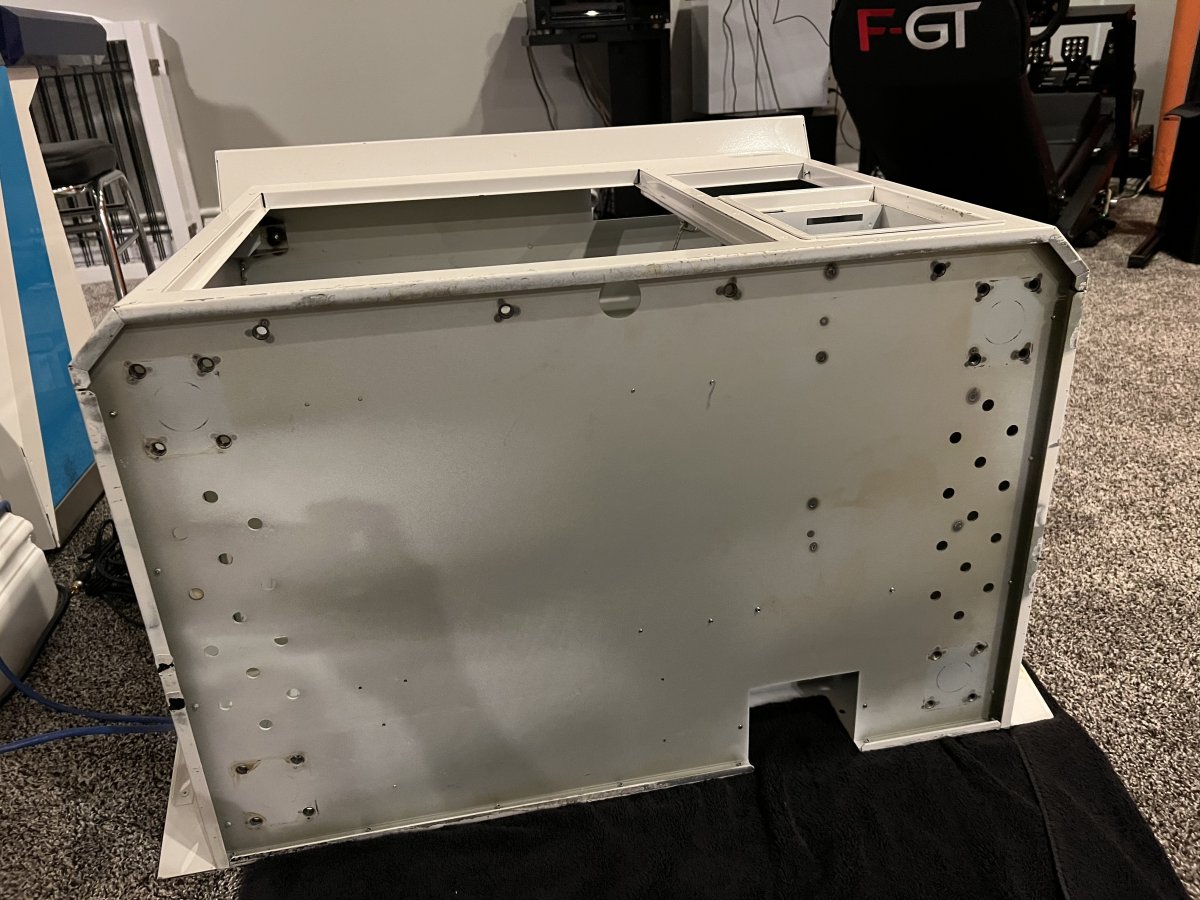

Same procedure here. Washed outside, cleaned it up: got the bottom and the casters real good.
For the casters I actually used my drill with some sandpaper attached to it and sanded a layer off of them to get as much of the embedded gunk out. It works really well. Sorry I don’t have photos. You’ll just have to trust me.
A before and after of getting the dust out of the monitor. It’s like a new panel!

Getting things back together
And finally. The DBs are clean:

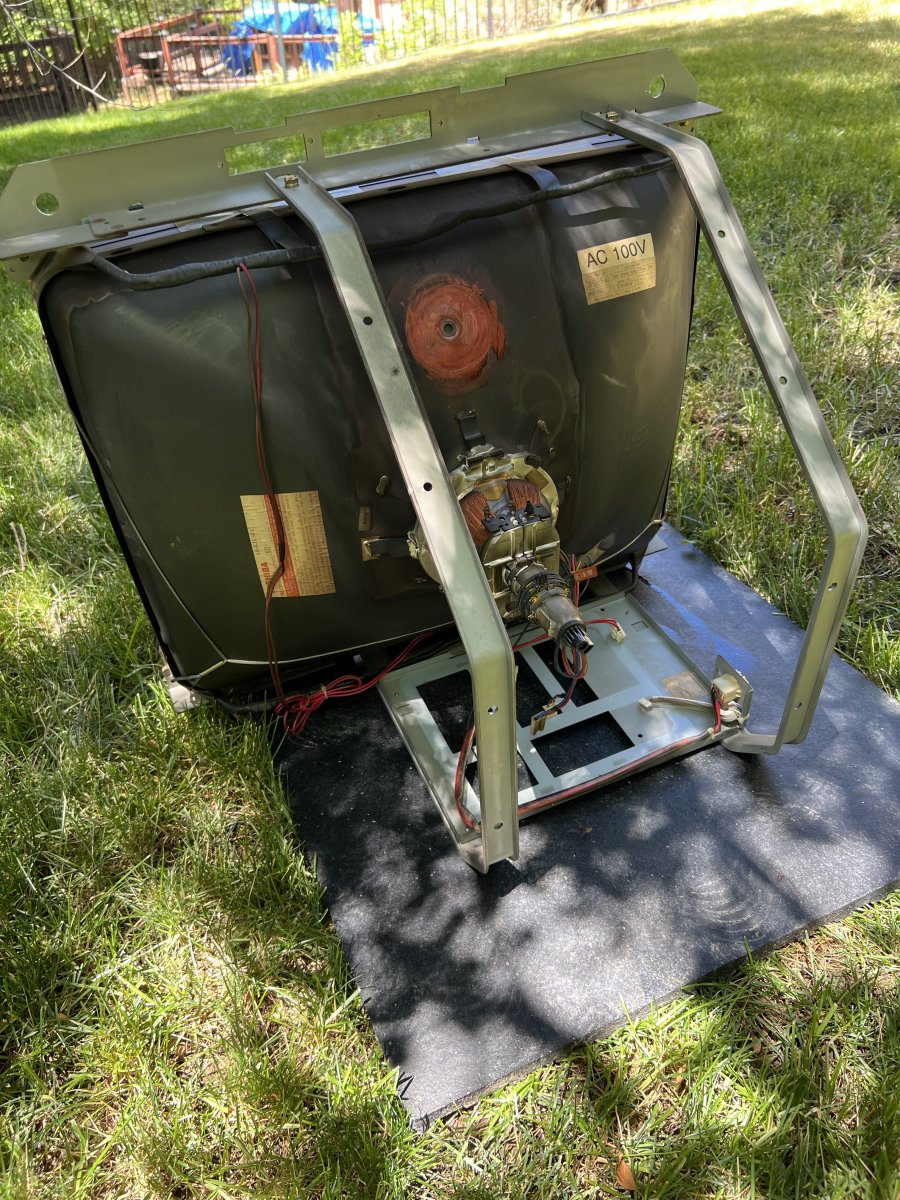

One of my CRTs was super clean. I decided not to clean it or the chassis at all. This one, on the other hand, was caked in black grime. This one got a simple green bath and a hose. Then I blew everything out as best I could with the air compressor and sat it in the sun for a bit to really dry out.

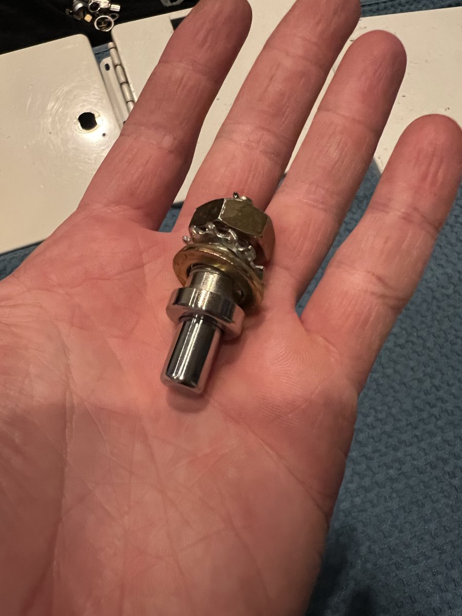

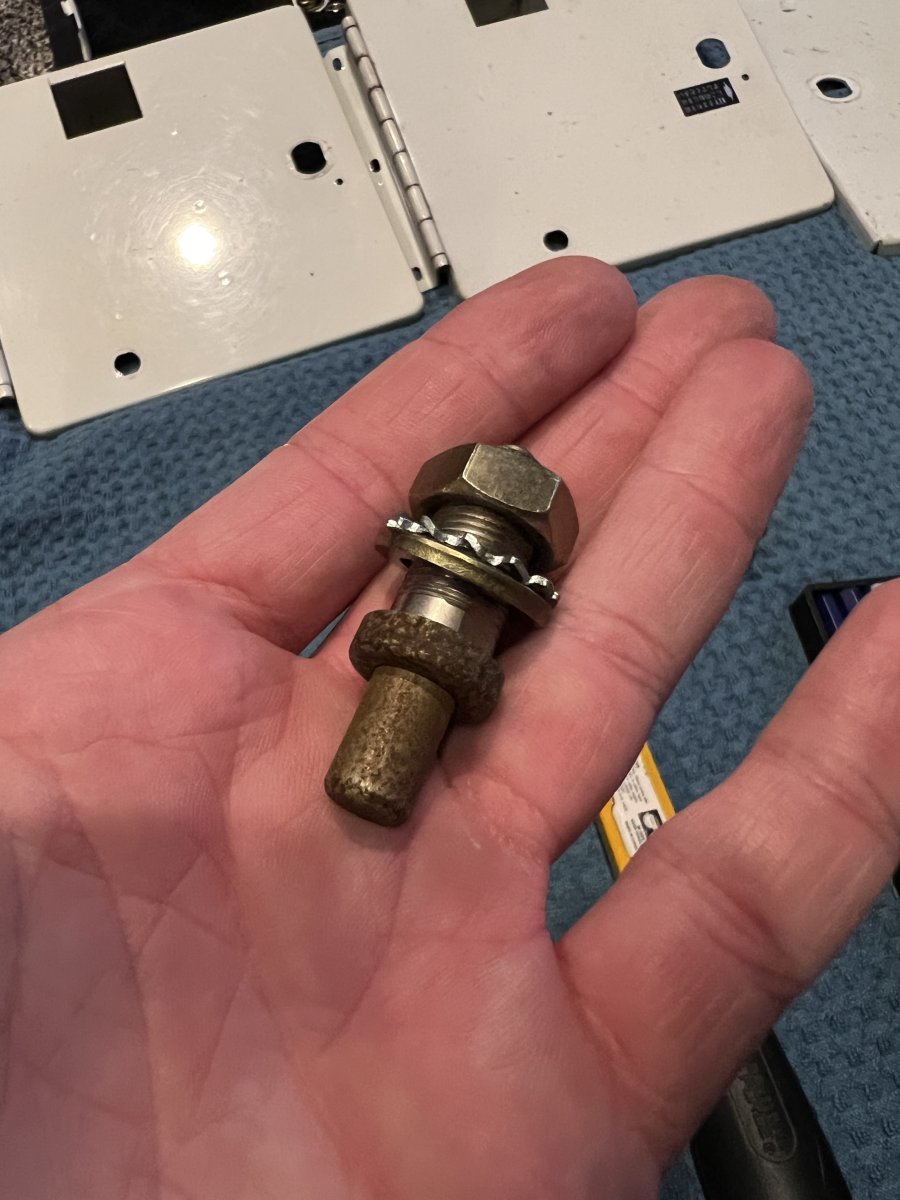

Cleaned up the ejector buttons. Took the pin out of the back and then I put one end in the chuck of my drill and held sand paper against it. Takes like 5-10 minutes for a beautiful result.

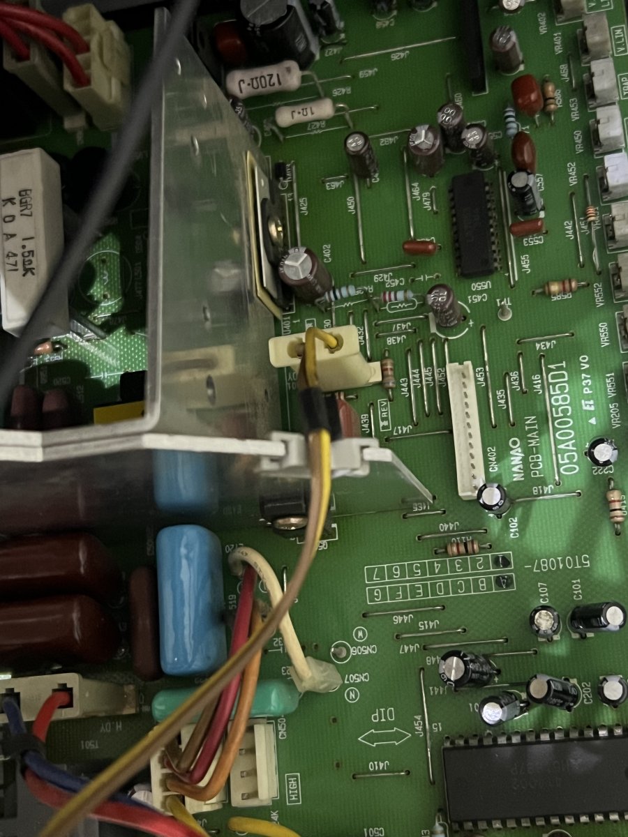

Next up was re-capping the chassis and PSUs.
This one was the one I washed. It was super easy. I actually don’t think this one had ever been recapped and if it has it was only a couple of them. Since I don’t do this often, it took me a while, but after a couple hours it was good to go.
Whenever I do a chassis recap I always follow Mike Moffit’s calibration guide to get it dialed in. It’s not perfect of course, but it’s a fantastic starting point.
Color came out great and just a small wave in the top left. I played with some convergence strips but I couldn’t really get it to a good place so I just left it for now.
One down!

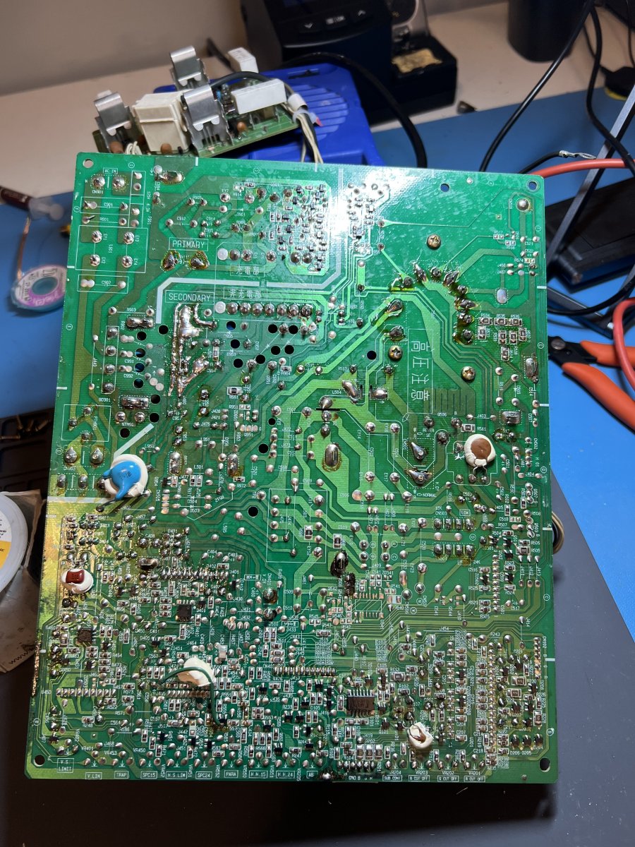

On this next one, I was taken aback by how clean the board was. I also noticed it had what looked like nichicon caps… sadly, they were knockoffs. And I soon found out why it was so clean… it’s seen some shit 😂
So obviously this board must’ve had a serious cap leak. I will say the person that did the repair did a pretty decent job. I worked around it as best I could and got the caps replaced. There were a couple wrong caps in there though. For example, one of the 680uf caps had a 1000uf in its place. I did a bunch of searching and couldn’t find anyone else with that same phenomenon so I put the 680 in that came with the cap kit.
I wrapped it all up and then started with B+ measurement. It was 76.5 or something, really. Not bad. I lowered it a bit and then powered it on and got a beautiful image.
As I was adjusting the color, though, I started to notice some wiggles in the screen. Almost like the horizontal sync was off. But it’d go away when I was done adjusting. I assumed it was just the pots or possibly the remote board. So I swapped with the other one, but it was doing the same thing.
I continued with my adjustments and then all of a sudden:
Womp womp. I was worried one of the caps I swapped was the issue, or maybe the pots were just really jacked up? Either way I was not happy. I undid everything and started with reflowing the pots and then tended to the bad area from the previous picture. I flooded the entire area with solder.
Praise be: that was all it was.

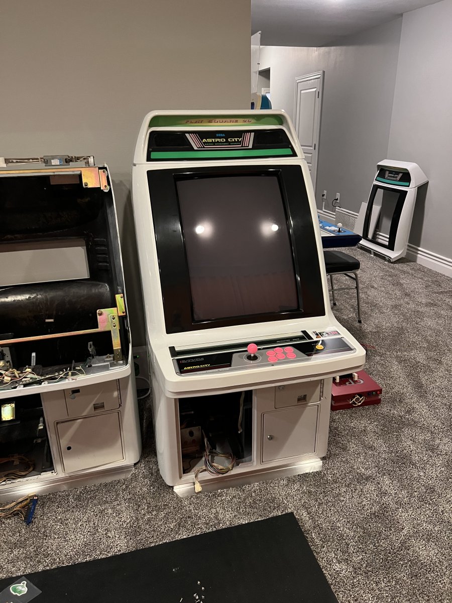

So finally, they’re all cleaned! I had to order a couple JVS PCB plates (the metal PCB mount that goes in the control panel) and G harnesses. So those are on the way. I also just got a new fluorescent LED tube today from a company in NY that is a drop-in replacement for a missing lamp: https://www.amazon.com/dp/B094YW57YC?ref=ppx_pop_mob_ap_share
Aside from the locks, these are all pretty much done. I’m really happy to have these projects in a complete state. Can’t wait to make some memories.
