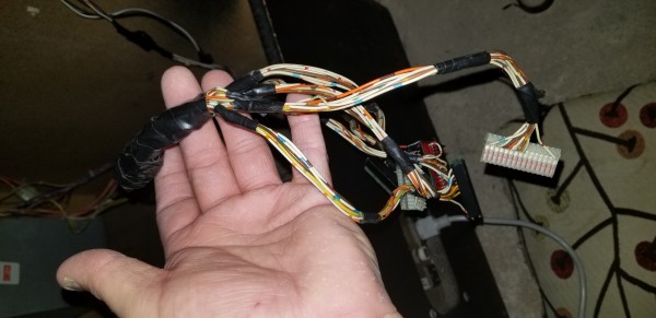

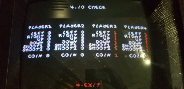

I have the 6 slot jamma board in my Simpsons arcade and have ran into a issue where all the 3rd and 4th player controls are stuck in the closed position.

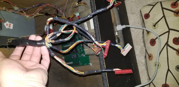

I can not get player 3 and 4 to work. It looks like someone that had the system before me created their own harness for 3 and 4.
Thinking of buying a new kick harness and rewire 3rd and 4th player controls but I am very new to wiring and such.

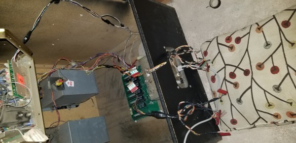

Rewiring might not be a bad idea, but what happens when you try the board straight to the JAMMA harness in the cab, and not the 6 slot switcher?
it works except player 3 and 4 when attached dont work. I dont think its the jamma board as player 1 and 2 work fine since they run through the board. It's only player 3 and 4 that are giving me a issue.
I should mention I have tmnt, avengers, and sunset riders which all have the same issue when plugged in making me lean more towards a wiring issue with the 3rd and 4th player.
think I figured it out....dont think the original owner added diodes to the kick harness which when all the games are plugged in gives a false reading to the arcade making it think all the buttons on the kick are being pressed. I'm going to take out the harnest and try to add some diodes
