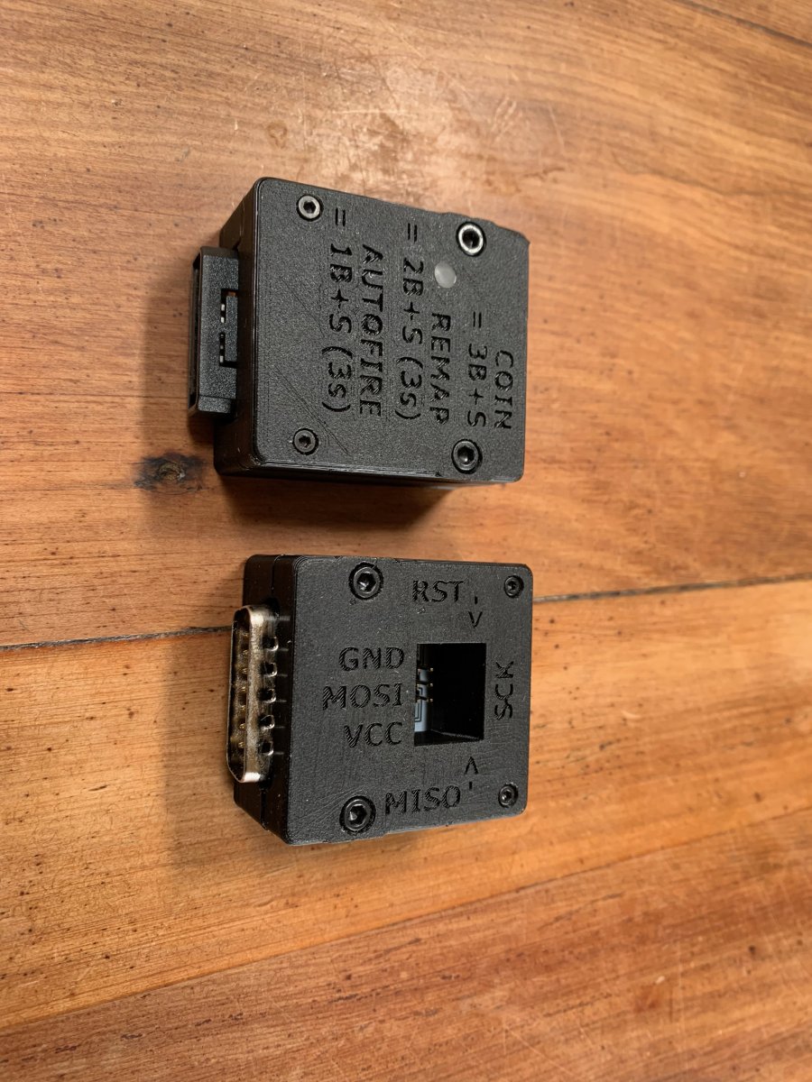

Printed

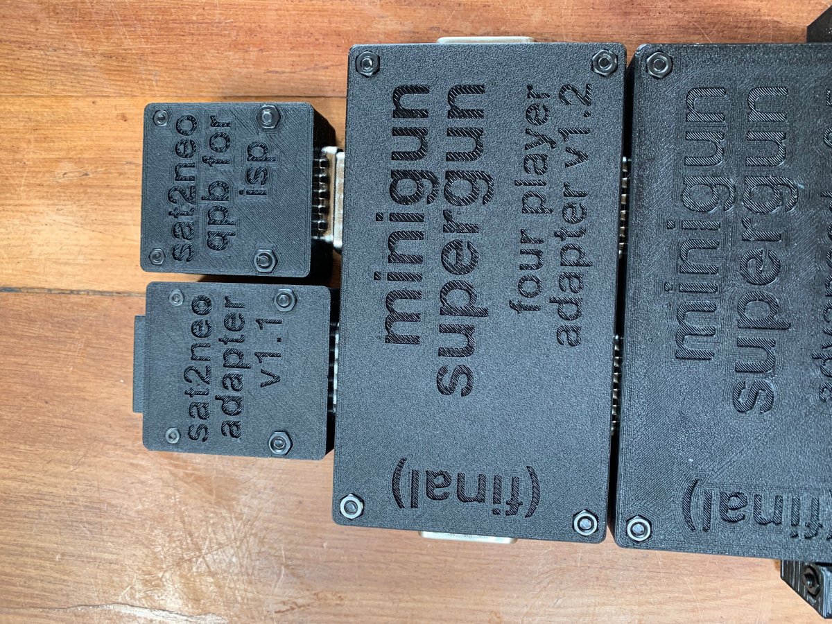

Matchy-matchy

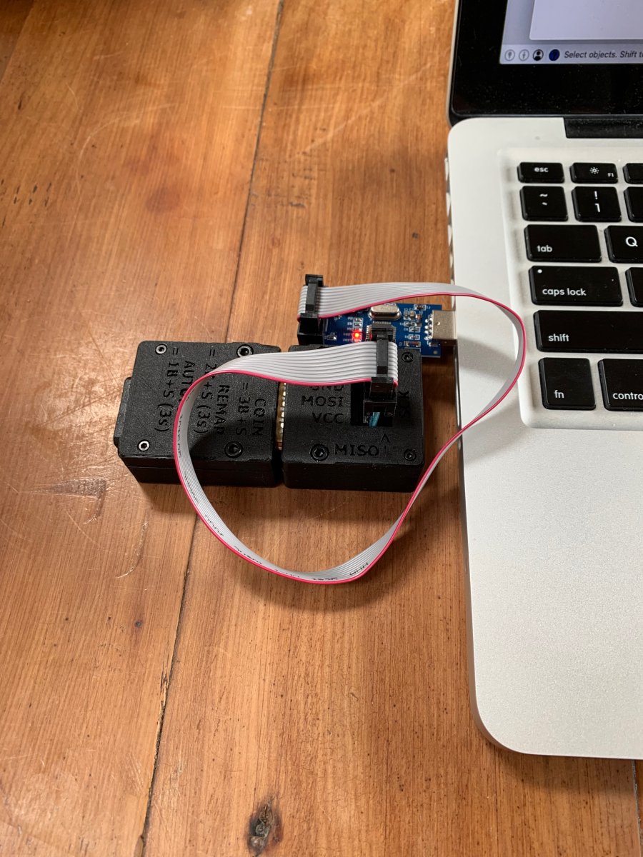

And ready to use
