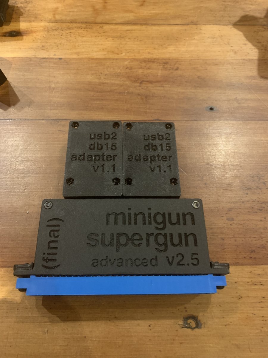

This is a case for the USB2DB15 Custom PCB1.1 that the awesome @Raph_friend has released on GitHub
It's important to note that there is a newer and even more awesomer version that Raph and the team are working on too. You can read about that and get on the order list for that one here
https://discord.com/invite/XKCjtpH
The new version a complete re-design and incorporates the arduino and USB controller all into one tiny PCB - its super sweet
But if you want to make your own USB2DB15 this case is for the publically available version (1.1) on GitHub
You can read about the project, the custom PCB, the code, and the other hardware requirements here
https://github.com/Raphfriend/USB2DB15

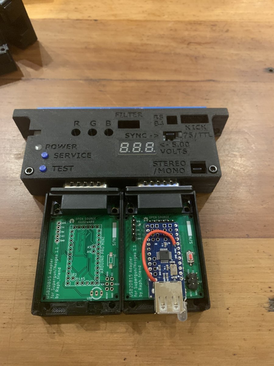

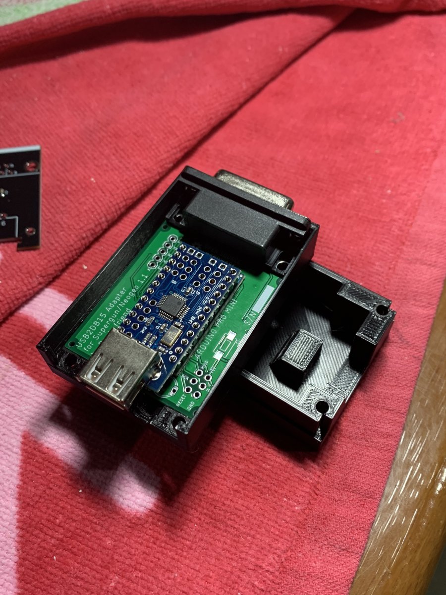

This case is designed to house the custom PCB + Arduino Mini + USB shield sandwich.
It's in 3 parts
1) Top half
2) Bottom Half
3) Reset Button
The top and bottom half will print without supports; I used a Creality Ender 3 Pro with Flashforge plain black filament, Bed = 60, Nozzle = 200, Support = none, infill = 20%
The reset button has an overhang to keep it captive and hit the actuator; Bed = 60, Nozzle = 200, Support = all, infill = 20%
I've designed it to bolt together with 4 x M3 20mm socket head bolts + 4 x M3 Nuts

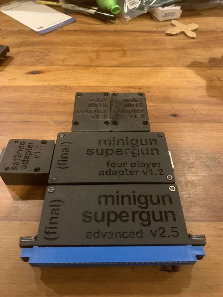

I've designed it in the same style as the cases for the sat2neo, the minigun supergun 4 player, and the other Minigun Supergun accessories, they all fit together nicely.
The print files for those are also in this forum too
If you wanted to make all of those you could 3D print the cases for them too and have a matching set
