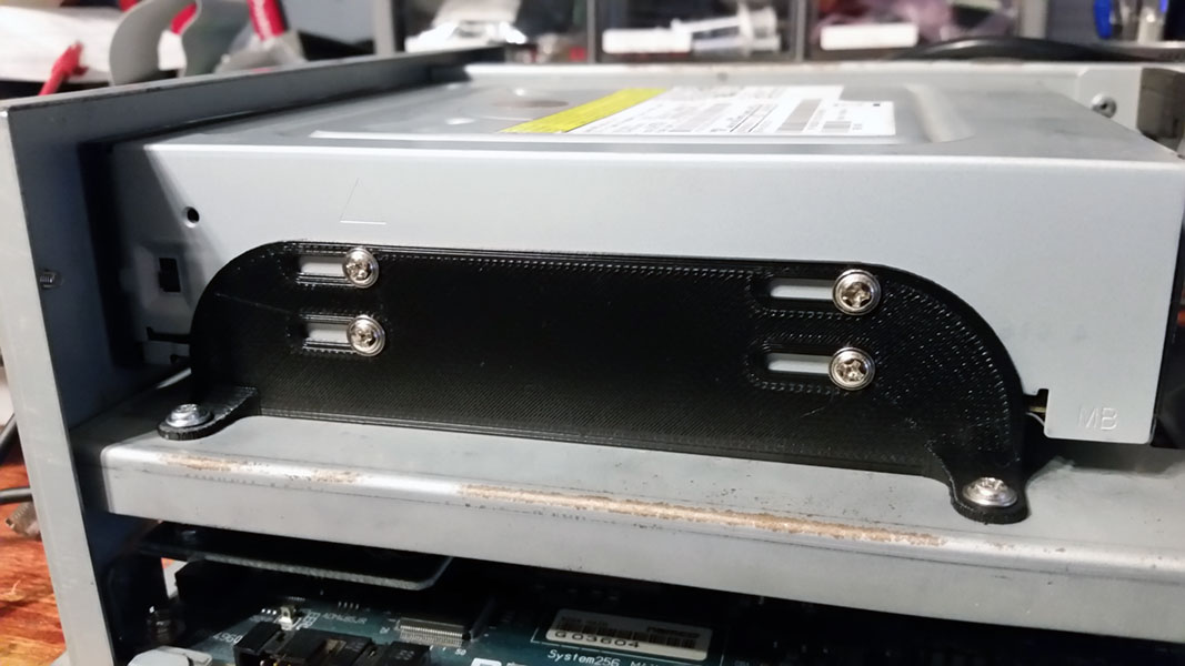

I got tired of of the DVD drive flopping around inside my System 256 so I designed some brackets
The mounting feet are spaced 130mm apart which is perfect for the System 256 bolt hole locations, it also elevates the drive slightly to center it in the opening.

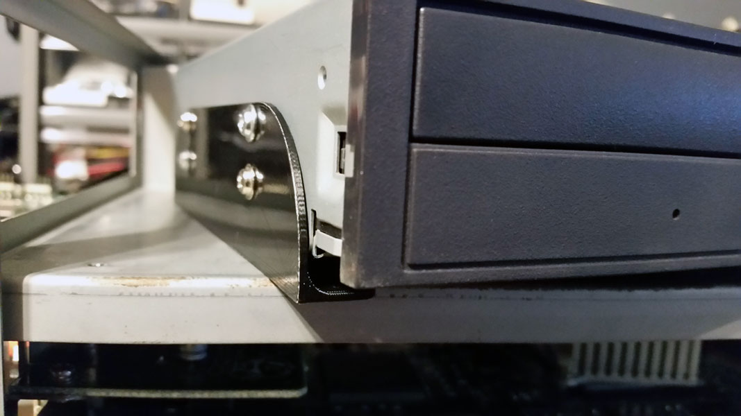

On the other side it's designed to be mounted with the feet turned inward since there are no bolt holes on that side:
Despite this being designed specifically for the 256 This is confirmed to fit the CPS3 CD drives and will likely fit any standard 5.25" drive.
As always the files are available for free on Thingiverse: http://www.thingiverse.com/thing:1764041
If you want one but don't have access to a printer I do not print and sell, but there should be an option on thingiverse to order one from a 3rd party on 3DHubs. Keep in mind you'll need 2 of them (one for each side)

it's not the strongest mount in the world since it's only bolted down on one side, but it will at least keep your drive from constantly sliding around.
