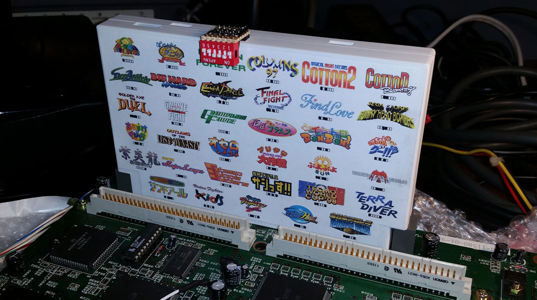

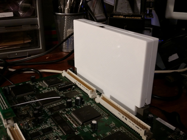

I've finally released the files to 3D print your own ST-V multi-cart housing. :)
If you want to use this with an original game there is an alternate front cover without the cut outs for the ST-V Multicart. The "bump" on the front of the cartridge has been removed to make for easier printing but this also means that this housing will not fit any game who's PCB uses a socketed EPROM in this area as there likely wont be enough clearance.(I haven't checked personally but it doesn't look like it would fit)

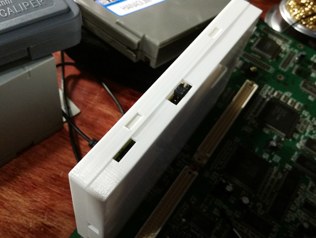

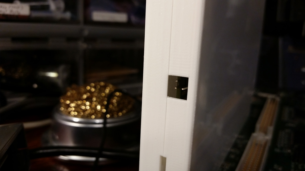

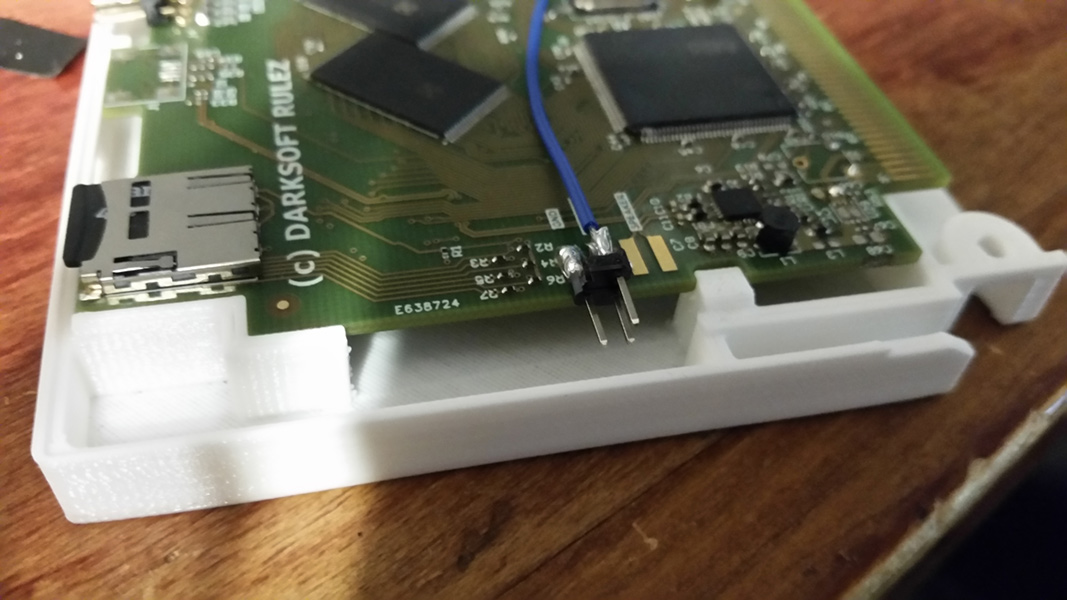

The Multi-Cart front cover has 3 cutouts designed to accommodate the jumper header, card slot, and reset/audio wires on a Darksoft ST-V Multi-cart. The jumper header opening should be large enough for a remote jumper or LCD selector ribbon cable.
For the reset wire and sound effects output on the multi-cart I recommend soldering a header along the side to route these pins to the side opening as shown in the photos below.

Quick question TS, where did you get the pictured dip bank? (the red one in your OP?) I used the remote cable/bank but I would like to switch to one of those now that I have the cart in a housing.
I found the dips on ebay: http://www.ebay.com/itm/DIP-Switch-6-Position-Right-Angle-Gold-Contacts-/160737959480
I just soldered it to a PCB and then soldered a female header next to it. Each of the inner pins on the dip are bridged to the nearest inner pin on the header. then all of the outside pins of the dip are bridge together and a single wire is run to a ground pin on the other side of the header
