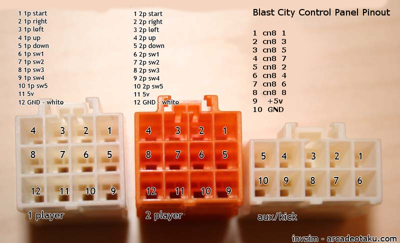

nonosto Champion Joined Jun 5, 2018 Messages 2,113 Reaction score 605 Location FRANCE Aug 22, 2023 #1 Hello How to run 4 & 5 button on Atomiswave with a Astro city please? thanks
notsonic Champion Joined Oct 23, 2019 Messages 1,129 Reaction score 1,440 Location NJ Aug 22, 2023 #2 Button 4 and 5 off the jamma edge should be the bottom right two connections when looking into the control panel connectors. I'm fairly positive all Astros and New Astros should be wired up for at least button 4 if not both. Mine is wired up for both but it's possible it was modified.

BroadwayJose Professional Joined Aug 14, 2015 Messages 531 Reaction score 431 Location Las Vegas, NV USA Aug 22, 2023 #3 If you have a CPS 1 or 2 style kick harness already installed, a JNX Atlas board can be used to reroute button 4 & 5 to the kick harness. I use that for Atomiswave on my Sega cabs, it's clean and I like it because I don't need to rewire anything.
