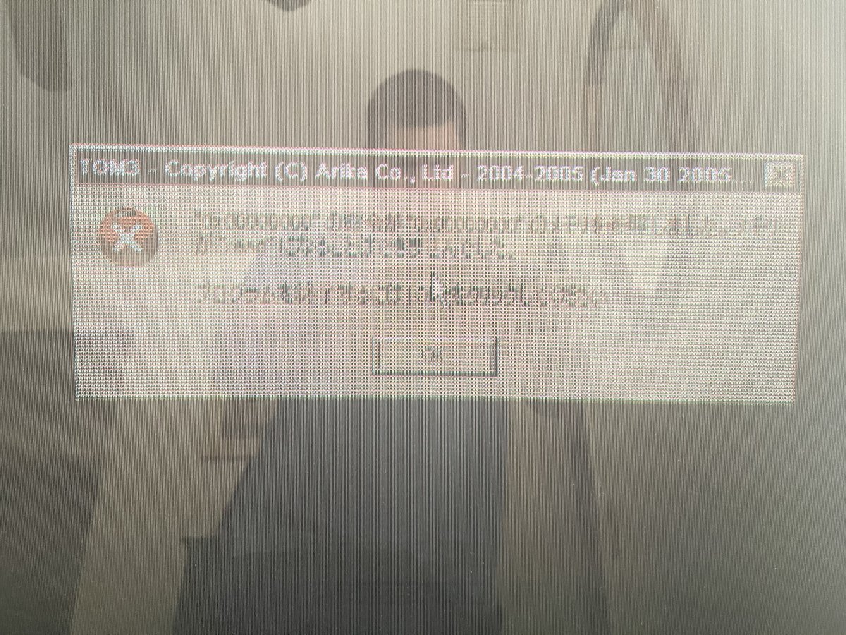

Anyone familiar with this error message when booting Tetris GMS on a Taito Type X1? All other games boot correct, running with the multi-kit card in the IDE slot.
thanks in advance!

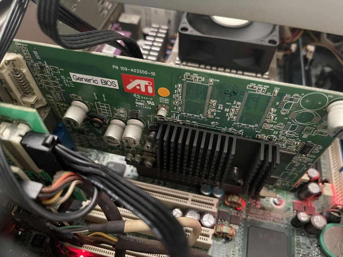

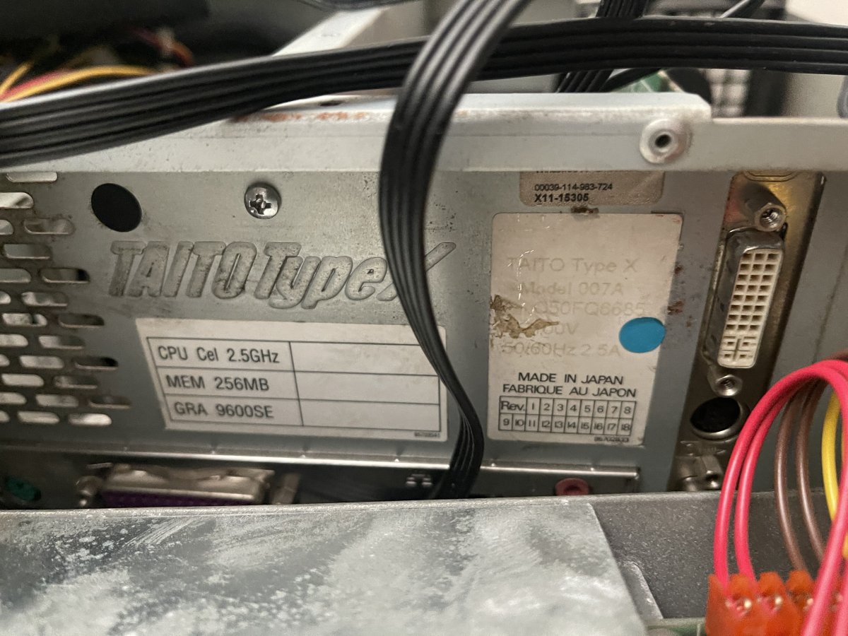

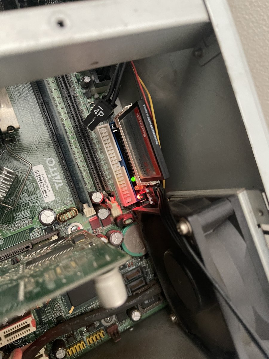

Here ya go! I’ve got 2 sticks of working Ram, GFX card is stock. TTX1 is as received from seller in Japan.
I am attempting to load the game in standard res via VGA out on the graphics card.

@davesarcades I see you're using CF, I tried that but it was too slow - you could easily see it in Raiden (not sure if it was 3 or 4) where the intro video was stuttering. I didn't use a fancy CF card, but something to be aware of. SATA works great though, no need to use IDE drives.

Please try to get that BIOS dumped as RTW suggested. That seems to be labeled different than the "JAMMA BIOS" used on all other TTX units I've seen.
What game was originally equipped in this TTX unit?

I don’t have an old computer to grab the bios but I’d be happy to mail it to someone who wants to grab the data. I don’t know what game it was before. If the GFX card is the reason Tetris doesn’t boot I’d be interested in buying a gfx card that will boot Tetris too :)
