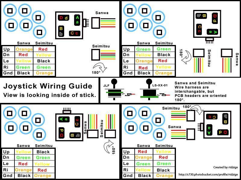

here is the pinout for your joystick,
did your sanwa joystick come with a white tap and wires coming out of it?
if so you can wire them to the control panel... also when you put in the bolts ..it has a squarer bottom to fit nice and flat.

Did your Sanwa come with a wire harness like in this image?

that's what usually comes with a Sanwa. Yes it totally works, that is why I asked above :thumbup:
