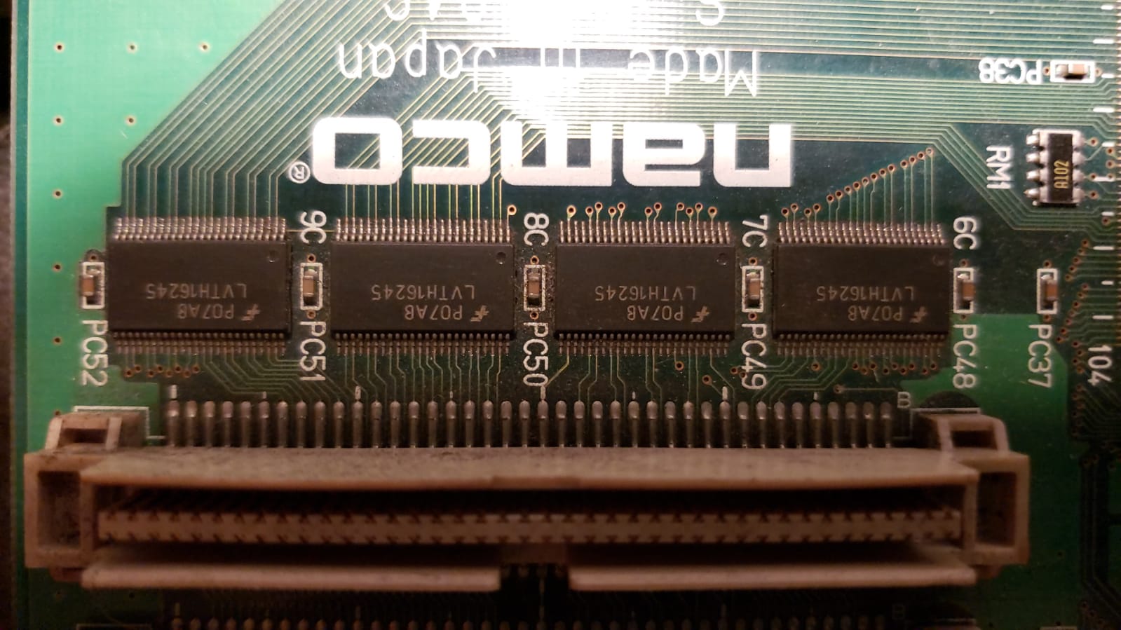

Did you try changing the buffers on the board? Those could be the reason.
See picture attached.
I found some here: https://www.ebay.com/itm/10PCS-LVTH...m2aa4ba7ad3:g:aQYAAOSwxxVavFXd&frcectupt=true
