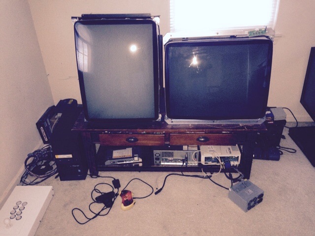

maybe hunt down a tri-sync monitor and a HAS supergun.. Here is a picture of my "arcade" setup.. But again another 15khz cab might be an easier solution if you have the space:)
