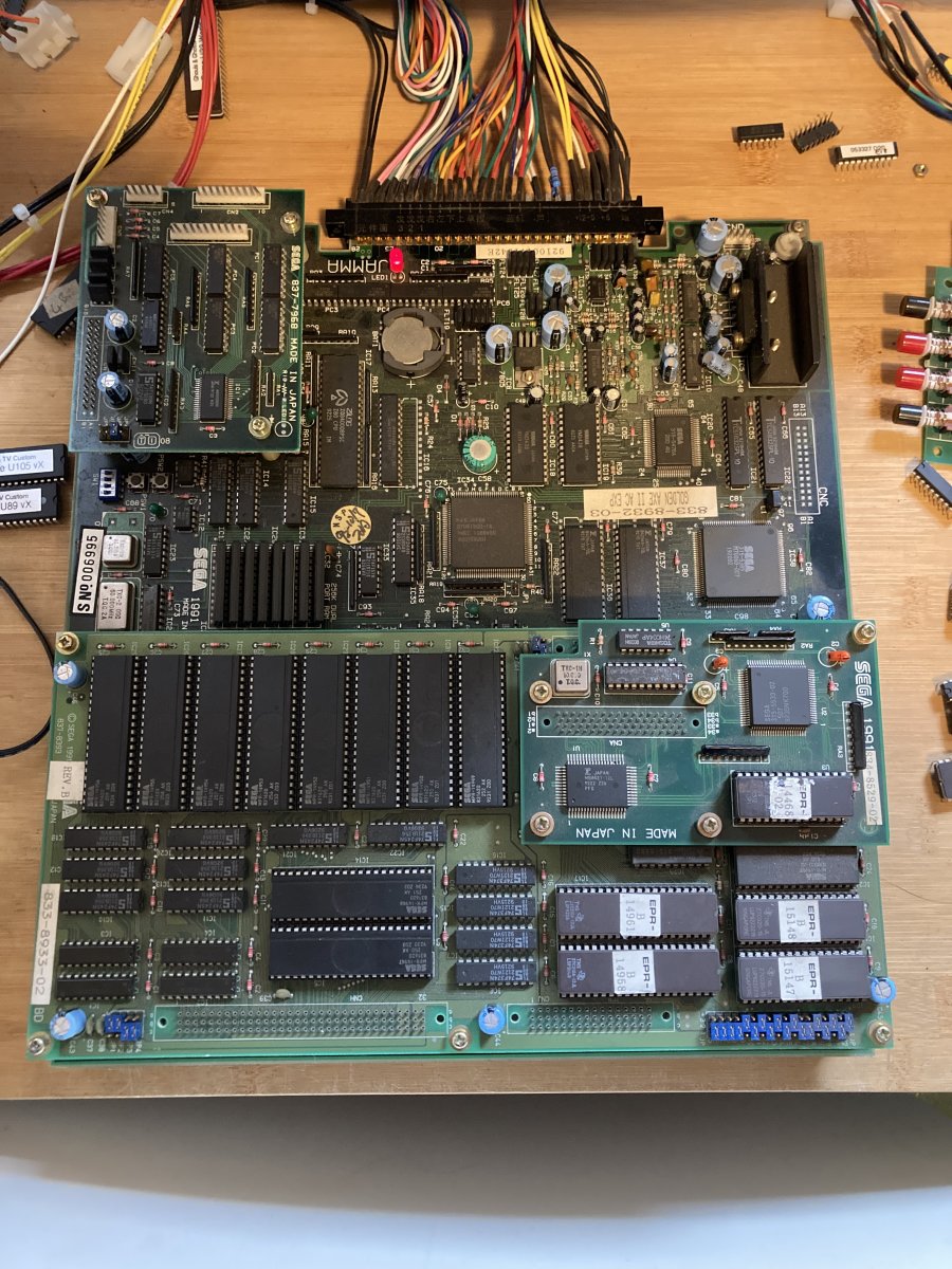

Hi
Got a black screen golden axe 2 board. Tried the decrypted roms idea and removing the extra security board. Made no difference unfortunately
I see pulsing on the roms addr and data but no activity on the rom board pal. Also the 27c020 roms oe line is high
Looking for advice on what to check next . Reset chip? Need type & location of it please
Hoping its not cpu failure :( :( As board itself is very clean
With my hacked roms it should be ruling out dead battery. The game waits for a value to appear in shared ram. Hacked rom looks at rom for this string which always is there :).
Does it reset the cpu(s) when booting? Might be waiting on the Z80. Any different rom boards or mainboards to swap and rule out?
Thanks for the reply, Yeah unfortunately this is the only system32 board I have, so this is abit of a walk into the dark! Interesting tech though and great work on the decryption stuff.
I'm going to check the reset stuff shortly, was hoping for a pointer as to the chip used for reset/steady 5v etc.
I will check the z80 to. Any info out there on a summary of how the boards start up etc, chip location and usage etc.?
Fixed It! :)
Bad PAL at IC51..
Weirdly the pal was also causing the reset chips at (IC11 & IC12) to malfunction, but once the pal was changed they were ok again. The current draw was 3.15a with the dead pal, and dropped to 2.75 a once back up and running. Only by using a separate higher spec power supply did I find this out.
