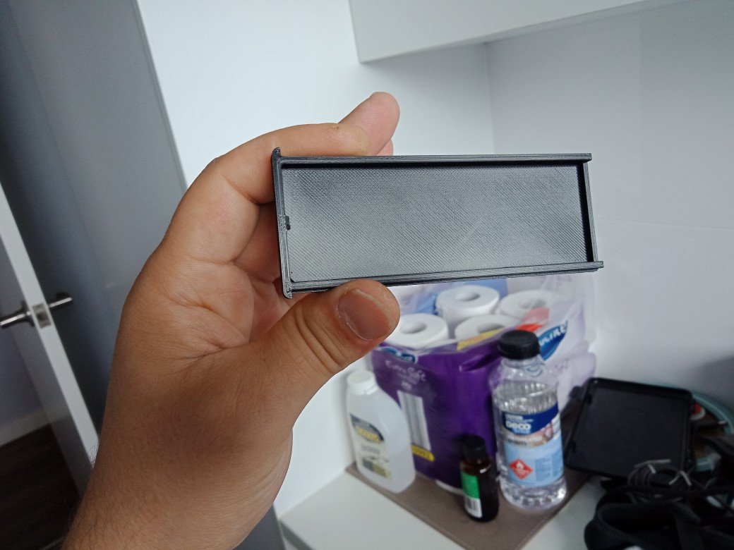

The lid printed okay, one little blemish on one corner where it lifted. Also the finish on the opposing side is tarnished due to the glue stick on the print mat. Guess I can't complain for a bottom end printer.
Printing the main enclosure now, fingers crossed.
Yup. To get the nice finish that my parts have, I print on high-temp glass with no brim and no adhesive because as you discovered, it ruins the finish... it's really finicky printing like this but is the only way to get the finish I get on the parts I make.
sharp corners will lift more easily than rounded corners so I design most of my parts with nice rounded corners, it looks nice and helps it print better too. The top of the CPS2 enclosure can withstand a little bit of warping and still work, it's the button holes that will give you grief if it warps too much. The bottom will need to be nice and flat though in order for it to slide into place.
The bottom looks like it printed nicely though :)
Yeah for the most part it printed really well. I might see if I can polish out the glue stains.

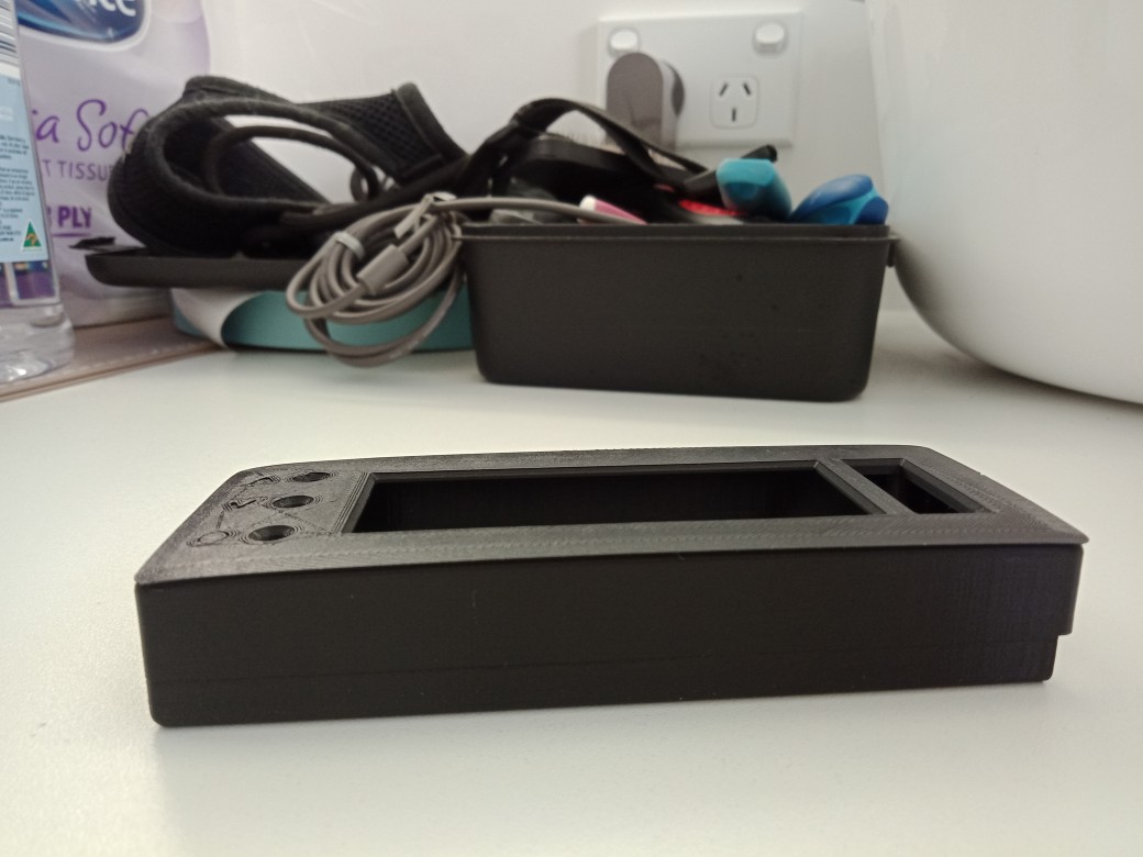

Printing the top now, this is doing great thus far with no lifting. My only gripe is the glue tainted finish.
I've loaded the settings into Cura as per manufacturer recommendations.
I'll keep practising, so many variables with 3D printing. Maybe with the brim it will print without glue.

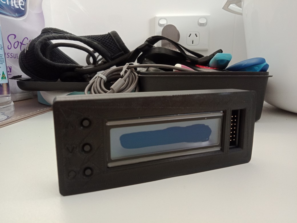

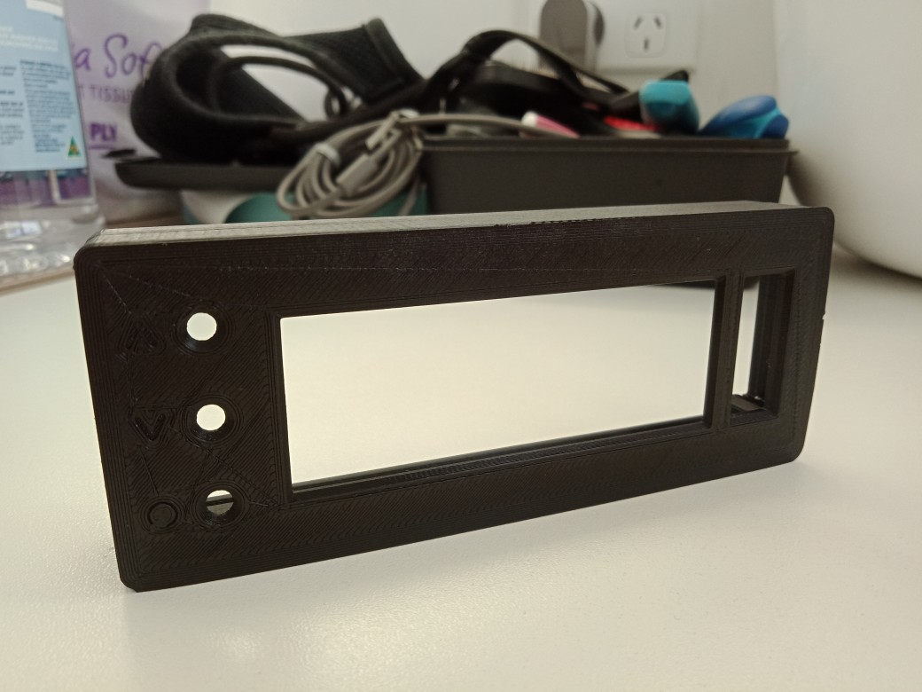

Not too shabby for a first attempt.
Button holes turned out great.
LCD fits in nicely.
Few imperfections which I can hopefully resolve once I learn more about 3D printing.
some advice here...
there should be a setting to not travel across print surface. In cura I think it's called combing and you want to set it to "no skin".
honestly don't know why every slicer isn't setup like this from default, it basically means that it's not going to route the print head across an already printed surface on a outer "skin"layer, and it should prevent those travel lines you see across the face of the part.
you'll want to also pick up a debur tool like this: https://www.amazon.co.uk/dp/B07BQNMGSJ/ref=sspa_dk_hqp_detail_aax_0?psc=1
this will help you cut off the brim and it does a way cleaner job than trying to use a xacto or razor blade.
it's also good good for softening sharp edges like prints with "elephant foot" (this is when the first layer sticks out slightly past the rest of the layers.
looking at your picture you could probably go a hair closer to the bed. or maybe your bed isn't completely level. if you notice the print lines near the buttons you can see gaps between them, on the first layer these should really be squished together into a single uniform surface seeing the lines separated like that is indicative of either temp on the first layer too low or not being close enough to the bed (or both)
I think your printer comes with a leveling program so maybe run though that and then see if there are settings in cura to adjust the Z-offset and first layer print temp. those might help with your bed adhesion as well.
Thanks man!
I'm just using default Cura settings at the moment so definitely room for tweaking and improvement. I've been given some settings that apparantly work well, by others with the same printer, so will see how that goes.
The levelling program just shifts the nozzle to each corner and asks you to put a piece of paper beteeen it and the mat. There's 4 wheels you turn in each corner to raise / lower the bed, then you're supposed to adjust so that the paper has slight resistance between the nozzle and bed. Definitely room for me to dial this in more.
Guess it's just trial and error. I'll keep experimenting until I achieve the results I'm after.
