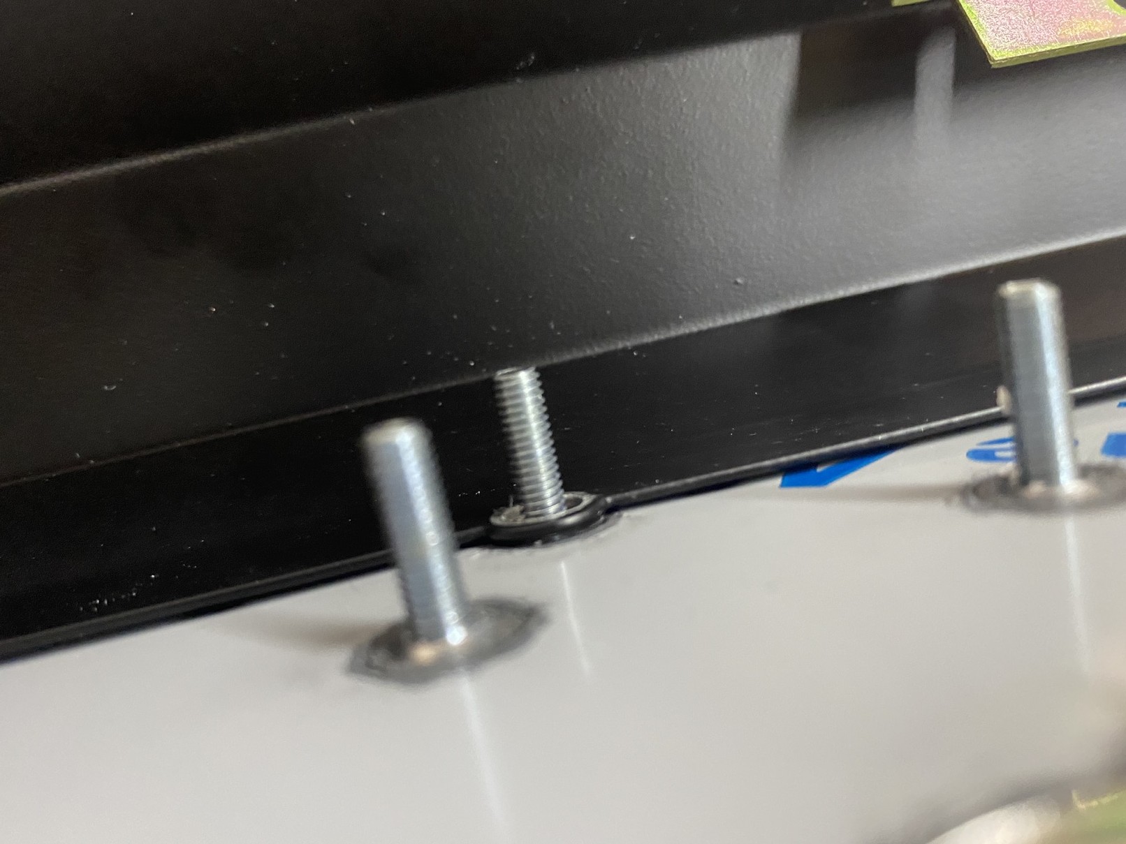

Fit is the category that I want to talk about most here here as I had seen some concerning stuff prior to ordering. Largely that the panel sits really high, and that, in some cases, the rounded edges were not enough for the panel to sit properly on the control panel assembly.

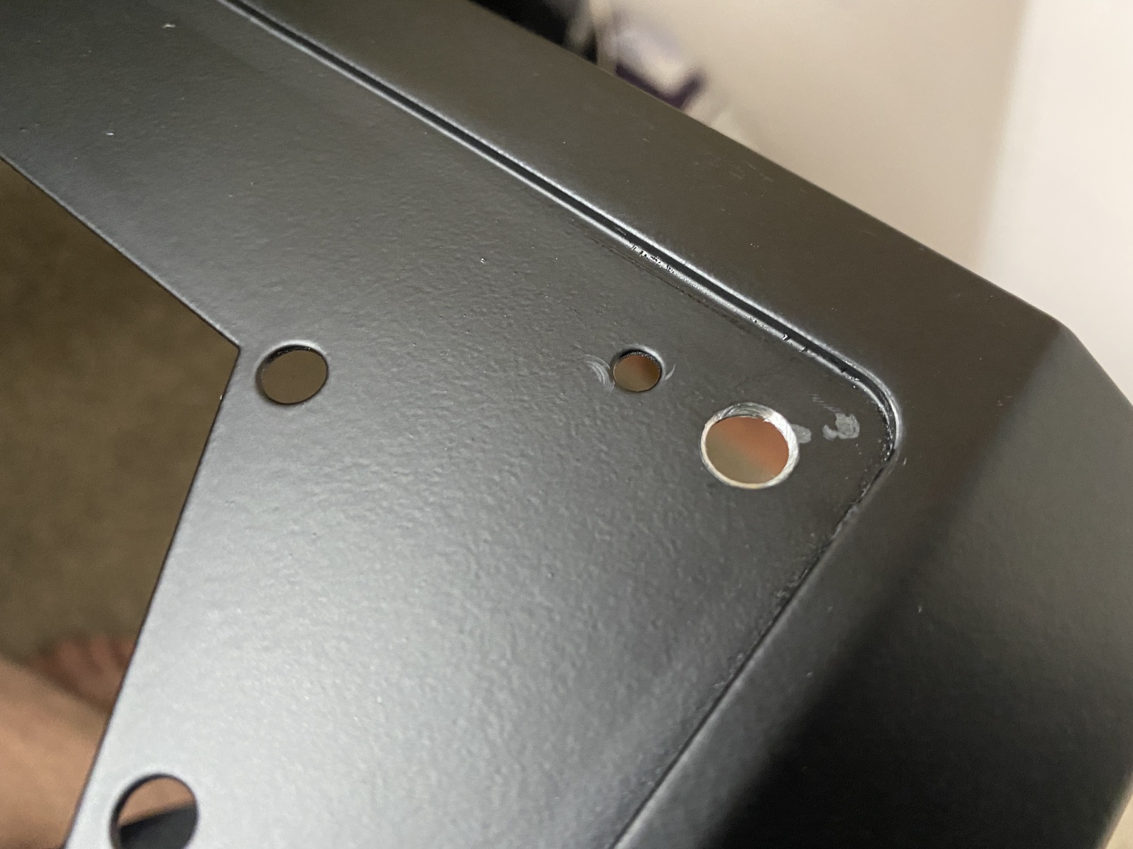

Mine did not fit the Chewlix well at all. This is where the * above comes in as the real Vewlix L panel also did not perfectly so I ended up taking a Dremel to the control panel housing and giving the standoffs some more space. Once this was done things fit a lot better overall.
The rounded edges were not an issue on my control panel. The height is a bit of an issue on my unit. Based on the measurements provided below, compared to the stock Chewlix panel, this is only about .6mm taller. That should be barely noticeable. The issue with the control panel here is in the standoff mounting points. There is an area of bent metal around each of them that accounts for nearly 1mm of additional height. That combined with the overall .6mm height increase leads to the unit sticking up around 1.6mm which is, in my mind, noticeable.
It certainly is not a deal breaker. I thought I would feel it more than I did. After putting it on the control panel housing it was barely a concern. Still there, but hardly noticeable.

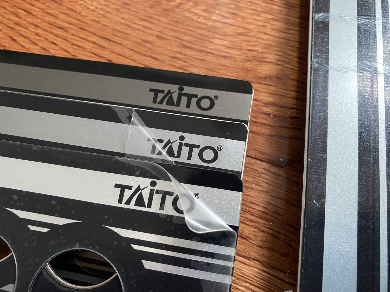

3 - Real Taito Vewlix L control panel
Going into this I expected this panel to fit perfectly, which it did not. This solidifies the thought that the Chewlix control panel housings are not a perfect match to a real machine. Maybe my Chewlix is a little off, but they certainly seen to be just a hair different. Construction of these units is superb. And the printing is as perfect as you can get. An interesting point is that the metallics are brighter on Rafael Tamanini’s replica panels. I prefer his level of brightness to the actual one.
This control panel sits perfectly flush once installed.
Measurements:
1.16mm metal, thick steel
0.57mm plexi + @.1mm ink + @.1mm adhesive
1.75mm total thickness
1cm M4 standoffs
