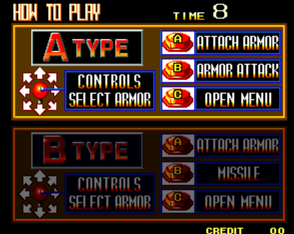

Almost everything works but I can't fix this screen and part of the sprite fixes.
I did some experiments on the mame to confirm that this screen is all on the S rom.
Instead of the correct screen I only see the time text and audio, the rest is black.
At moment i'm using J2 and J3 jumpers on cha board, and burned S1 on 1001
Already checked two times crc of S1 and its correct.
:S
Ok i got it work with another 1000 instead of 1001, how it possible i dont know since two pin are swapped in this socket.
