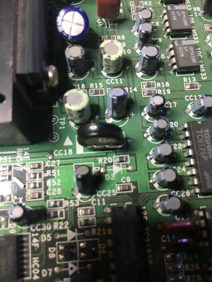

I’m pretty sure the audio issue is related to the supercapacitor on the pcb, I had that issue once and I think I had to change it out to fix it.
One of these guys (CC18)
Edit:
Not sure why it’s turning my 8 into a face with sunglasses on.lol
I had this issue on three separate cps2 boards. Ordered supercaps to replace them and ended up not even needing to. Somehow they fixed themselves?
I figured they recharged after sitting dormant for so long and finally getting some juice? Strange…
