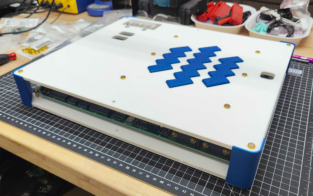

Just about done with a nice enclosure for this thing :)
What's missing:
- middle standoffs
- printed volume knobs that will mechanically connect from the board to the enclosure
- printed grommets for the dip cutouts
- better laser settings. Rough edges and burns that I'm very unhappy with.
(and, yes, I accidentally put the top plate on backwards during fitment...)

The case is looking really sweet!
It really makes sense for this one too, these jaleco are a fragile beast with those ceramic customs.
Looks like the lid is on wrong? (needs 180 spin so the heat sinks are above the text)
Indeed it is, I buttoned it all up for the test fit and didn't notice until after taking the pictures! :thumbdown: In any case, I appreciate the kind words. I intend to do a run of these after fulfilling the Primal Rage enclosures -- I'll post a link when that time comes.

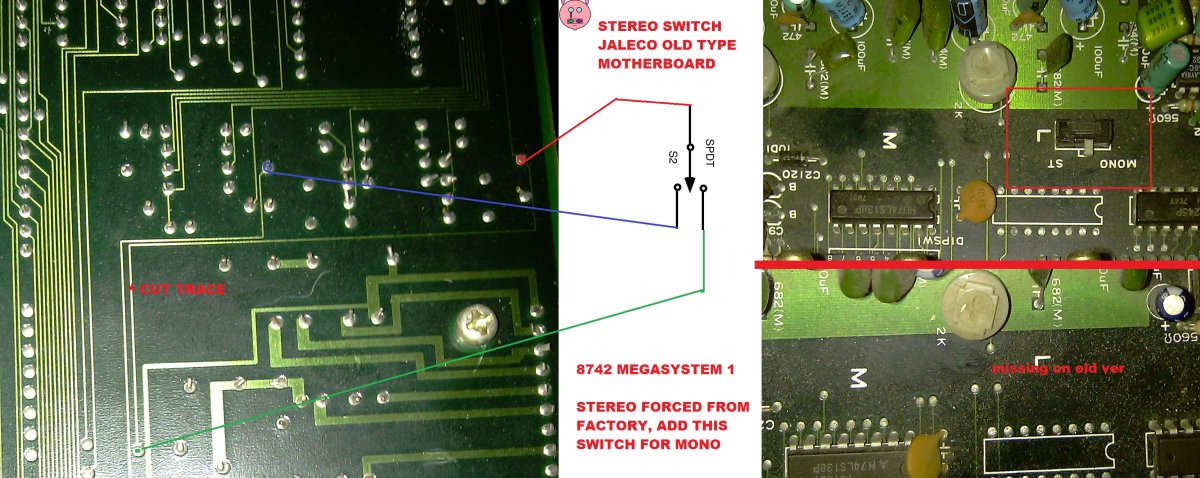

Found out why some boards sound bad - the stereo / mono switch is missing, attached is the mod to add the switch.
If you have the 8743 type then you already have the switch.
