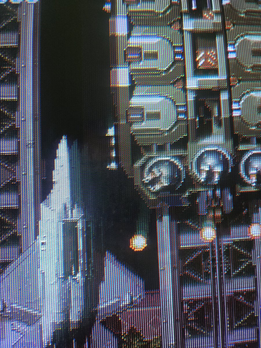

Wonder what its causing all that garbled image.

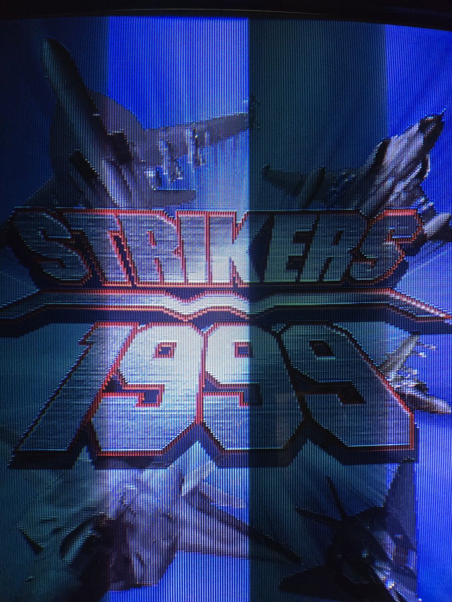

I can't find the repair form, but what I do remember from the form he wrote capkit installed and some trace or pads repair and cleaned. I guess I messed something up when I did capkit or something. But it was working fine after I did capkit and then, one day it just stopped turning on. Sometimes it turned on and sometimes it didn't. So I just shipped it to him before it got worst or for safe measure. In fact... yesterday when I was installing mame pc via jpac monitor dint have a glow or turned on. So I turned off and on again and it was fine. I don't know anymore.....
I didn't see anything new on my board that I could see.

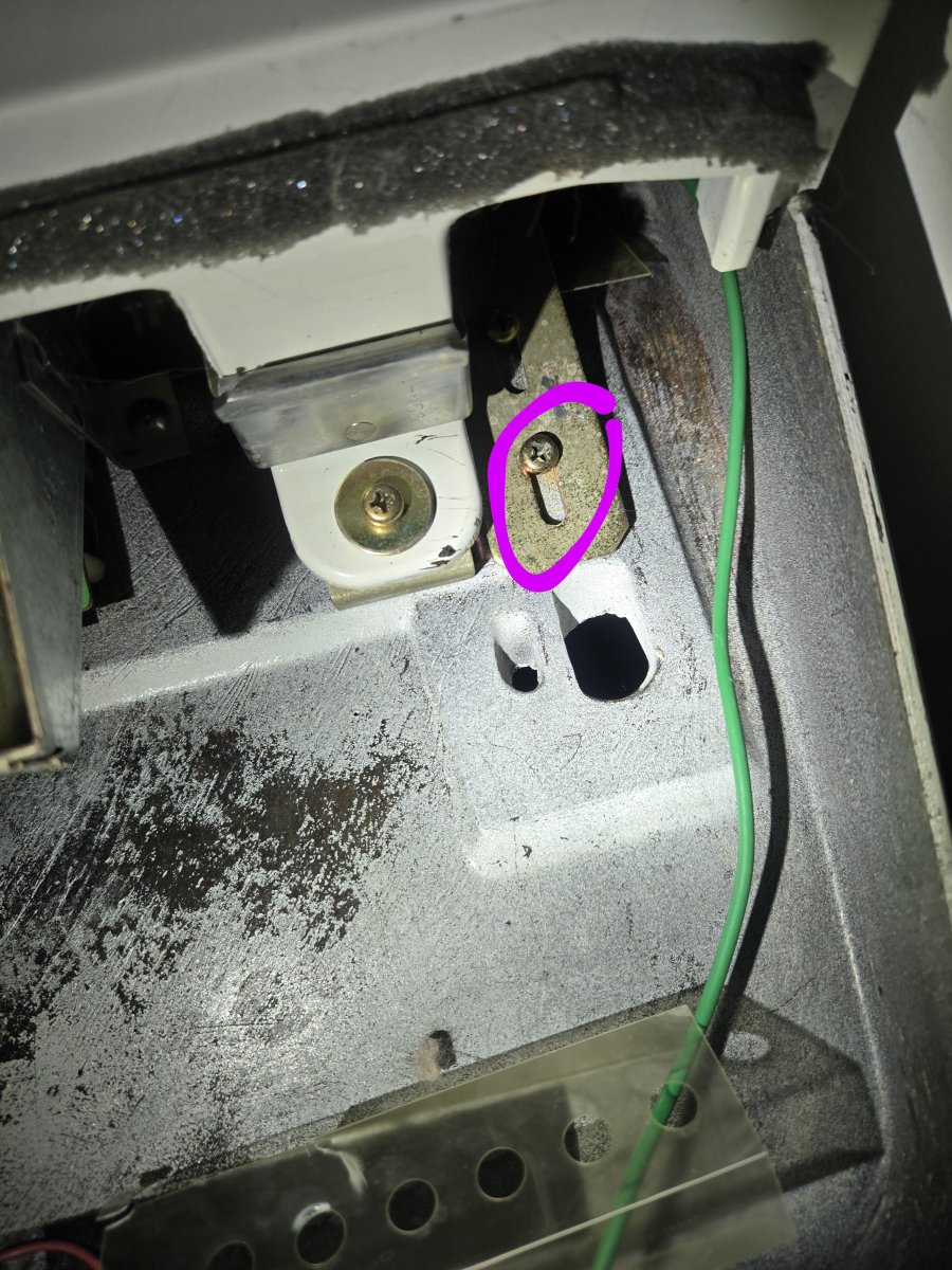

The only issue now was, I had a wavy video interference. That was fixed by removing ground wire that was attached to frame bracket, look at picture below.
now it finally looks fantastic again!!!!

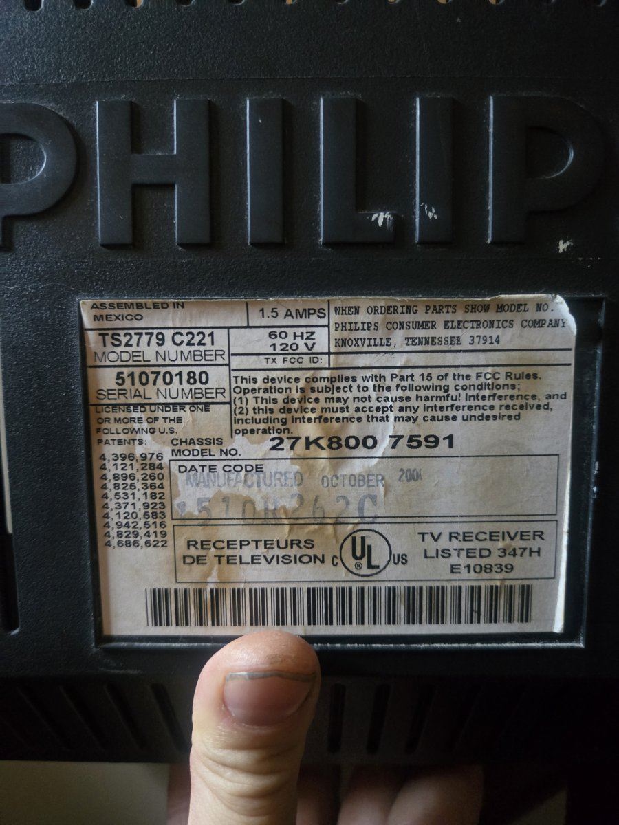

Now I'll put that ms9-29 in a donor tube I got a Phillips tube. I already know it works since the ms8-29 was in it and it looked so crisp. But decided to put back the toshiba monitor with ms8-29 it's got some burn in but damn it still looks good.
Here is the model tv for reference inCase anyone finds one:
