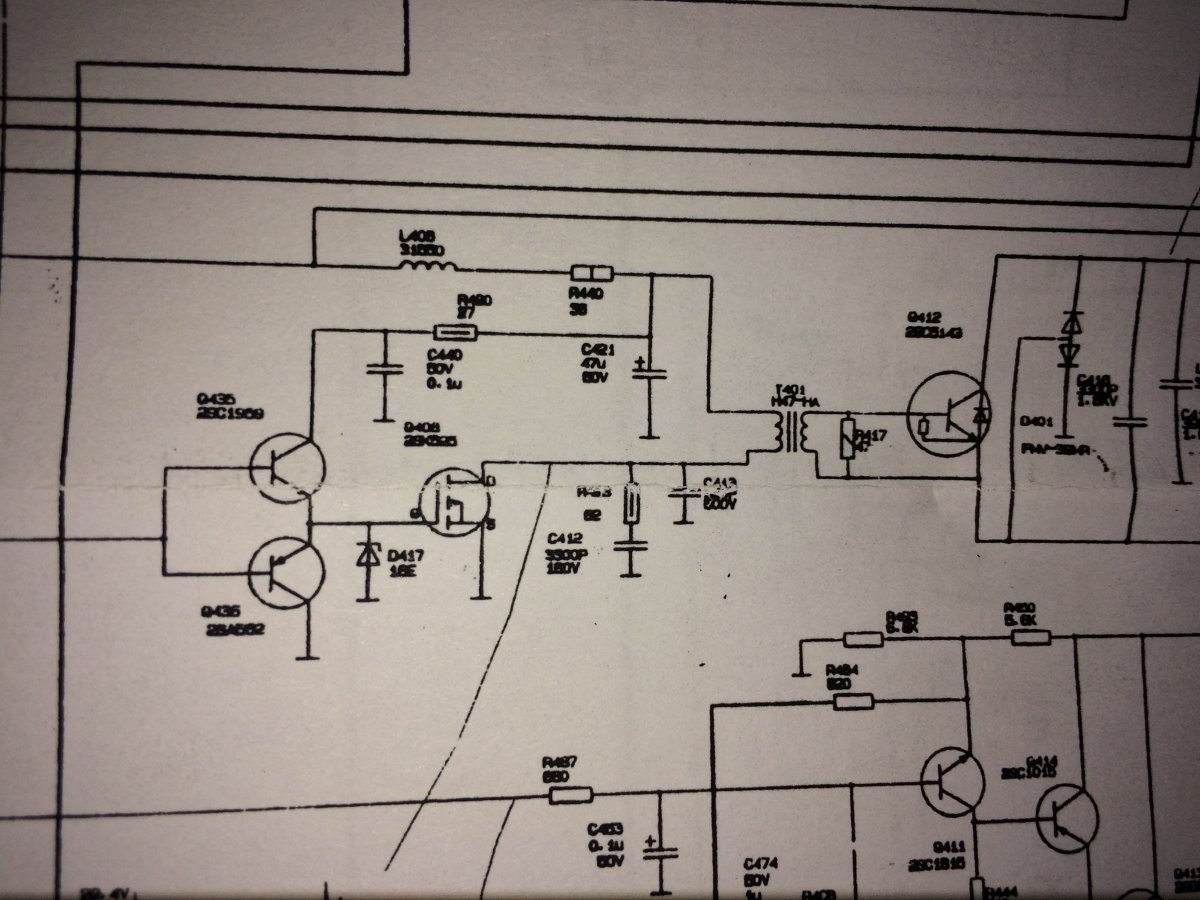

i need precisions on the voltage regulator that could be faulty. i dont want to blow another HOT.
is it the Q408, a 2SK525 Mosfet, Q435 a 2SC1959or Q346 a 2SA562?
thanks again
EDIT: if R546 was blown? what would be causing that besides HOT failure? any other possibilities. (I have another junk chassis that has this resistor swaped by previous owner and still showing severe signs of burn)
