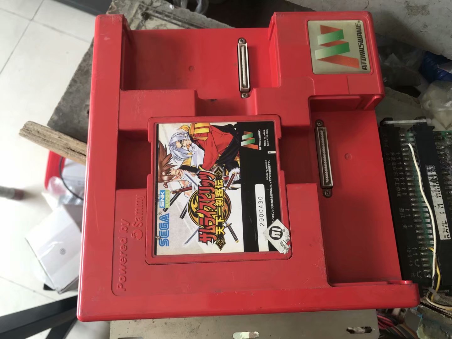

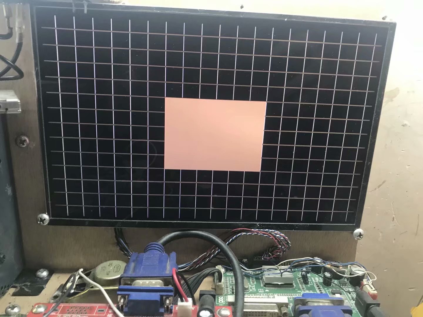

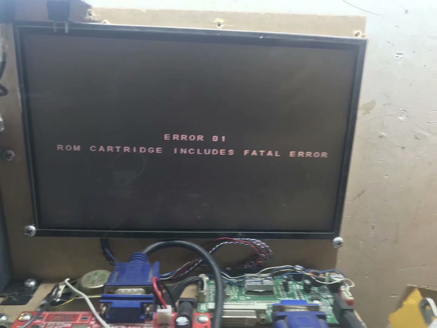

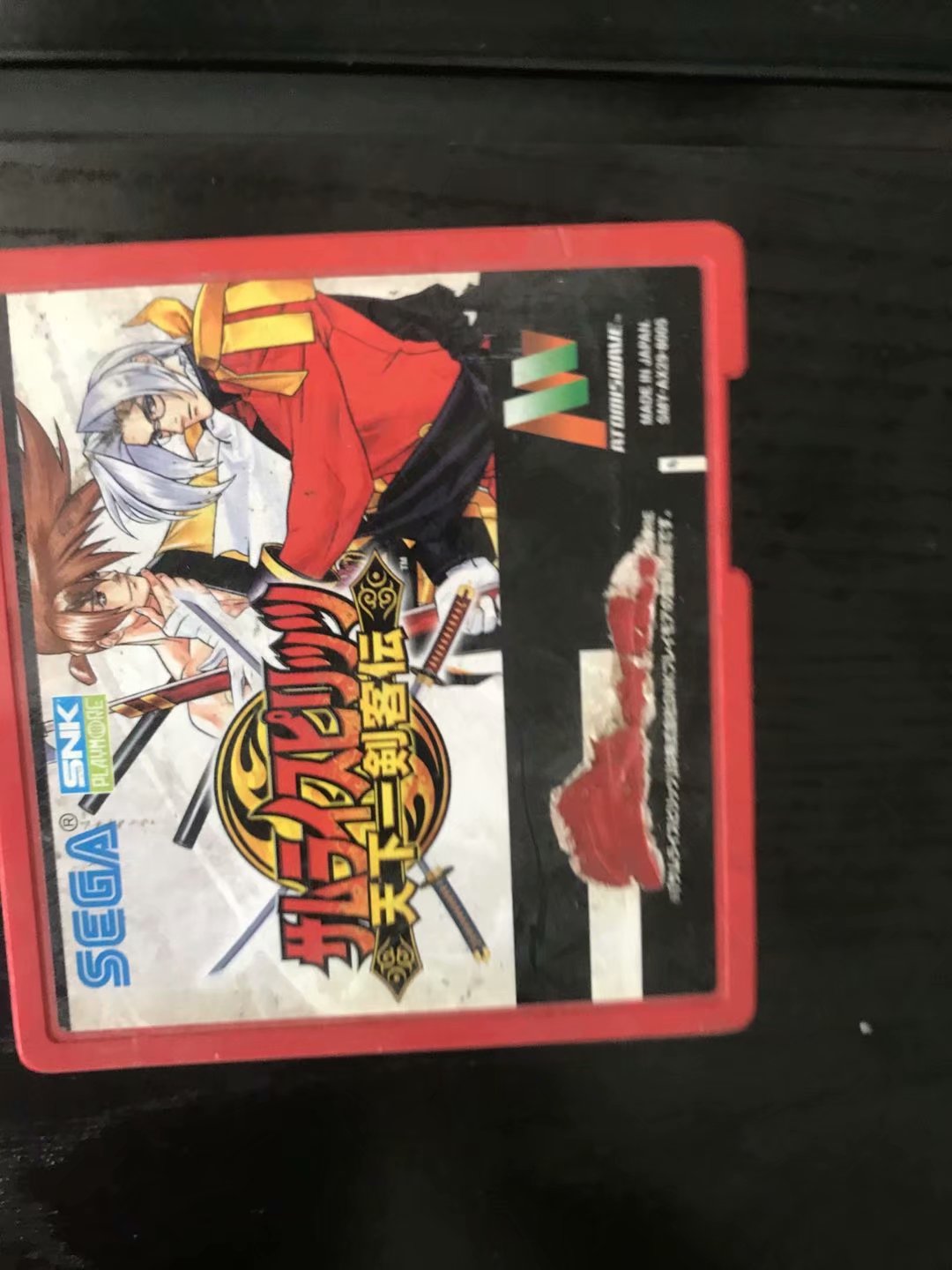

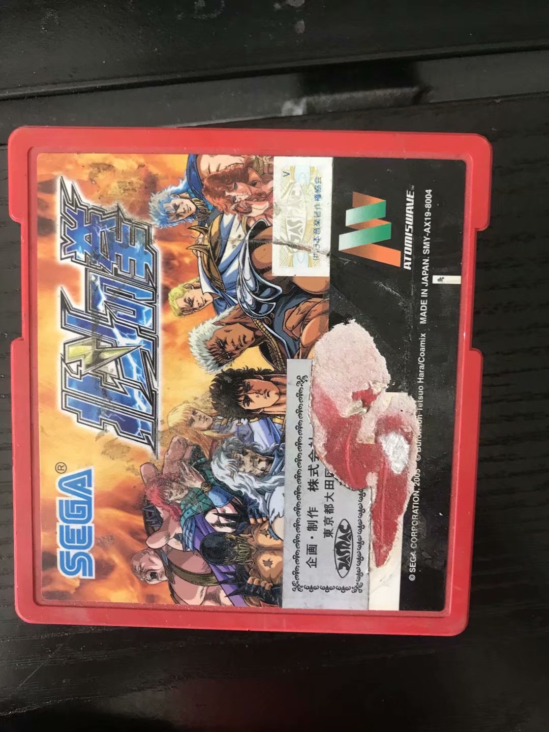

Does anyone who know how to fix the atomiswave original game card^+^.All the (2 pcs SS6+1 pcs Fist of the north star) game card were broken.
