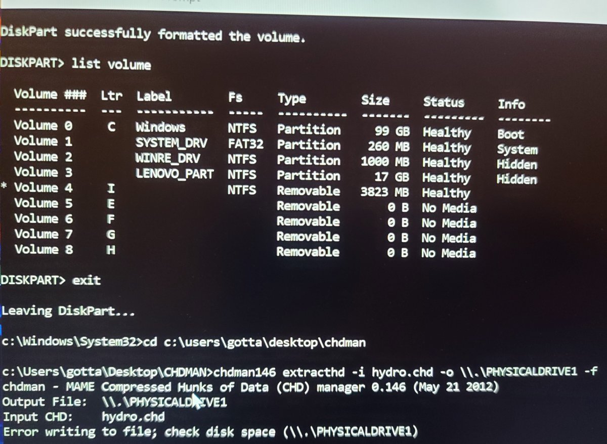

I'm out of ideas here. I'm trying to backup my Hydro Thunder hd and I can't get the chd to write to the cf card. Volume 4 is the target I'm trying to write to. I'm using a 4gb card and I keep getting the error below:
I've tried doing the "clean" and "clean all" commands in diskpart and after it says the partition has zero usable bytes. As shown here:

Try unpacking the chd to a disk image and then imaging that to the CF with HDD Raw Copy Tool.
chdman extractraw -i game.chd -o game.img
Also, what's the resulting file size of game.img? Is it 4gb?
At one point the Hydro Thunder chd unpacked to a 20gb image. I remember that creating issues for many. This was years ago though.

The original HD is just a bit over 3GB, the unpacked image is 3,153,024KB. So I used the method you mention above and everything copied over and when I compare the HD to the CF card, partition structure and file structure look identical but the CF wont boot the machine when I turn it on. I have the adaptor plugged directly into the ide port (eliminating the cable) and have the power to the adaptor plugged into the same power connector the HD was plugged into, the LEDs on the adaptor light up but I get absolutely nothing on the screen. Possible bios issue? I've read that it shouldn't need any changes but I don't know what else to check.
