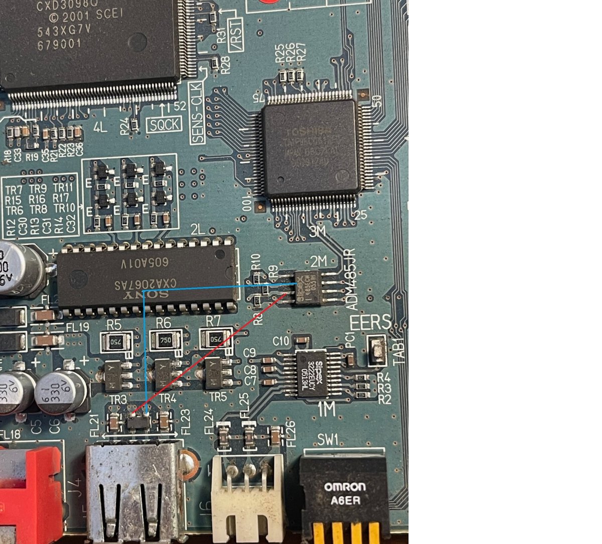

How's this for super system256? (time crisis 4)
It's my way of asking help for this :D :
You mentionned
in a nutshell, you'll have to check for continuity between USB pins 2 and 3 and the ADM485 or if you really want to, bridge ADM485's pin 6 to USB pin 2 and pin 7 to USB pin 3 with thin wires.
In effect, you are asking to bypass that little black component before the pins? (anybody know what it is?) cause I can ping to that but not through it ?
is that correct?
