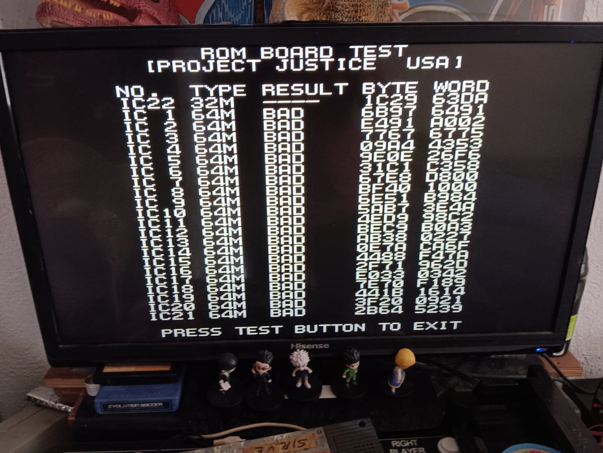

wildcratos Beginner Joined Apr 21, 2025 Messages 5 Reaction score 0 Location Mexico Apr 23, 2025 #1 I dont believe im so unlucky to have all bad chips, any suggestion is greatly appreciated Attachments Imagen de WhatsApp 2025-04-21 a las 12.44.17_7548fdb9.jpg 184.4 KB · Views: 65

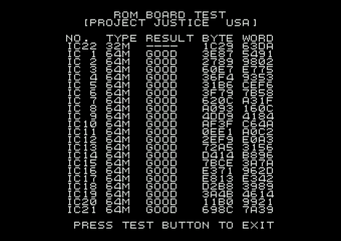

nem Immortal Joined May 29, 2016 Messages 7,700 Reaction score 8,407 Location Finland Apr 24, 2025 #2 I assume there's something wrong with the protection chip. Cart does not run, right? Here are the correct checksums:

wildcratos Beginner Joined Apr 21, 2025 Messages 5 Reaction score 0 Location Mexico Apr 24, 2025 #3 i really dont know, this the first time attempting to repair a naomi cartdrige, i have check de buffer chip but seems to be fine. The cart just show the now loading message and reboot
