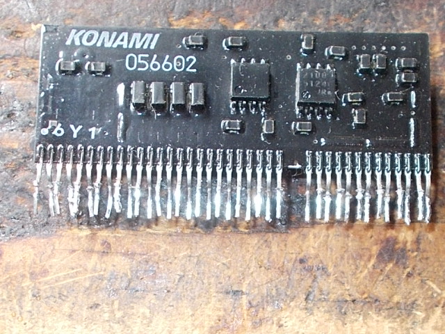

As for the lack of audio I suspect the '056602' ceramic module, I attach a picture of it
I had a quick look at it, it's essentially a DAC plus a pre-amplifer section, it could be reproducible so I put it on my TO-DO list.
By the way, I recetly reproduced another Konami GX custom, the '056820', it's a sort of video amplifer but it provides also +5V to the VIDEO DAC, this is reason why it gets very hot (I guess dissipation is not enough)
Thanks for the analysis. Is there a good way to test/confirm if either of these modules is the culprit?
