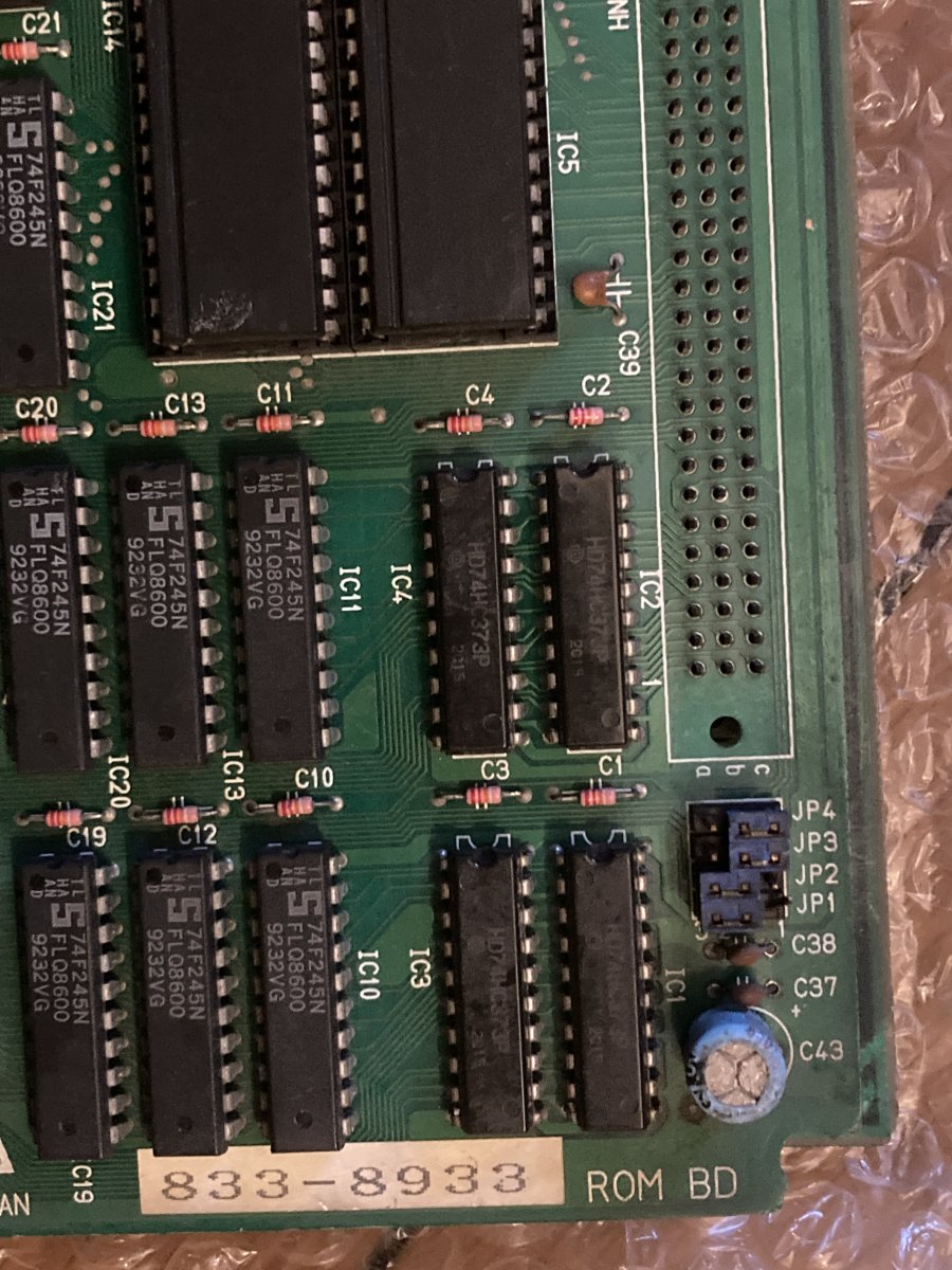

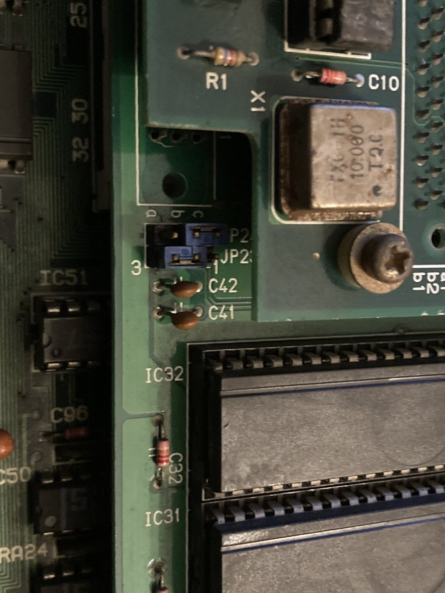

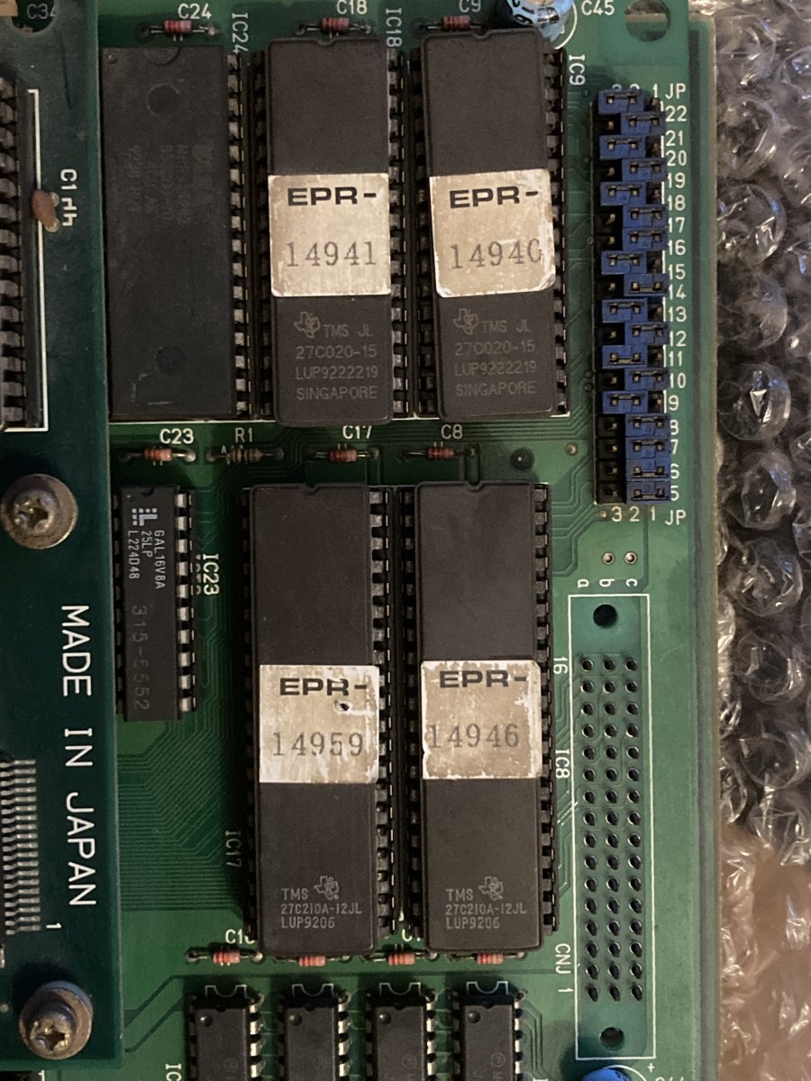

Hello,
I'd like to know if there is anybody around here with the japanese version of this game? I do have the US version, I replaced the 4 eproms that (according to mame) are the difference between both versions and I end up getting a blue screen. AFAIK, the security eprom is exactly the same, so I want to cofirm this and the jumper positions.
Thank you.
I have it somewhere in storage. If Im able to get it I can check and take some pics.
But Im sure some other members that have it handy or have knowledge on this will help you out before I can get to it.
Hi, here are some pics of the jumper settings of a Japanese RODA ROM board.
I hope that this is going to be helpful.
