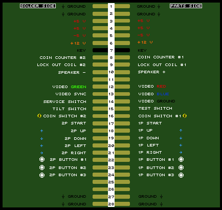

After powering a board, use a multimeter and touch the black lead to ground and then the red lead to 5v on the Jamma edge. The power section on the Jamma connector is the smaller 6 pin section. Turn off the power, adjust as necessary using the pot/knob on your PSU and re-measure.
When measuring voltages, make sure your black lead is always on one of the two pins at the very end of that 6 pin section. Your have to be careful when doing this to make sure you don’t bridge any of the pins which can cause smoke.
