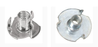

Mdf will need anchors like these and use of machine screws:

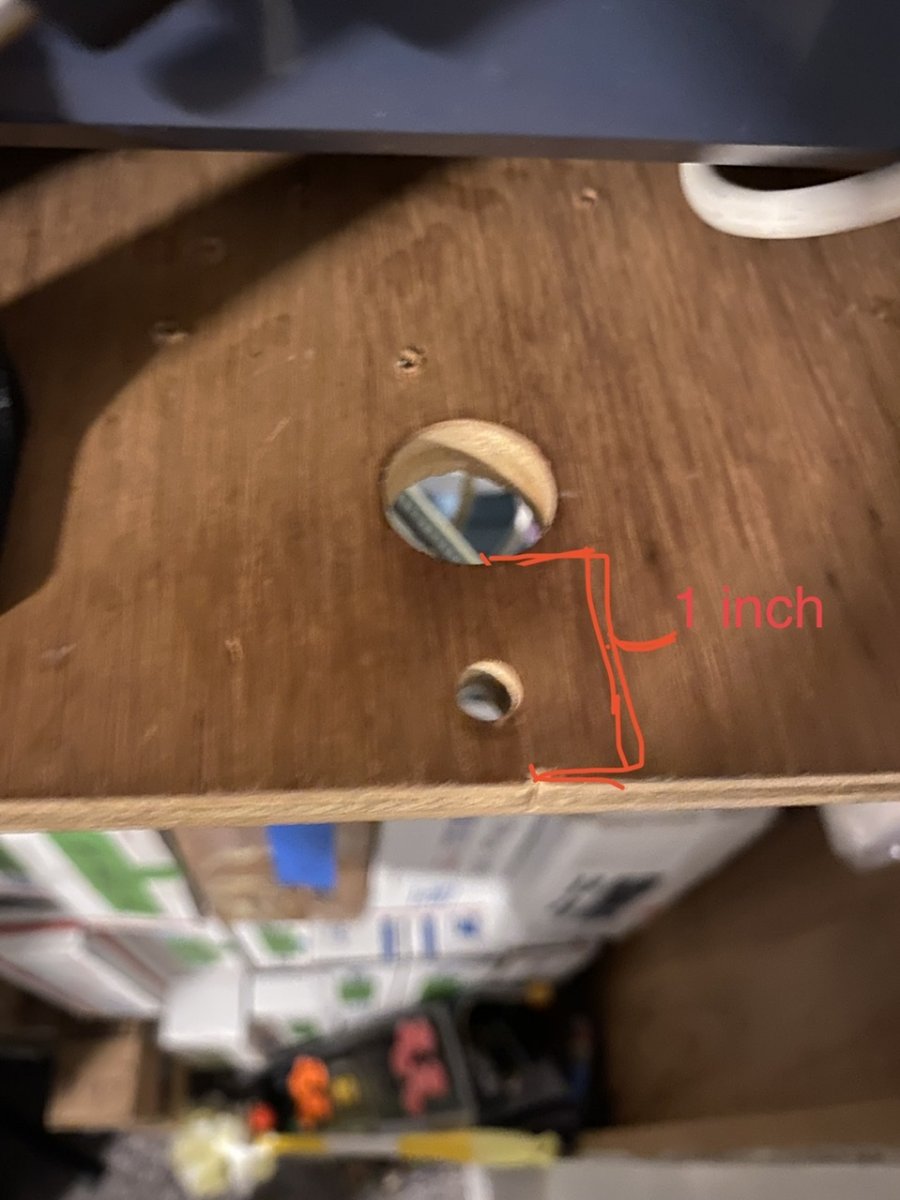

The boards in my NAC and Aero City are plywood. If you need dimensions I can measure the NAC board for you.
If it's not too much trouble. Also the diameter of the circle for pulling the board and distance from the edges. There are some measuremants on this page not sure if accurate:

yeah that page is fairly accurate. It might very from cab to cab tho.
Mine measures at 15 1/4” x 19 5/8” @ almost 3/8” thick.
The hole is 3/4” diameter.
Positioned 1” from the edge in the center of the board.
CorrectThanks! I assume that other hole is for the wing nut to lock it in place/stabilize?
