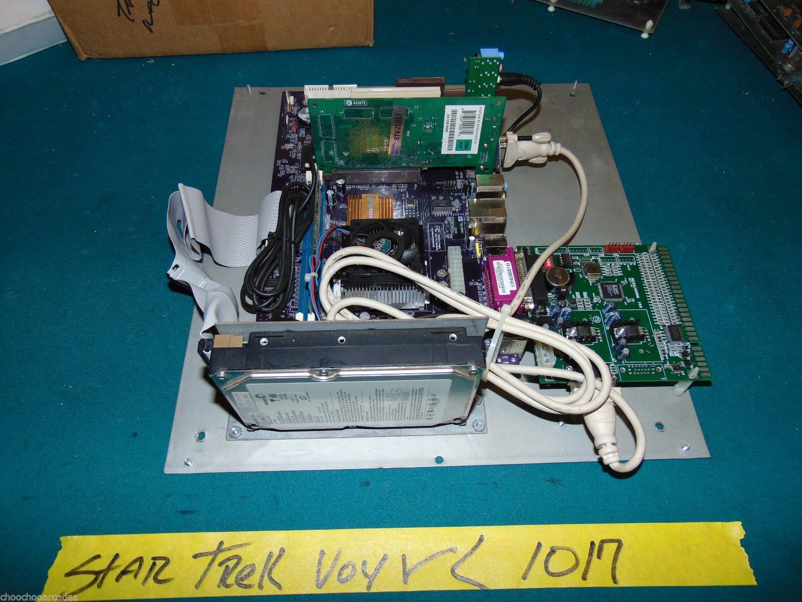

I am guessing you mean the small board that connects to the parallel port of the motherboard for Star Trek Voyager (referred to as the Mega Jamma board by Team Play) when you refer to the gun board. The only time I have not seen that included is when it was just the bare motherboard and no cpu, ram or other pieces.
If the tv (Standard Def) I have has component video (Red, Green and blue), would there be some way to wire it from the jamma harness to a set of component cables and thus keep the sync right so the gun will work?
I might try to see if the tv will since to 480i or lower signals over ypbpr component using my ps2 at some point since I know the system can output lower resolution signals over that connection. The tv seamed to not want to sync to 480p.
I suppose they call it the "mega jamma" because it says "mega jamma" on it. the VGA would connect through this not just for the video output on the JAMMA edge connector but also so it can sync up with the light gun signal. I'd venture a guess that the trigger signal and light gun position data is passed in through parallel port.
As for video Component Video is not RGB. while the wire colors for Component are indeed Red Green and Blue that's not what they carry for data.
With component video the Green cable carries the composite sync signal as well as the luma signal (the black and white image), while the Red and Blue Cables carry chroma signals (color) A More Technical abbreviation for Component video is Y Pb Pr which represents the luma/sync (Y) and the color data (Pb Pr). an "RGB" connection actually has 4 or 5 wires, Red Signal, Green Signal, Blue Signal and Composite Sync Signal (sometimes Separate Horizontal and Vertical Sync Signals).
Theoretically you could convert the analog data from an RGB signal to YPbPr (Composite Video) on the fly such that the sync signal would remain intact. but there are several other problems with this.
1. Most games are not going to be providing a 480i signal, they're going to be providing a 240P at best, or at worst a non-standard resolution such as 244p or 200p. A US spec Component capable TV likely wont accept this signal.
2. Voyager in particular is Medium resolution which has a 24Khz horizontal refresh rate, which is way faster than the 15K you'd get with an NTSC/480i signal and way slower than a 31K VGA or HD signal. I don't believe is even covered in the component video spec and I highly doubt any consumer TV in the US market will sync with that.
3. Nearly every Component capable CRT in the US (at least every model I know of) is a digital set that produces internal Scaling, this means that even if you feed it a proper sync signal, it's going up-scale the image to a higher resolution and destroy your sync signal in the process. They're about as useful for Light gun games as LCDs are.
The short of this is... if you want to play Voyager, you're going to need to buy yourself a Medium Resolution CRT, 90s racing games are a great source for these monitors. If you're super lucky you might find yourself a high end Sony BVM that supports medium resolution. but these are incredibly rare, and only 20" in size, which wont be much fun for light guns.
