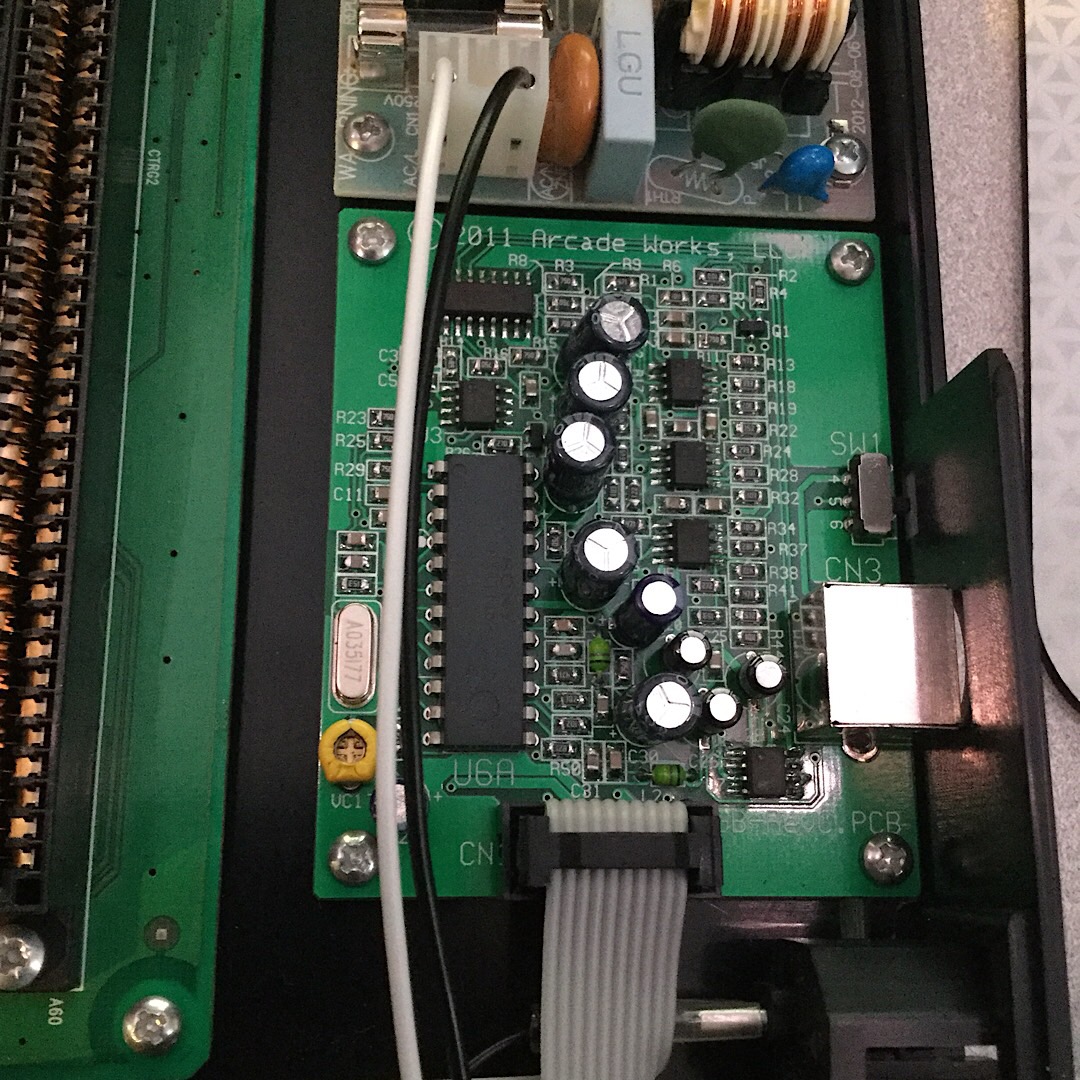

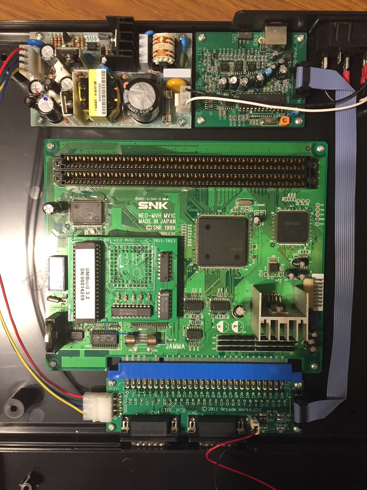

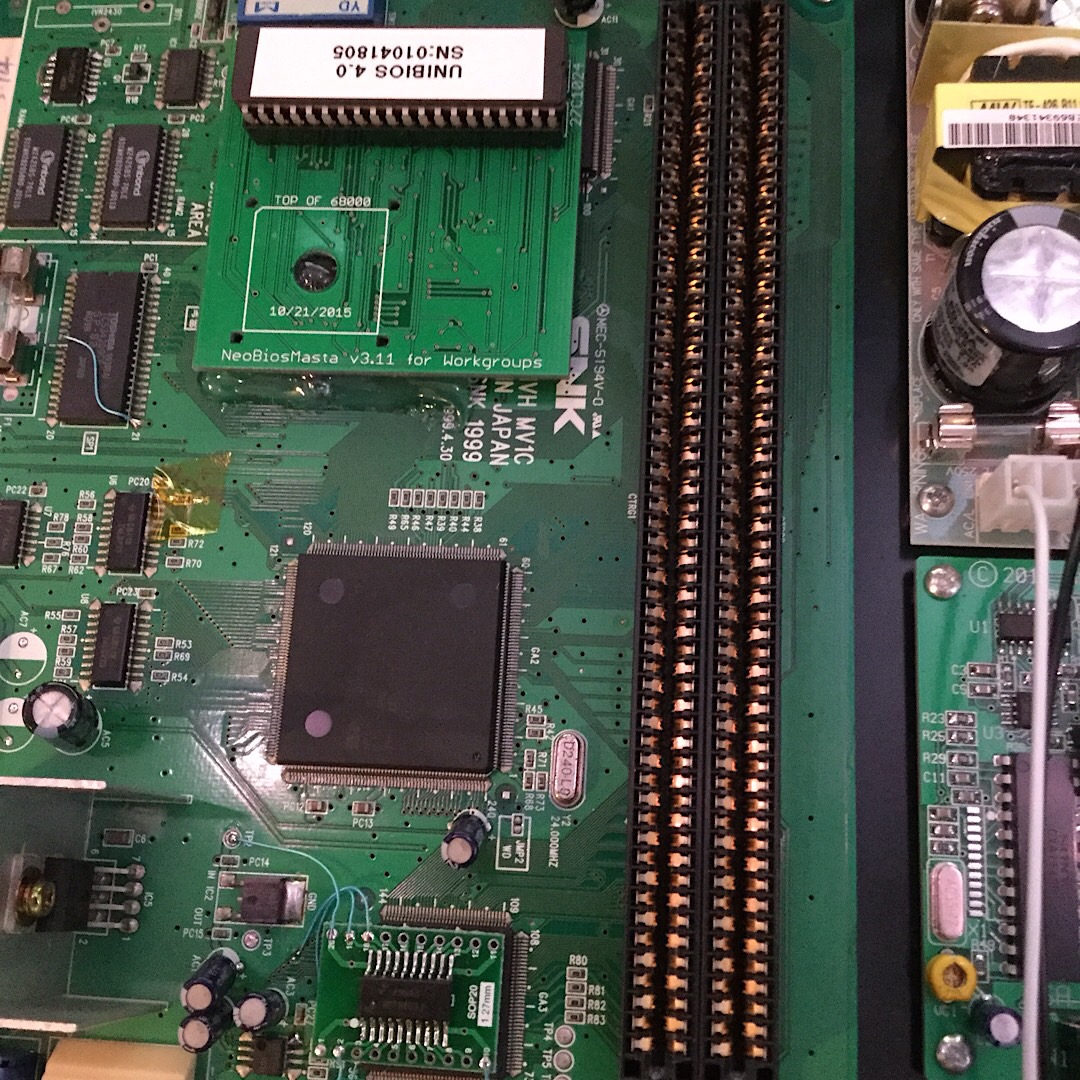

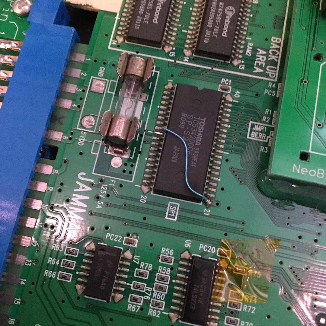

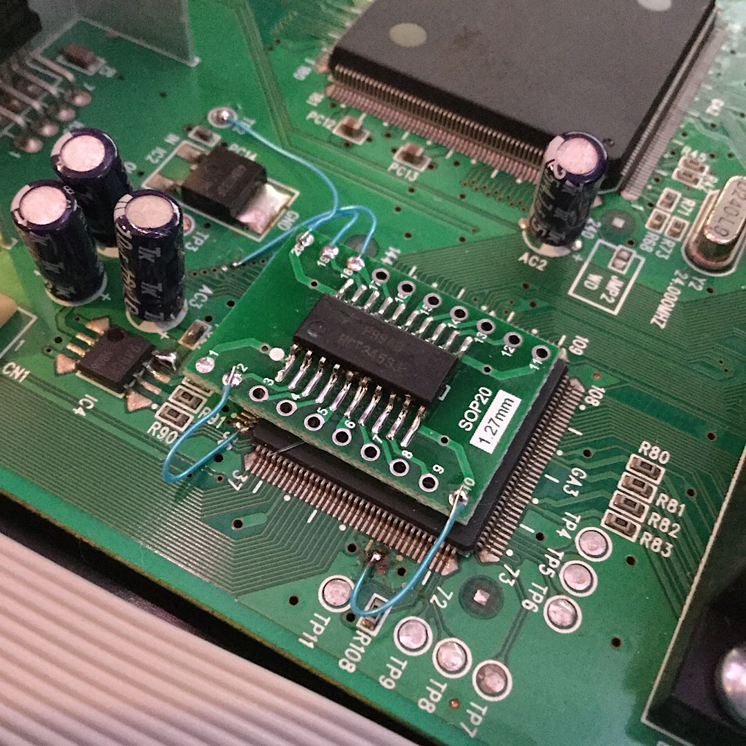

Recently got one of these and it has issues. Games reset after less than a minute of gameplay or lock up. Opened it up and I don’t see any obvious issue. Anyway it’s kind of fun to see what components were used. I’m not sure what all the little wires are doing. I’m guessing you guys probably understand what all is going on here to consolize this thing. Anyone spot anything that looks like it could point to my problem? I’ll take more pictures tonight. Let me know if more detail in a particular area would help. I’ll prob end up sending it back for repair.

Here's the insides of my Omega. Yours seems to have extra repairs and modifications that mine does not. Maybe you could source a clean MV1C board and swap it in? Or contact Quan at ArcadeWorks and see if he'll swap you out.
