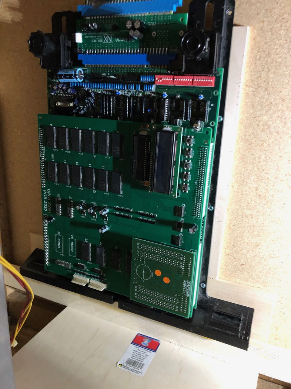

I find myself with a Chinese multi game CPS1 board. Soft dip settings are lost when it powers off, so I’m wondering if I can enable free play via the hardware dip switches or if they do different things on different games.

Only one I guess I'm really concerned with is free play, Which is C3 for Street Fighter 2 but C4 for Strider... so guess I'm boned.
Just change it when you’re changing games. Flicking a DIP switch isn’t a big deal really?

Would require pulling the cabinet away from the wall and opening the back. Cab' is setup with four different boards so far, everything else is operable from the front. Having to put in a token isn't the end of the world, I would just prefer free-play.
Edit: In addition, the system doesn't remember the last game I had it on when it loses power. It always reverts to a hack of Street Fighter Alpha. I can change it with a remote, but I would need to reset the hardware dip switches whenever I power off the cabinet.
In that case, there’s not much you can do then. Perhaps set the most common CPS-1 DIP for free play and then use tokens for the rest of the games. Or you could easily install a credit button for convenience.
