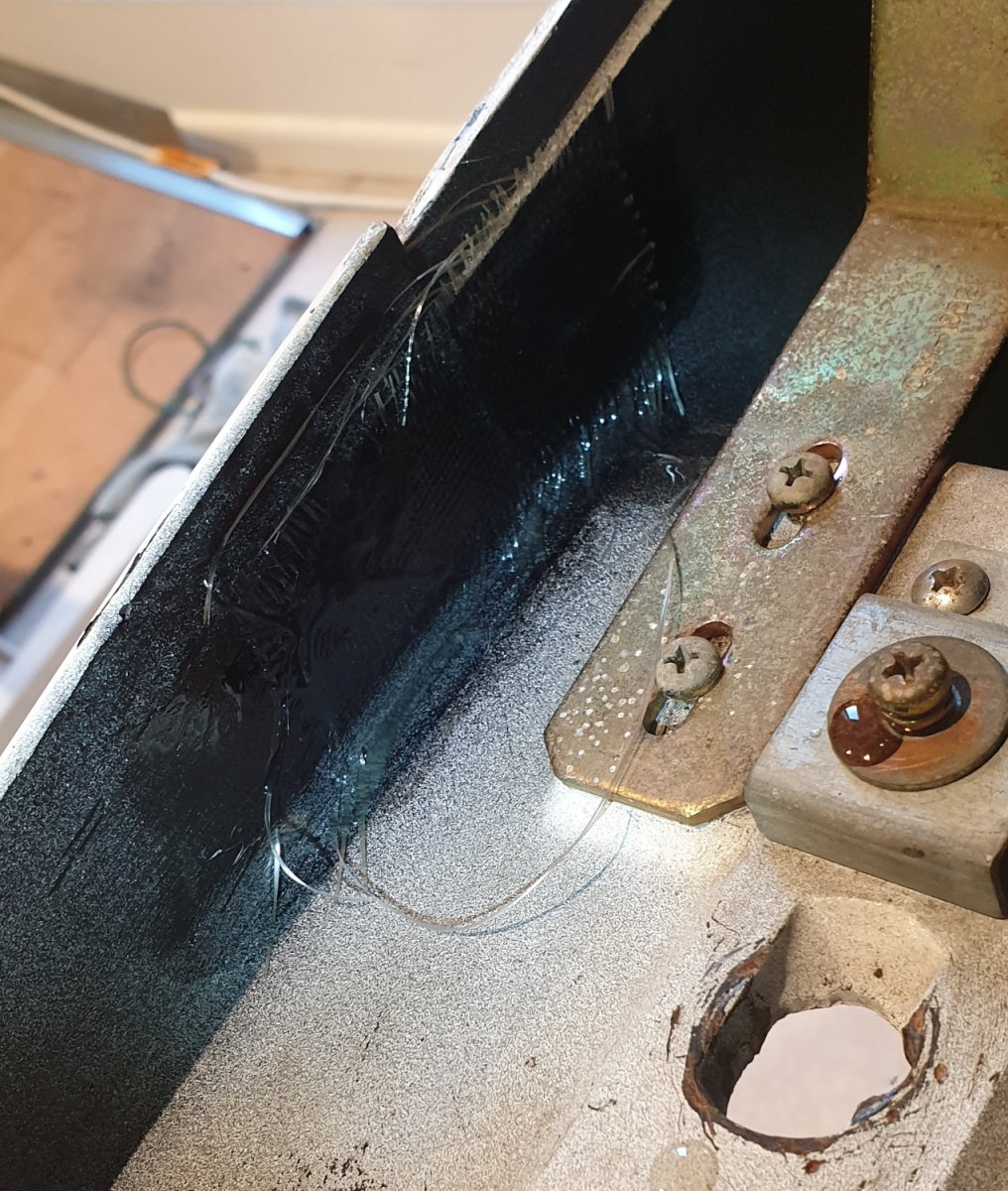

So, an update. After the last fibreglass layer was applied I decided to stress test the machine before painting it, in case the crack came back. And here we are, a month later, and it's still holding! After many hours of enthusiastic play, and at least once forgetting that it was possibly fragile and putting my weight on the corner of the panel while crawling beneath it, there's been no movement.
So the next step is sanding and filling the outside, then painting it.

There's not really much to it. I used a straight weave (90 degrees crossover) glass matt, because I knew the direction of the stress and I wanted to maximize the strength. The scramble weave is more omni-directional. I used some coarse sandpaper to rough up the inside of the cab, and then it was just resin, fibreglass, resin. Wait 2 days, sand it LIGHTLY (so you don't tear any fibres) resin fibreglass (at 45 degrees to the first layer) resin, wait 2 days, and one final layer in line with the first.
Fibreglassing is easy. It's sticky as fuck, wear nitrile gloves! And it smells awful. And sanding it puts glass fibres in the air so do it outside.
Beyond that? Nothing to it.

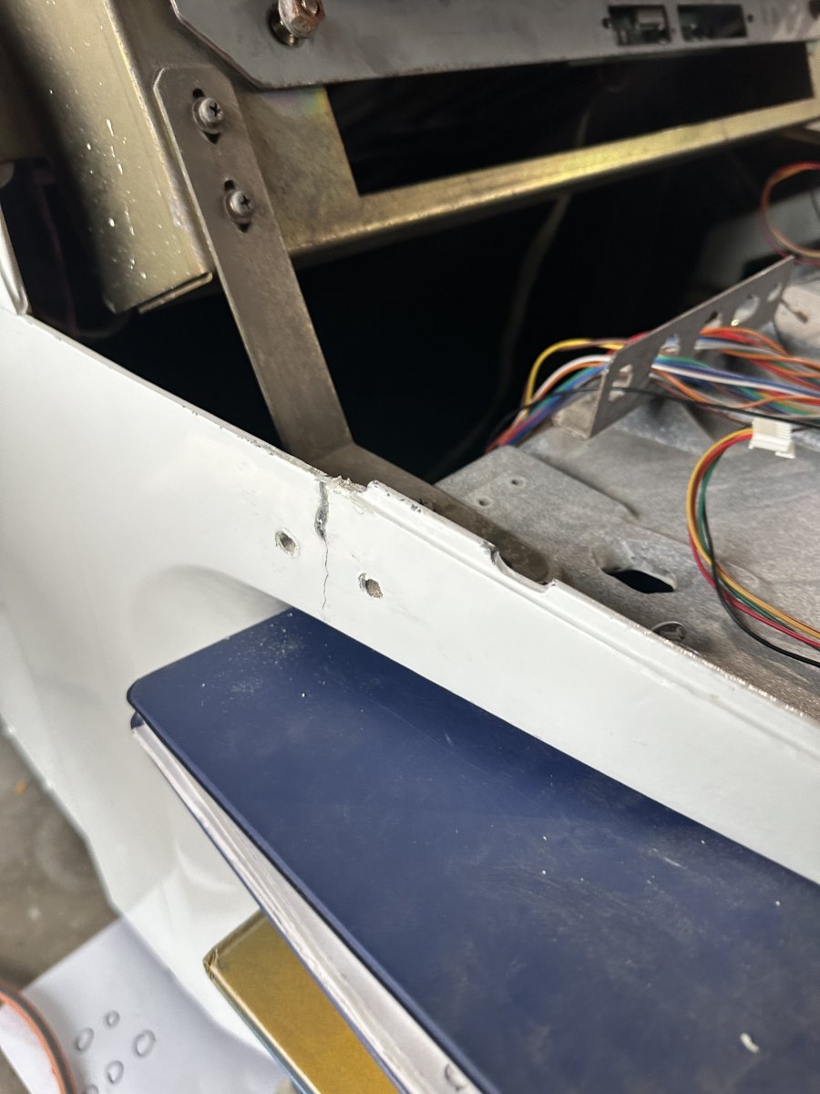

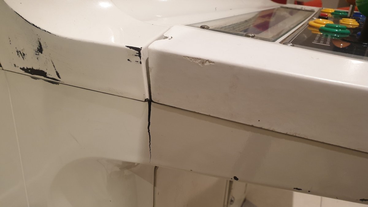

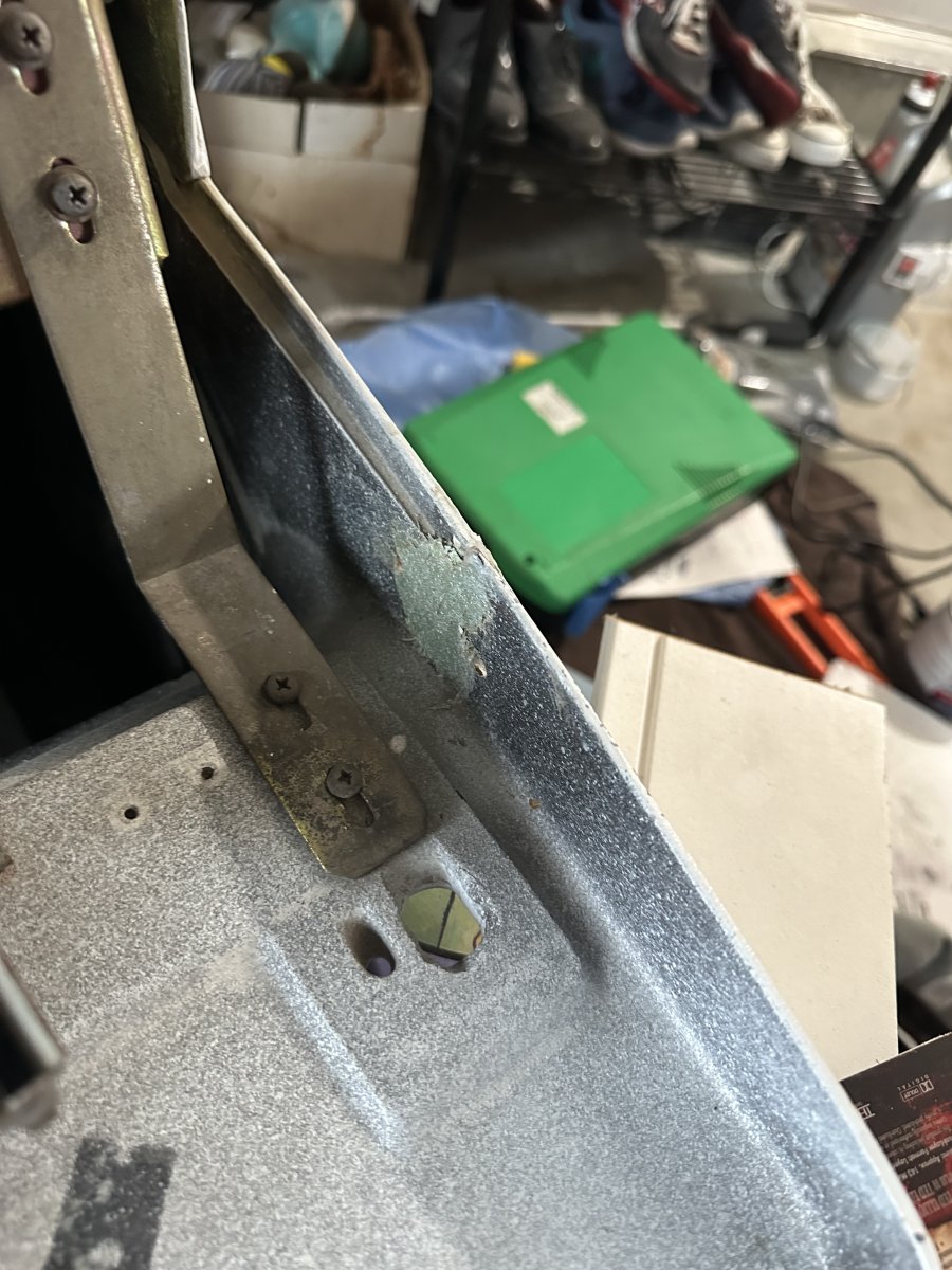

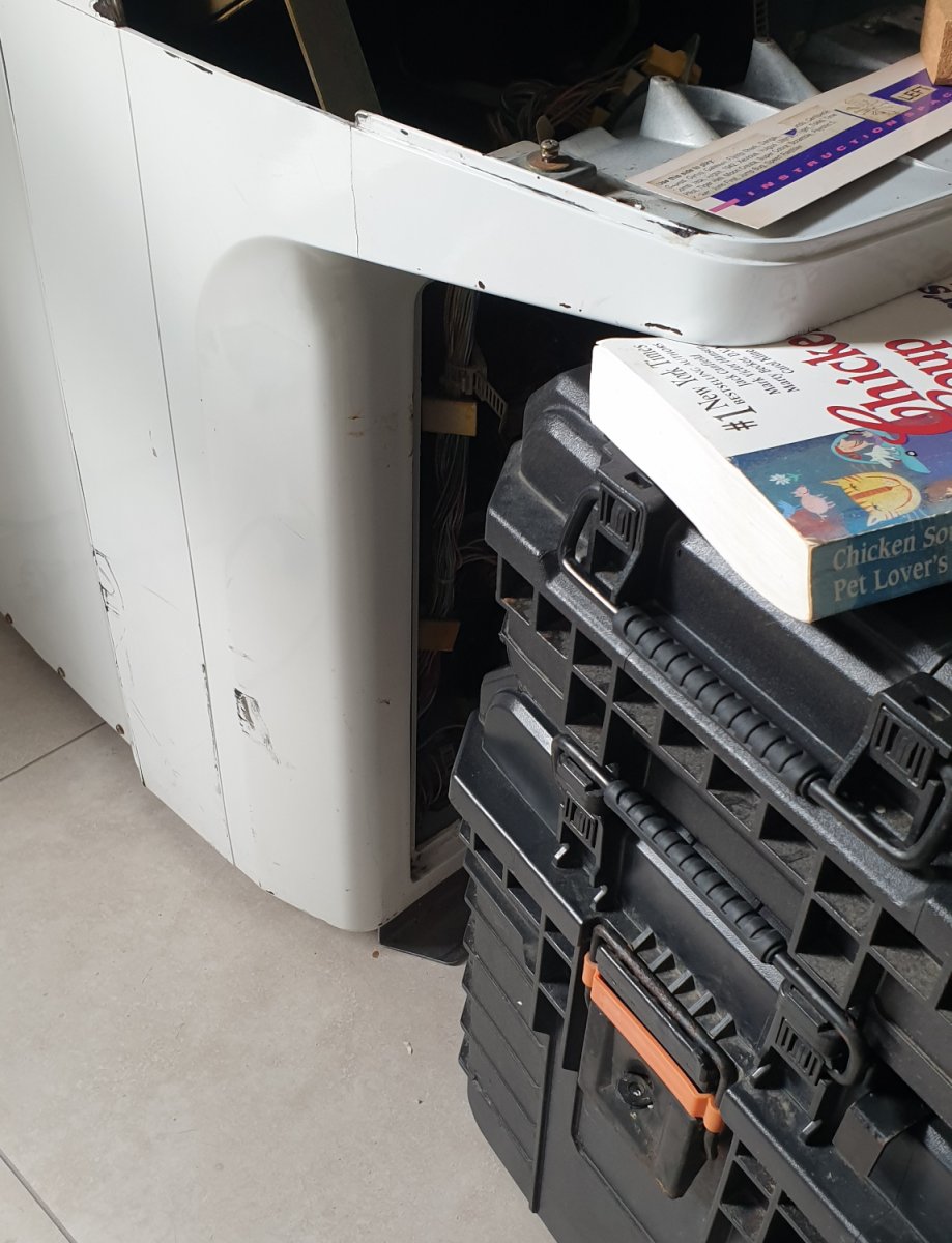

I superglued the two cracks on my Astro on each side but I Need some advise on how to approach this.
Just to note, each side has a metal plate reinforced with 2 bolts (eventually it did start to crack again).
On the right side there is a crack, but someone already applied fiber glass to it. Any ideas what I can do to reinforce it?
On the left side, no fiberglass reinforcement a deeper crack and a piece at the top was loose.
At this point the machine is in pretty pristine condition. Would Bondo/fiberglass the front be viable?

Bondo is filler, more than adhesive. Superglue is great adhesive but it's not going to hold this together with the kind of leverage you can expect. It will certainly crack again quickly if you don't reinforce it with something structural.
The fibreglass fix I did is still holding strong on my cab, with many hours of play and complete disregard to the crack when moving the machine, etc. It appears to be a strong, permanent fix.
My advice, based on my extensive done-it-one-time experience, is: fibreglass the inside of the crack, bondo the outside holes. Sand, paint.
* and use more fibreglass than that tiny-ass coin sized patch already on your machine. Way more.
