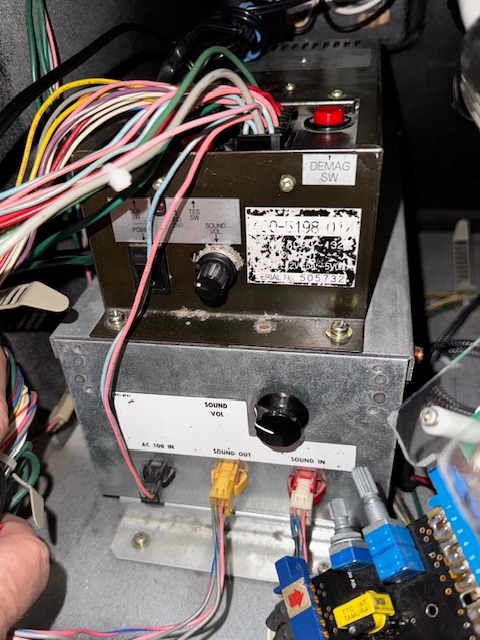

It goes to power the optional stereo amp that is installed under the PSU. Mine is a 400-5198-01 PSU and it’s installed like this:
