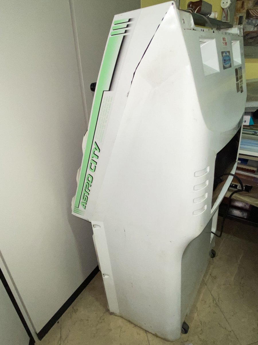

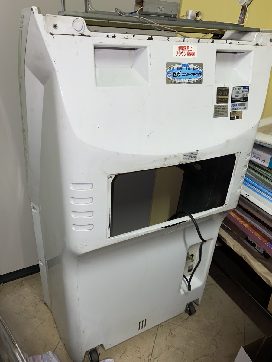

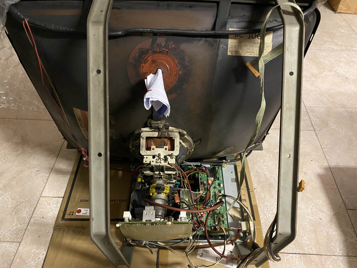

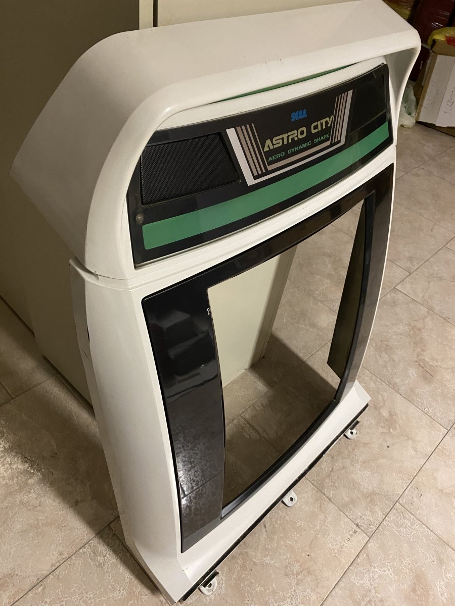

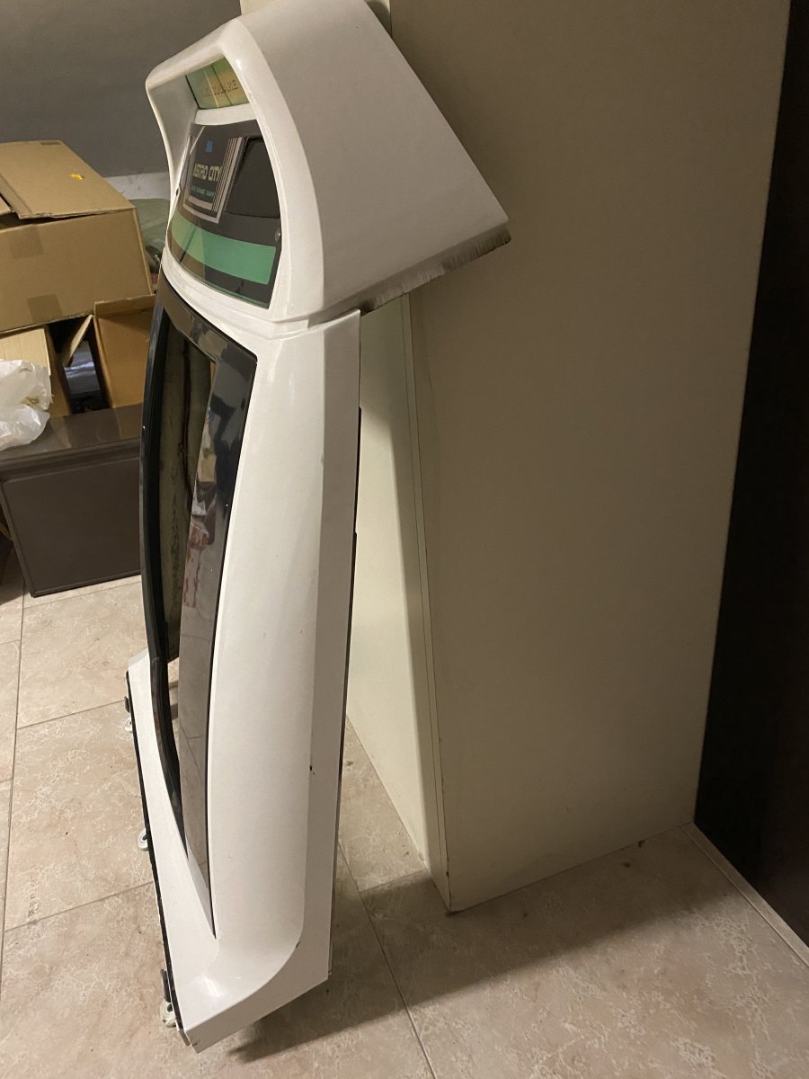

Here are a few of pics:
I still have have to remove the coin box (one screw is stuck), then I'll bring to my car shop all metal parts for derust\sanding\repainting.
I read all similar threads here and around the web, but it's my first restoration, so I'll still ask for some tips if you indulge me.
-Body: the glass fiber body parts are not in bad shape overall, would you still go the car shop? It sure would be better looking in the end, but wouldn't a proper restoration save the most it can? Original stickers and side art are quite good.

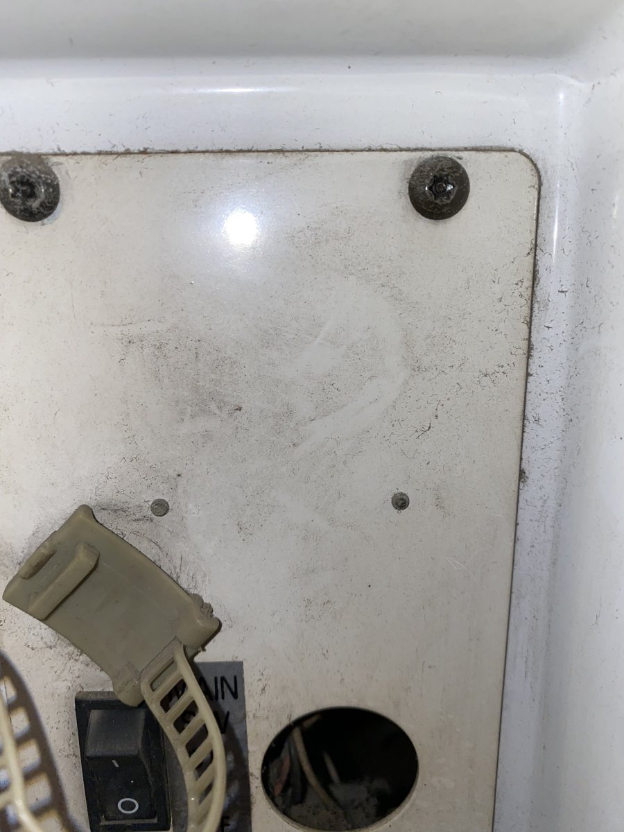

-Screws: What do I use to unscrew this?
-Recapping: everything seemed to work fine before disassembly; power supply and monitor chassis look clean with no caps bulging. I have a voltmeter: if everything checks ok, do you suggest to go with professional recapping for everything nonetheless?
-Conductive paint for the tube: should I do it? Where do I buy\how do I apply it?
