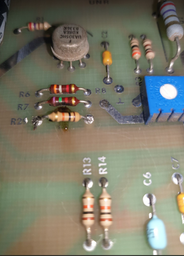

Thanks for taking the time to reply James, this has been a massive help. I found the power supply adjustment on the ARII as you said. When turned all the way down it goes to 8.4V, no further. I quickly tested the board with the lower voltage and we got a better boot rate from the board, but it would still garbble the graphics after a bit. So i think we are on the right track here & the most likely issue is a faulty resistor on the ARII. I have inspected the board and think i may have found the culprit.
Both resistors at R29 & R7 look compromised in my opinion. I will try to source both & replace & fingers crossed it fixes the issue. I only just picked this game up so i have no idea how long it had been getting run at 9V.... here is hoping that it hasn't damaged the board .

When we inspected the board we noticed some resistors that looked unhealthy & have replaced the resistors at R7 & R29. After we did this the 9 volt dropped down to 3.5V which was great, however the 10V went up to 12V. These were tested on the connector. We then tried to increase the Voltage using the adjustment on the board, but this is no longer altering the Voltage readings and appears to be non responsive. This was responsive prior to the resistor changes (but would only drop the 9V @ the 5V to 8.4V).
We also replaced the 2n3055 as you suggested. Unsure how to test if this was successful or not.
We then replaced a Capacitor @ C1 as this also had some burn rings in it that looked suss. This made no difference to any results

After re-checking the Resistors we swapped on the ARII, we realized where we stuffed up. We replaced the resistors using the PCB R7 & R29 components, not that of the ARII! We fortunately never plugged the PCB into the ARII after we did this - we have now swapped both over to the correct resistors and our voltage issues have been resolved.
