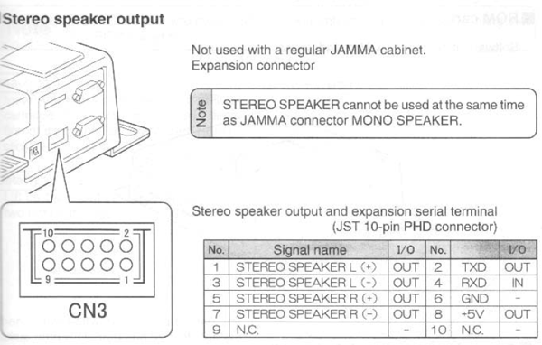

I'm looking for leads on how wire up a stereo cable for the Atomiswave or where to purchase one already made. Would prefer the latter option if at all possible, as I have no idea when I'll be able to get to what I'm assuming would be a small project to complete re: creation of this cable.
From memory it is a JST PHD connector, pinout is as follow;
6058edc6-720d-45a2-b70c-8c30d0a34c4a
Can't see what I'm assuming is a pinout image in the response but I did find this when I searched for the connector:
http://www.jst-mfg.com/product/detail_e.php?series=201
However not sure what exactly to expect if I order or which part is right one when I used the shopping link. I guess what I'm looking for would be the female end of the connector with wires installed? Does something like this exist?
Making your own cable is the way to go, however, I did buy one awhile back from an ebay seller, wangfu_fr. Real nice guy, it doesn't appear that he has any listed for sale but he makes them by hand and if you message him I am fairly certain that he will help you out.
