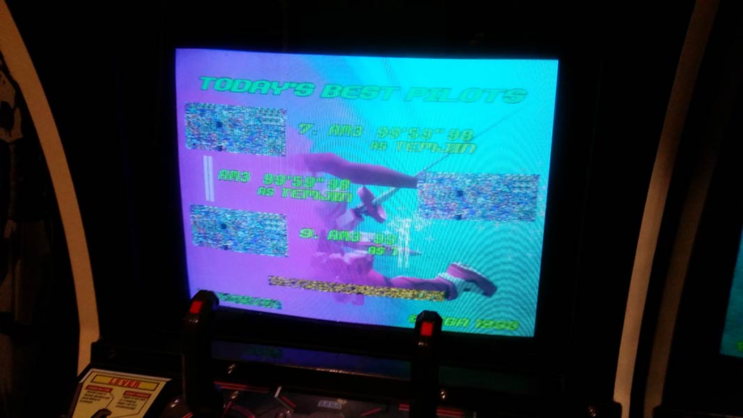

I bought another Model 3 VOOT PCB so that I can have a Live monitor setup.
I saw it running before it shipped and I know the seller personally so I'm confident it was working when it left.

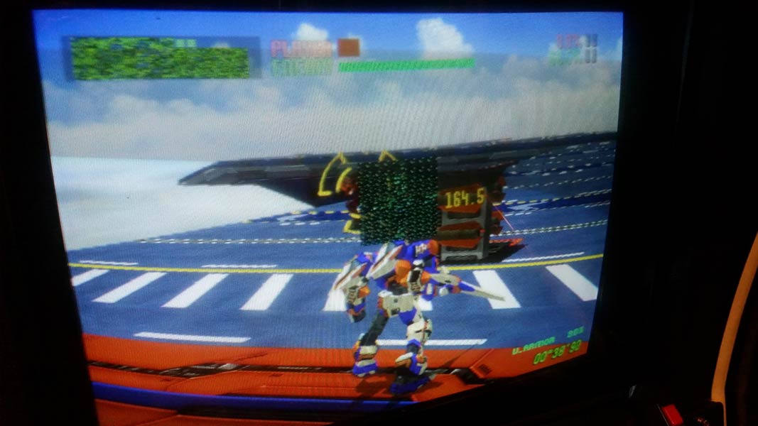

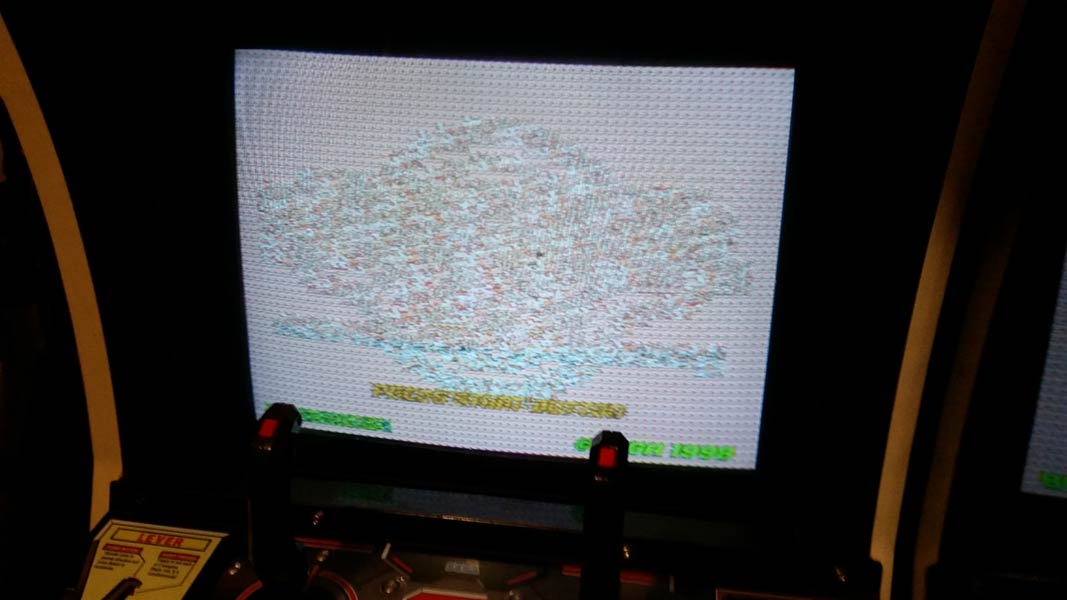

the game plays fine the roms all check OK but some of the 2D graphics come up garbled:
^this is the title screen where the logo should be
^That block in the middle is supposed to be my cross-hairs
I've seen pictures of VOOT boards displaying this behavior in listings in Japan so I'm going to guess this is a somewhat common Model 3 problem.
Anyone know what causes this and/or how to fix it?
